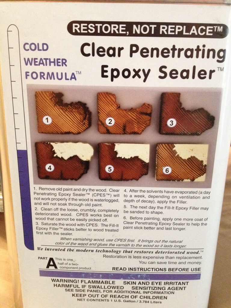

Postby tscarbroughdc » Sun Nov 17, 2013 11:01 am
Here is what I'm applying to my teardrop inside my garage around 60 degrees.
tscarbroughdc
Posts: 120
Joined: Thu Apr 25, 2013 6:37 pm
Re: CPES...Where to buy and how much?
Postby les45 » Sun Nov 17, 2013 12:06 pm
OK, that explains it. You should be good with the cold weather formula at 60 degrees. Here is a link to everything you need to know about applying your CPES:
