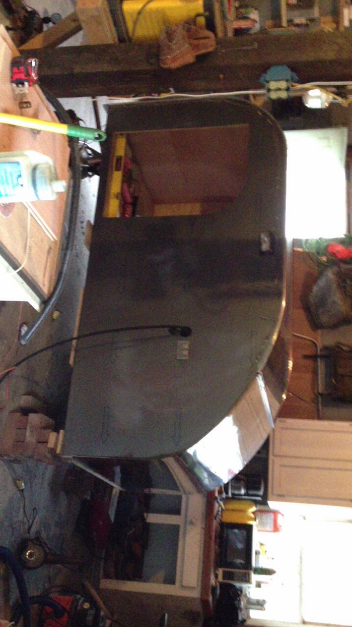

Postby backstrap bandit » Wed Jan 28, 2015 8:15 pm
Benroy galley walls 3/4 aluminum on gap is between 1/2 to 5/8 after reading another post I think I know where the screw up happened the notch was cut when walls were cut as per plans so roof ply increased it another 1/4 or 5/16

Postby backstrap bandit » Wed Jan 28, 2015 8:19 pm
That's the only pic I have of hatch shut at the moment I will take some better ones soon
