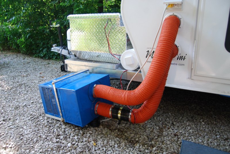

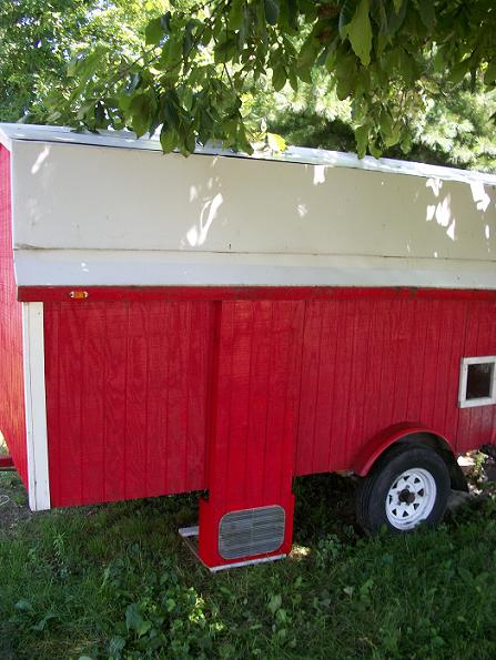

I place my air conditioner UNDER the camper in the shade and duct the cold air only into a duct I designed for that purpose however an open window will work also.
Re: Planning stages
Postby Wrenchbender » Fri Sep 18, 2015 8:42 am
I'm intrigued by your air conditioning system. Sounds like an easy retrofit for down the road. Can you post some pictures?

Re: Planning stages
Postby Wrenchbender » Fri Sep 18, 2015 8:52 am
bobhenry wrote:I place my air conditioner UNDER the camper in the shade and duct the cold air only into a duct I designed for that purpose however an open window will work also.
Interesting. I wonder if the AC unit could be ducted into a hose connected to a small opening instead of blocking a window for temporary installation/removal instead of your more permanent boxed in arrangement.
Wrenchbender
Posts: 12
Joined: Wed Sep 16, 2015 4:02 pm
Re: Planning stages
Postby bobhenry » Fri Sep 18, 2015 9:28 am
Yes they have.....
