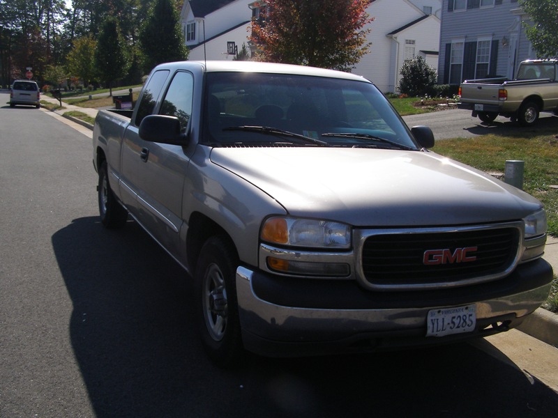

I just bought a 1999 GMC Sierra Extended Cab Pick-up truck...my son and I are going to share it....I've just had it with trying to borrow a truck when I need to go to the lumber yard...or haul trash....or load up some limbs that have fallen in the yard. Anyway it has 260,000 miles on the clock but it is in good shape for what we want...and the great thing is we only paid $500! I can't imagine we're going to drive it more that 1,000 miles a year, if that. Ok, so now the question.....the gas gauge does not work...it reads empty and the low fuel light is on....a couple of times, as I was driving home the gauge moved to half full (which is correct) and the light went out, but after 10 secs or so it went back to zero. The seller told me it hasn't worked for some time and they just fill it up and when they've driven 300 miles they fill it again...I've been looking on line at some products along with comments about problems with this model....seems like others have fuel guage problems and one person said he took care of it by "throwing in a couple bottles of CHEVRON TECHRON CONCENTRATE PLUS and that took care of it. I looked the product up online and sure enough it says it helps to clean and restore fuel guage readers...so I was wondering if anyone had first hand experience with this product? Thanks Philip
