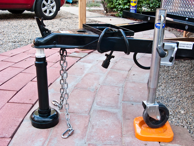

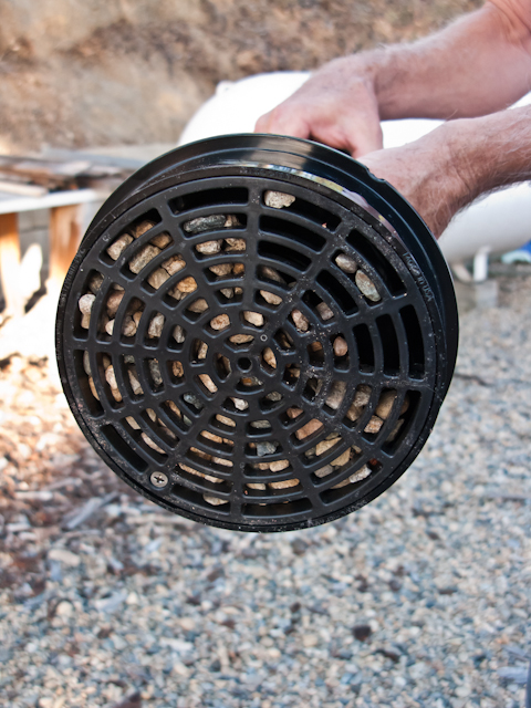

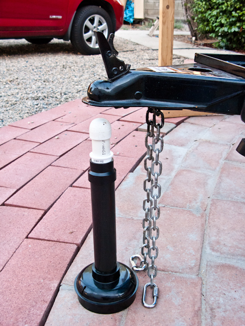

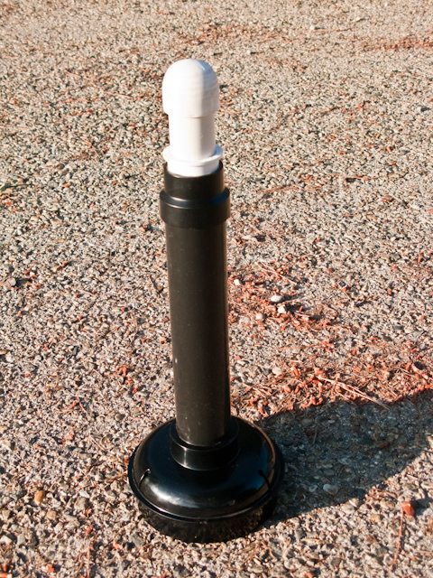

I made a lightweight tongue stand for our LG 6 Wide using plumbing parts. I strolled the Home Depot plumbing isle until all the parts came together. The base of the stand is a 'floor drain fixture', the center, a 2" ABS pipe cut to any length you require and not glued in. The top is a 2" PVC pipe cap ground to the shape of my 2" hitch ball.
It has taken all the weight I throw at it and it easily breaks down for storage! Just use your imagination and save your money for things you can't build :lol: .
You can weight the base with small rocks or gravel as pictured if desired.
Hope that helps and gives you some ideas,
