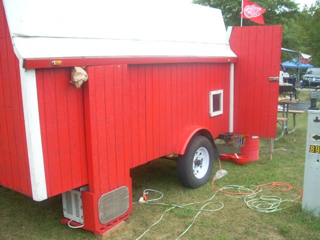

I tucked the barns AC unit in the shade under the trailer and
vented just the cold air discharge into the barn under the
soffet thru a vent via a chase. It works very well but is not
as easy to set up as just flipping a switch.
