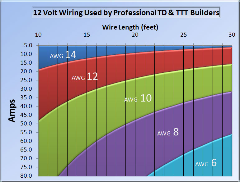

Postby Joe G » Sun May 04, 2008 11:13 pm
Great thread! :thumbsup:
I made a few wire gauge charts to use at work, and thought I'd post them for the benefit of everyone here as well.
I wire 8-10 old cars per year complete from scratch, and created these charts as a quick reference for choosing proper wire sizes.
Revised 5/7/08:
The main objective of this post was to illustrate how the length of a wire effects it's amp carrying capacity.
It has been brought to my attention that tiny RV's have more stringent electrical efficiency requirements than automobiles do, so it is a good idea to use heavier wire in your trailer than what you might find in your car.
Below is a revised wire chart that reflects the recommendations of professional TD&TTT builders:
(end of revision)
The following charts show the minimum wire gauge sizes required to meet two different maximum voltage drop requirements at 12 volts.
The first is for 10% voltage drop - the industry accepted standard for modern cars. I consider this the bare minimum for safety.
10 Percent Voltage Drop Chart
Personally, I prefer a larger safety margin, so I use the 5% standard shown in the second chart. My mentor in auto wiring thinks this is excessive, but I like to think of it as cheap insurance. In rare cases I even use a 2% standard for some electronic devices, but that's just total overkill for most applications.
5 Percent Voltage Drop Chart
Planning out your electrical system and making sure it's components are rated for the demands placed on them will help ensure that the electrical system will provide you with years of safe and trouble free service.
Anyway, I hope someone out there finds this useful.

Postby brian_bp » Mon May 05, 2008 1:54 pm
Joe G wrote:...I made a few wire gauge charts to use at work, and thought I'd post them for the benefit of everyone here as well.
I wire 8-10 old cars per year complete from scratch, and created these charts as a quick reference for choosing proper wire sizes...
Nice charts! :applause:
Joe G wrote:...The charts show the minimum wire gauge sizes required to meet two different maximum voltage drop requirements at 12 volts.
The first is for 10% voltage drop - the industry accepted standard for modern cars...
This nicely illustrates the voltage drop problem. While it was pointed out earlier that cars often use quite small wire compared to what some of us might choose, in that application they care very little about voltage drop, because electrical efficiency isn't very important.
In a car, the battery is used for very short-term energy storage (as the regulator cycles the alternator output on and off, and demand surges and wanes), and longer-term to store just enough to crank the engine (about one amp-hour for an easy start). The alternator is there as endless supply of more electrical energy.
In a battery-operated installation such as an RV, if you 10% voltage drop in the wire, then 10% of your battery energy is being wasted in heat in the wire. Larger gauge wire to stretch battery endurance - within reason - can be a good tradeoff.
10% of 12V is 1.2 volts... which is significant. In a trailer, the 5% guideline seems much more appropriate to me.
Also remember, these charts address only voltage loss, not the temperature which results for the heat generated by losing that voltage to resistance. Hot wire buried in a wall seems like a bad thing to me.
