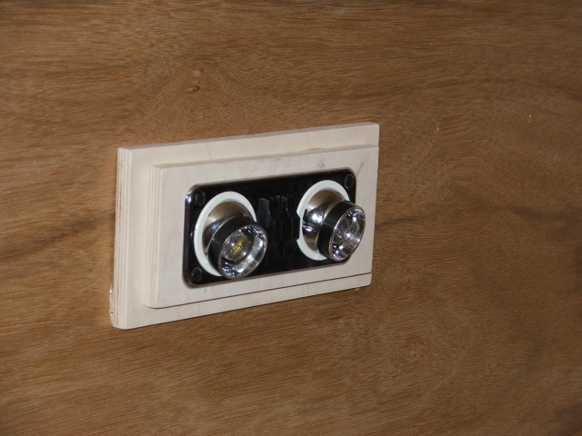

Postby bledsoe3 » Sat Nov 18, 2006 9:55 am
I built mine out using matching wood from my cabinets.

Postby Tripmaker » Sat Nov 18, 2006 7:25 pm
Sonetpro...that's what I planned to do but is the heat traped in there a problem?
bledsoe...that looks good but isn't the heat still trapped behind the lights? Maybe what seems hot to me by touch isn't enough to worry about.
