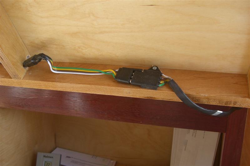

Postby boomboomtulum » Sun Aug 17, 2008 10:15 pm
This is all I did. Then I covered it with a small 1/8 ply. sheet w/ 4 small brass screws. cover is 5x13. I'm glad I put this in I have had to remove hatch once so far.
Click on the link below and in the bottom right corner of the hatch you'll see the small ply. cover.
http://www.mikenchell.com/forums/album_ ... c_id=37109
Have'nt been everywhere yet, but it's on my list.

boomboomtulum wrote:This is all I did. Then I covered it with a small 1/8 ply. sheet w/ 4 small brass screws. cover is 5x13. I'm glad I put this in I have had to remove hatch once so far.
where did you get the plug with the screw mount hole? im really digging that!

Postby boomboomtulum » Mon Aug 18, 2008 11:34 am
Walmart I believe, during the build gathered all sorts of stuff but I think that is where I got it, or was it Tractor Supply Company? :thinking:
