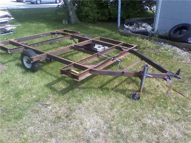

I recently purchased a Coleman Redwood pop-up because the $100 price tag was too good to pass up and I have been wanting to start a TD build.
I removed the camper and the leftover frame is 6'3" wide by 7' long and when I had it weighed to put plates on it, it came in at 350lbs :shock: The camper floor is still on the trailer and it appears to be a somewhat wet piece of 3/4" pressed wood, so I am sure that adds some weight to it. I do want to extend the trailer to 8' or possibly 9'. My concern is my tow vehicle has a 1500lb towing capacity and I don't want to exceed it. I would like to build a tear with insulated walls, an A/C unit, etc... My question is, do any of you experienced builders think this frame is too heavy to start out with? The centerline of the axle is about 35" from the rear of the trailer, so I was thinking of adding the additional 1' (if I go for 8' total length) to the forward part of the trailer and then extending the tongue to give more clearance and strengthen it up. The wheels will most likely be covered by the body of the tear as they positioned inside the outside rail of the frame. I will probably do a cutout and a minor flare for character.
So basically I would like to hear some thoughts on the starting weight and the ideas of adding length to the trailer, keeping in mind my 1500lb towing capacity. Ideally, I would like to end up with a TD that weight no more than 1200 lbs.
Here are some shots of the trailer:

Hi , I used an old popup that looks a lot like yours. I stripped the floor off & cleaned & painted the frame, I reused the floor as it was a full 1 inch plywood in great shape. The one thing I did that I wish I had not was I cut the floor down to 48 inches wide so the wheels were on the outside of the body. I wish I had made it 5 feet wide instead. I used the full length it is 12feet long, I have lots of storage that way. I cut the steel frame down to 48 inches to. I am happy with my TD as it is only me that goes camping. I have it for sale right now as I want to build a weekender. Good luck with your build! :thumbsup: :applause:
Check out my album pics! ;)

Get a cut off wheel and a little grinder or the sawsall and lose the popup crank and channel piece it runs in. Removal of the intermediate floor supports would give you the option for under the floor storage. I would rely on your new wood frame to cantaliever 1 foot front and back now making you 6x9. 1x4 framing and a 1/4" exterior and interion skin and you will have little trouble staying within your weight goal.
Boodro might be right in that if you want old school tear 10 cuts and you have a wheels out frame. Warm up the sawsall and stock up on metal cutting blades its surgery time.
Yes, I had every intention of removing the crank. Removal or relocation of at least one of the floor supports was planned as I want to do the recessed floor/pop-up table option. What dimension of floor framing do you feel would support the cantilever of 1 foot on either end of the frame? It's an interesting idea, but I am not sure I could rest easy knowing I did it that way :thinking:

Yes.
It's almost shocking to discover how strong a plywood box can be... and how little chassis a teardrop really needs.
Unless the trailer floor needs to support the walking weight of many people, it can be simply 3/4 ply on top of a torsion axle tube welded to a single steel hitch tongue.
An oversimplification? One might think so, but, not really.

Yes, I realize the frame that I have picked may be overkill, but my question really was can I build the TD with that as a starting point and realistically stay within my tow vehicles capabilities. I tend to do things in an overkill fashion....call it OCD or whatever, and I will have peace of mind knowing it will be well supported. I will have to be realistic when building and keep in mind that as I stated above, it won't need to be built like a sherman tank.

Yes, you can build your TD with that trailer as your starting point and stay within your tv's capabilities... if you remove at least 50% of the steel on that thing. :-)~
I've learned here that, pound for pound, plywood is stronger than steel, and that when any sheet material (plywood, aluminum, carbon fibre cloth, etc) is constructed in what's known as a 'monocoque', or, unitbody, then a frame becomes almost a redundancy... almost... and again, especially if a bunch of people are not literally walking or standing on the teardrop's floor. As Bob has mentioned, the sides of the teardrop will support your galley floor around the floor's edges, for example, and that the floor only needs, if anything, a support somewhere in the middle of it's expanse... The bulkhead between the galley and the cabin also greatly aids with vertical support of the floor.
NismoGriff
Again.....I am not clear on home something sitting on top of something can "support" what it's sitting on.
Yeah. I was wondering about how that came out. Hahaha... Think of it this way (and remember, a wood joint glued together is stronger than the wood around it)...
Where the trailer chassis may provide lateral or longitudinal support of the floor in compression, that "bulkhead" by virtue of it's being bonded to the tear's sidewalls support the floor (that it is glued to) in tension, much like, say, a suspension bridge.
That's enough for now, save to say that the teardrop, when made of decent-quality plywood becomes a structure unto itself, and is very strong in beam and torsion. Perhaps our resident engineer Andrew will chime in with an educated explanation.
As Bob Henry said earlier, "It is the sum of all parts not just any one [part]".

The mechanism that puts the pop up is surprisingly heavy. Does it have brakes? Mine does, remember these were built to tow behind a small car. As for the floor you will not stand on it, once built your weight will be put on the floor through a mattress. Think light. My other tear has 3/8 ply on top, 1by ripped to 1.5 wide standing on its end, and 1/8 ply on the bottom. Still holding up fine, with close to 20,000 miles on it. Next time I would use 1/4 ply on top.
