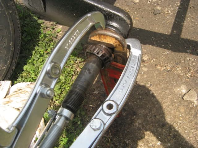

Can't quiet tell from the picture, does the spindle have a step in it or is that a sleeve? Some spindles have a replaceable sleeve on them. You might have to resort to profesionals to get it off though.

Postby BillZ » Wed May 26, 2010 2:19 pm
Well, I went to Harbor Freight and at one point had a grinder in one hand and a bearing/gear puller in the other. I opted with the puller, figuring that it is something handy for the trailer's tool box in case I had a bearing issue on the road. It turned out to be the wrong choice.
When I tried it, another problem came to light. The bearing backs up to a step in the spindle resulting in only about 3/16" of the back of the bearing to grab onto. The hooks on the puller are rounded and chromed and they slip off as soon as I start cranking on the nut.
So, I thought about putting my heavy duty pipe wrench around the back of the bearing and hooking the puller to the wrench...
It got much tighter than I could get it before, so much so that I had to put a pipe on my wrench handle for extra leverage. I cranked on it with all my strength before the puller post bent and the claws slipped off.
Needless to say, I need to calm down and find something else to do for a few hours before I take this @#$ trailer and dump it in the river!
BillZ
Posts: 308
Joined: Tue Feb 16, 2010 7:39 pm
Location: College Park, Maryland
Postby teardrop_focus » Wed May 26, 2010 2:46 pm
Late to the thread here...
In the pic above, is it the bearing's inner race that's glued (sic) to the spindle?
In that case then cut a couple of v-grooves into the race approx 180 degrees apart, almost to the spindle but not quite; then take a chisel and crack that puppy off o' there...
:hammer:

Postby BillZ » Wed May 26, 2010 7:34 pm
teardrop_focus wrote:Late to the thread here...
:hammer:
That is going to be my next approach. I remembered a neighbor that works on cars and asked him if I could borrow his grinder. He was happy to lend it to me.
