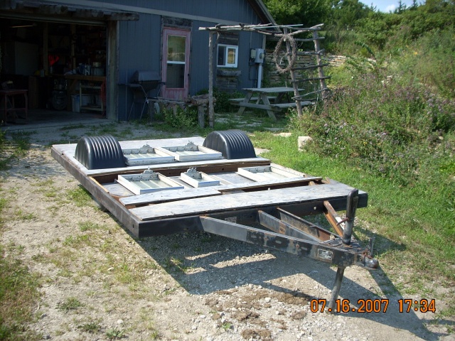

Postby 2old2tent » Thu Dec 27, 2007 8:45 pm
Mine is on an older Starcraft, probably early '70's. The outside dimensions of the frame were 6'-3" wide by 9'-10" long.
It wasn't very hard to remove everything that looks like a pop-up once I made the decision to go TTT.
Jack
PS: My frame was exposed all the way around so measurements were easy to get before hand.
