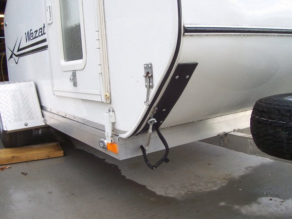

I've got a harbor freight frame with the skinny 12" inch tires, a few boat trailers with the skinny 8" tires and a 6' x 8" trailer with full 15" rim tires. The utility has no springs and when its empty I have to run the tires at about 18 psi to keep it from going air borne on a bumpy road. I know the feeling with the small skinny tires. They can get very bouncy and skittish.
This pic was not intended to show the tires I have on wazat but its the best I have to show them. They are 8" but are much wider than the normal 8" wheels. I was very impressed at how they handled. The extra width made it handle like full sized tires. I am well aware that the bearings will need more attention than with normal sized tires, but I really like how low to the ground it sets the trailer and still handles great.
