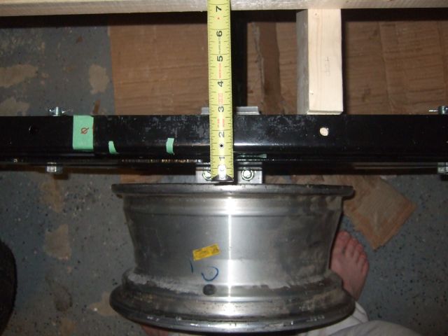

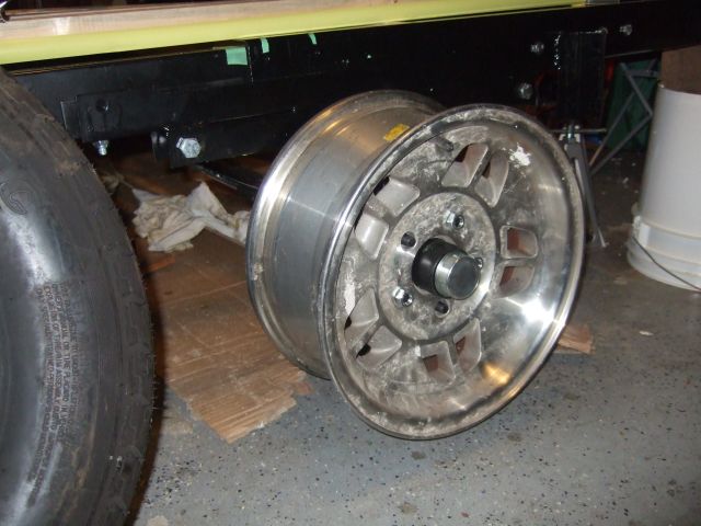

Postby Sparksalot » Wed Apr 01, 2009 7:45 pm
I had one spiffy Ford Ranger wheel, and was prepared to buy a mate. BUT The offest nixed that.:cry:

Postby Alphacarina » Thu Apr 02, 2009 5:41 pm
A set of 1, 1.5 or 2 inch spacers from eBay would make those Ranger wheels fit just fine . . .
With 40 mm import FWD wheels you'll likely need some spacers for sure. I have a set of 1.5 inch ones on my Harbor Freight trailer which is sporting alloy wheels
