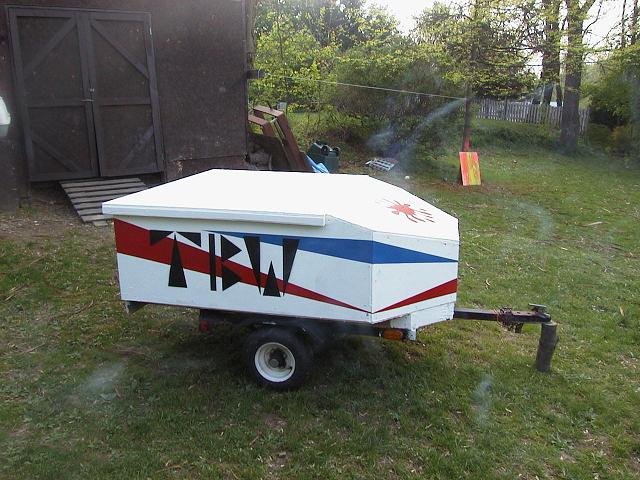

Larwyn wrote:I had a bit of problem with the supplied bolts breaking during assembly so ended up replacing them all with grade 8 hardware from TSC as well as welding all the cross members in place.
