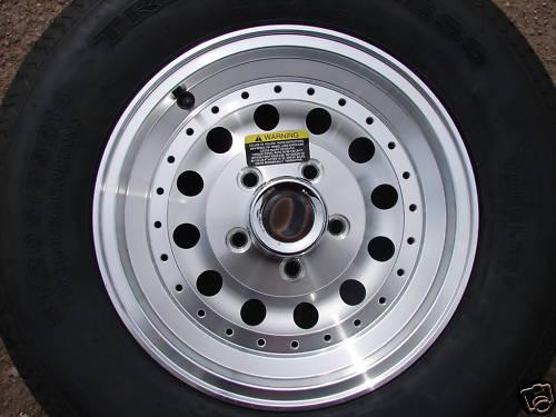

Wondering if anyone has purchased this wheel and tire set and how you liked them? They are $110.00 for the wheel and tire combo with free shipping which seems to be a good deal. Also was curious if the company is easy to deal with if there is a problem.

No I have not used them. But that seems like a great price. You get an aluminum wheel, so light weight and no rust, plus it looks good! Free shipping and no sales tax (for know). The guy has good feedback. Make sure the bolt pattern and backspacing will work for you.

Make sure the [wheel lug stud] bolt pattern and [wheel] backspacing will work for you.
Two very important points!
I've found, however, that the most popular axle suppliers (Dexter and UFC Flexiride) will offer their 5- lug options in a "5 on 4.5" which is the Ford passenger car (and very light truck) wheel lug bolt circle. The only thing to physically double-check is to measure your configuration for the necessary wheel backspacing.

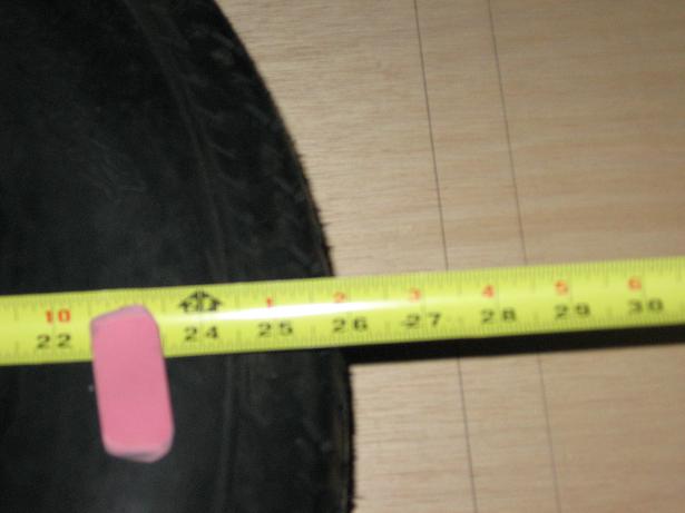

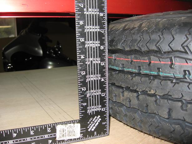

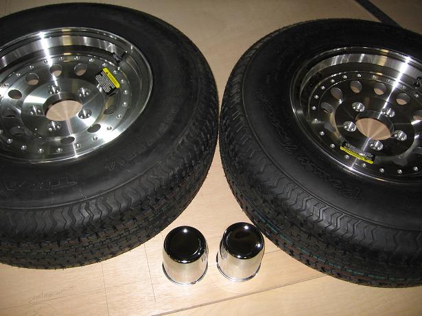

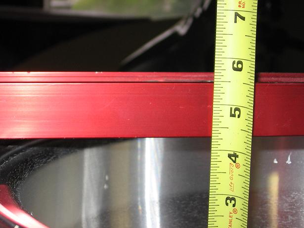

I received the wheels and tires today. They are nice and should work out well. They came with the metal center caps too. The lug nuts did not come with them. I did some measurements for anyone interested in buying these. Here is the description of what they are. 14 INCH 5X4.5 BOLT PATTERN ALUMINUM MOD WHEEL AND TRAIL EXPRESS ST205/75R14 TIRE from a company called Wheel Express, The back spacing is 4-1/4", tire width is 8", and the tire diameter is 26"
