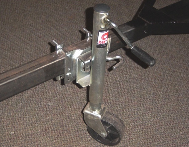

Does anyone know of a shorter frame mount jack with wheel?

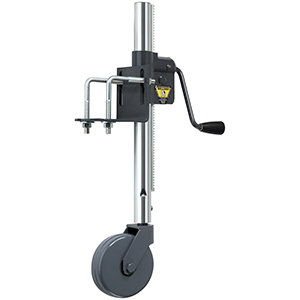

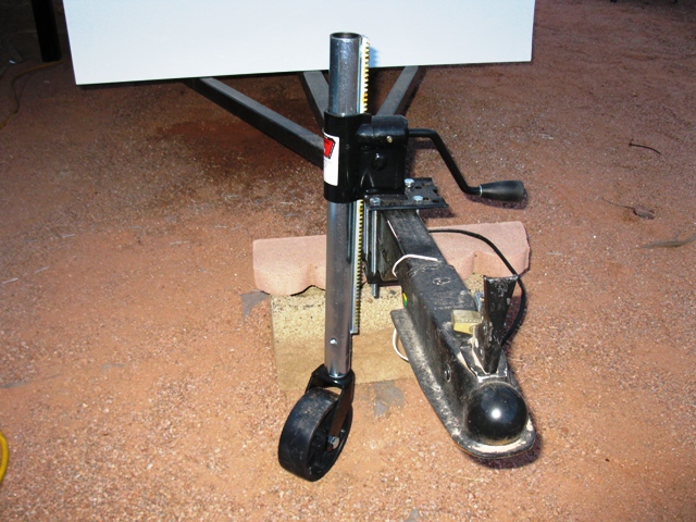

I have started using these Bulldog jacks because of the rack system they crank all the way up, and the wheel still comes off. Not cheap - $80, they they work great
http://www.bulldogproducts.net/content/products.aspx?lvl=2&parentid=7500&catID=7600&part=0
prohandyman wrote:Here a pic of the bolt-on version
tinksdad wrote:A note from personal experience..... if anybody uses the HF jack from the OP, I would highly recommend adding some kind of set screw (or other suitable fastener) to the cap at the top of the crank tube. Mine vibrated loose somewhere on it's second trip out. Still haven't found anything to replace it with.
