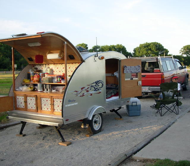

Here's a pic of mine that is 5'x9' by 5' tall on a 4x8 frame. I used 1/2 Baltic Birch with 2x2 framing just as you described. I don't have that many miles on it yet, but, it seems to be holding up just fine. I put 8" of the overhang on the rear.
Good Luck,
Mike

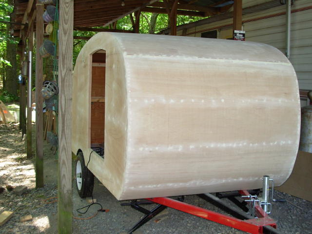

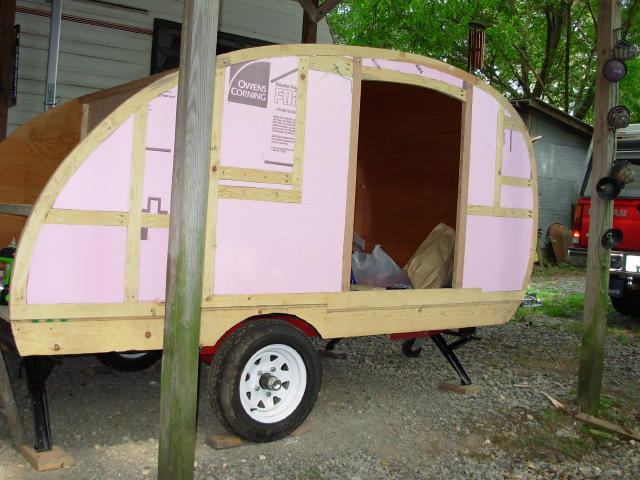

Postby starleen2 » Sat Jul 23, 2011 11:50 am
How about 14" (each side of overhang with no support on the over hang with 5/8 plywood for a floor? Remember that the walls act as supporting beams on the sides and keep it from sagging down. No need for a supporting structure underneath the overhang if the plywood is thick enough
From the green lantern build:
