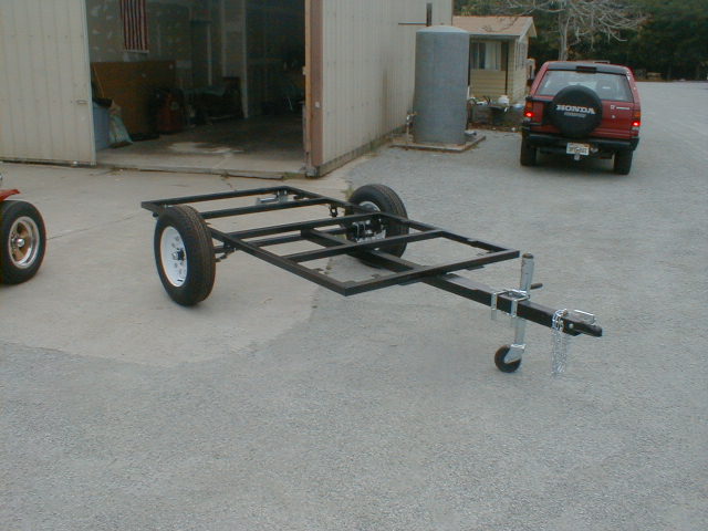

The 4'x8' bunny hauler was made with 2x2x16ga box tube. I bent up some 16ga C section cross members were I didn't have the box tube going across. (16" OC) I did use some 11ga plate reinforcements on the sides of the tube at a couple of joints.
The one caveat I would mention is that I built the floor and frame together with a glue/screw cleat for the walls. The walls get glued to the cleat, and the whole thing becomes one unit, like a unibody car. Frame without trailing arm suspension, wheels, hubs was only 60lbs. I was going for light weight.
I couldn't haul 1,000lbs on the bare trailer frame, but thats not what it was designed for. Once the body was on, I've hauled 1/4 ton of feed in it, without any flexing of the body/frame.

...that is what I would do...build the whole trailer outta the lightweight stuff...use the 1/4 stuff only for the tongue......
