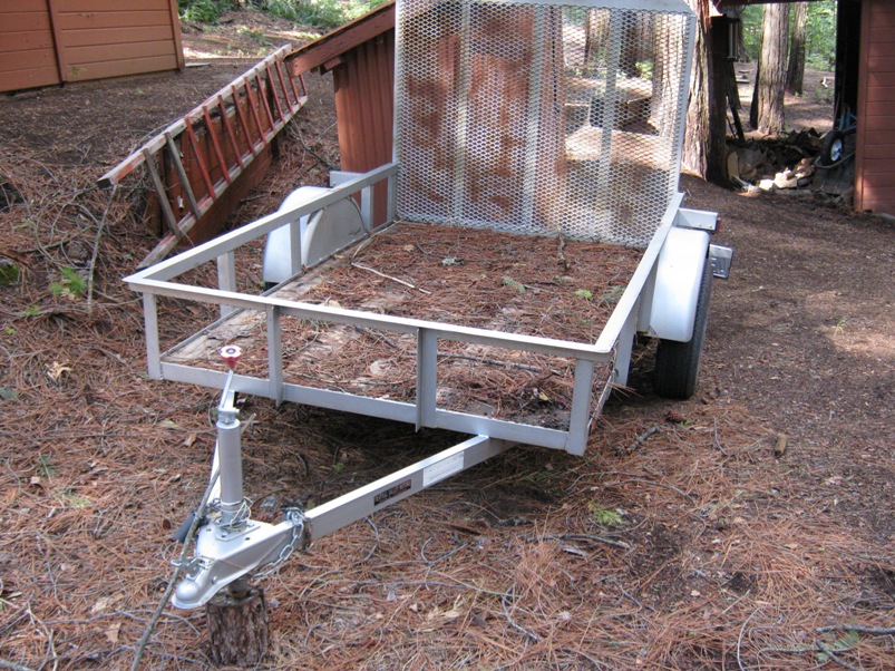

Here is a shot of the axle..

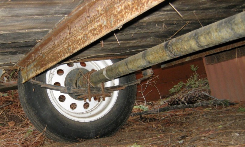

Now, is the the type of axle I can "Spring Over?" I would like to just unbolt it, rotate the axle so the perches are up and rebolt it to the bottom of the springs.. Yes? No? help a newb out

StormRider wrote:At a minimum, replace the u-bolts. Seeing the rust on the threads, it'll go a lot faster if you cut the bolts anyway.
You should also strongly consider having spring perches welded to the top of the axle, as most axles have a slight upward bow in them, so they are straight under full rated load. If you simply rotate the axle, the bow will point down, and get worse under load, possibly leading to poor tire wear.
This is also a great time to add shocks, either using a u-bolt plate that has a shock mount, or having tabs welded to the axle.

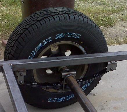

PaulC wrote:They must build axles differently up there, especially the round type pictured, as all of ours a perfectly straight.

Could you do me a quick favor?
What is the distance between the top of the axle to your frame. Well the top of the axle mount on the top of your axle to the frame?
I am trying to determine what travel you have
