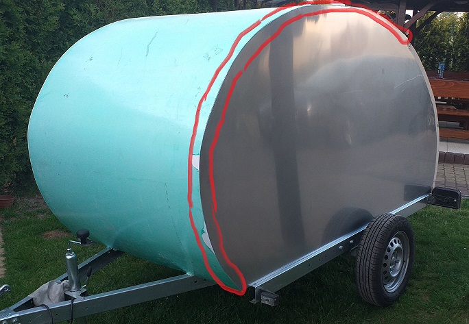

I don't know how to finish folding walls with a roof, maybe someone has an idea. In Poland, there are no angles to bend

I don't know how to finish folding the walls with a roof. Someone has an idea. greetings

Postby Krzysztofpat » Mon Jun 08, 2020 9:18 am
What finish to use, marked on the picture.

Postby OP827 » Tue Jun 09, 2020 8:51 pm
I think it is called insert roof edge molding . It is usually made of softer aluminium that can bend along the roof curve. Try searching it in your area or from online suppliers.

Postby Krzysztofpat » Wed Jun 10, 2020 9:36 am
Thank you for your answer. I found something like this in a trailer store, will it bend in an arc?

Postby OP827 » Wed Jun 10, 2020 5:56 pm
Krzysztofpat wrote:Thank you for your answer. I found something like this in a trailer store, will it bend in an arc?
Unfortunately I do not have a "fit-all" answer to your question. You will have to ask the store staff, generally it depends how soft the material is and how high is the edge that is resisting in the direction of the arch bend. Many aluminium alloys can also be annealed or softened by heating them, but you have to know what you are doing from the alloy composition properties perspective.

Postby Krzysztofpat » Sun Jun 21, 2020 11:47 am
Thank you for your help, I bought a slat and according to the angle bending tool from the forum I succeeded. Regards

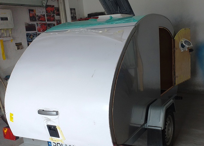

Re: Hello from Poland
Postby Krzysztofpat » Fri Jul 17, 2020 4:45 pm
trailer ready for vacation
