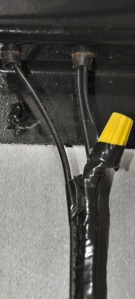

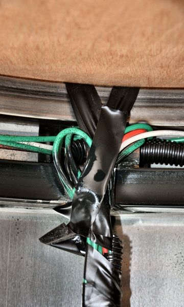

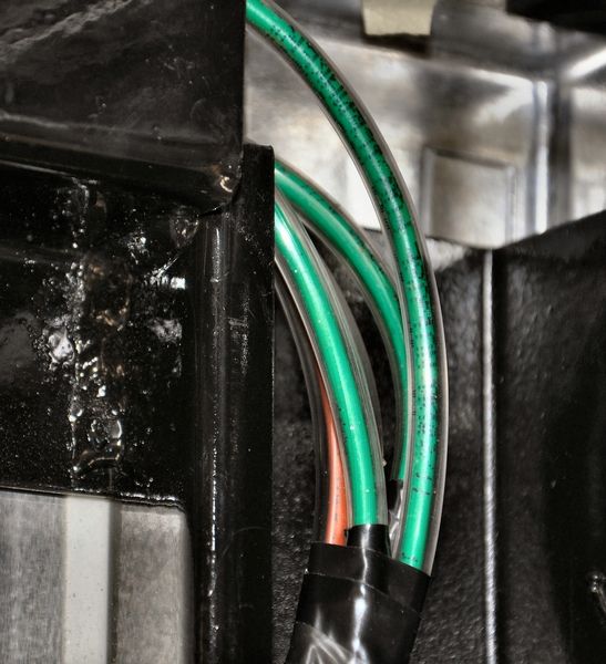

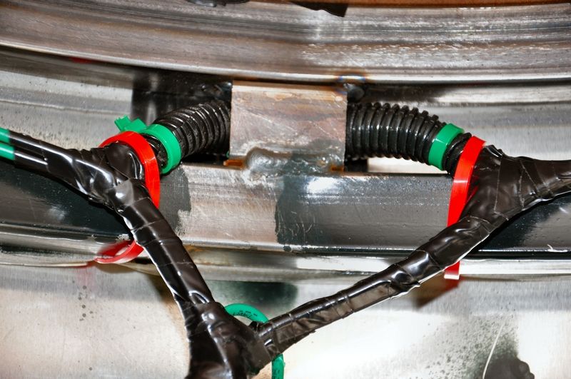

Today I spent a couple of hours cleaning up and fixing the factory wiring. I also got most of my rough-in wiring run started and should have that finished tomorrow am. I will also go pick up the insulation tomorrow and start on that. If all goes well, my plan is to have trailer somewhat usable for the May long weekend which is 8 weeks away...
The factory wiring in this trailer and many others I looked at while researching before purchasing, leaves room for improvement. The main wiring loom here at the front of trailer is a good (bad example). As you can see, the wiring is being pulled against and down from the small section of steel channel which would of rubbed a hole through the wiring in a very short time.
I relocated the wiring away from the channel, separated it and also fixed up the wire loom so that wires in there are better protected. As you can see, I still need to wire wheel out the surface rust and spray with some Tremclad Rust paint.

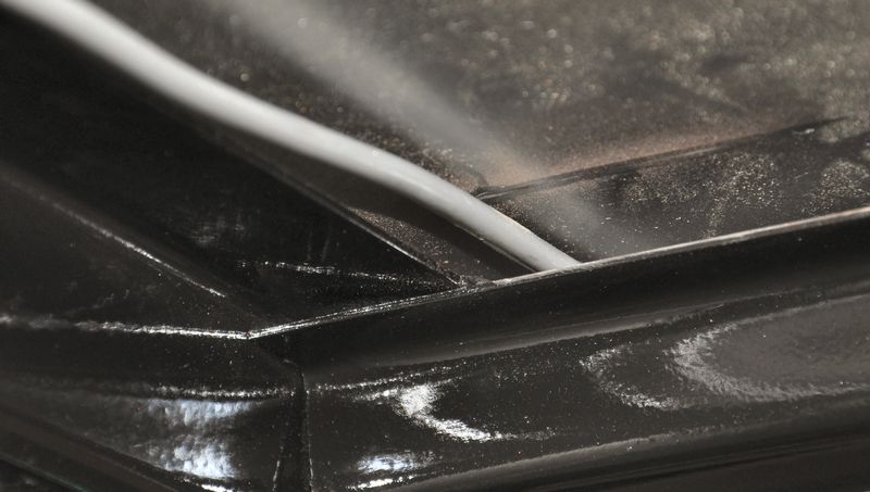

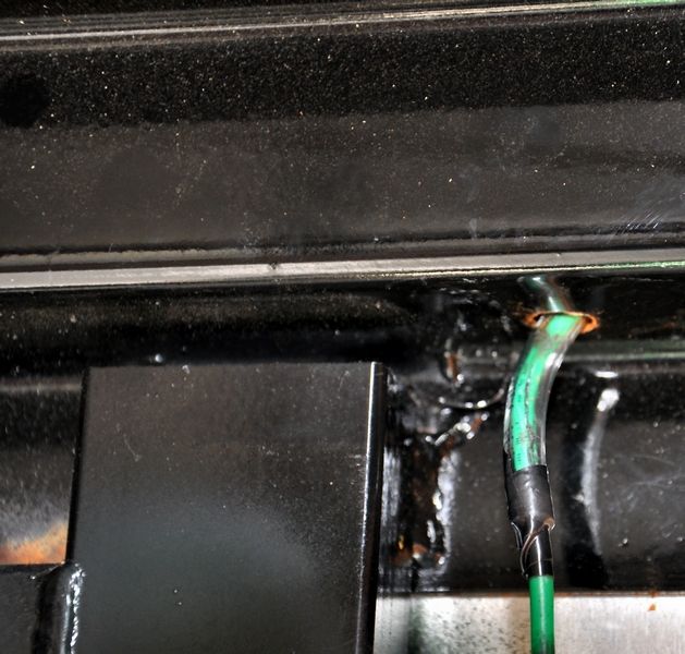

This run of wire did not have a grommet and it would of been a work to pull the wire. I used a short length of clear tube in which 14 gauge wire fits perfectly to help protect against any rubbing from the steel which I checked and there are no sharp edges etc on it.

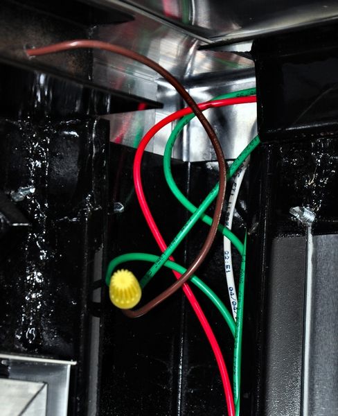

The wiring in both back corners of trailer were also in need of attention. Notice the brown wire and where it exits that sharp edged hole? I pulled the wire out and re-routed it in behind the steel channel.
I took the Dremel to the steel channel edges but I was not completely confident that this alone was enough so I disassembled all the wiring connections then again, used clear tubing to further protect the wires.

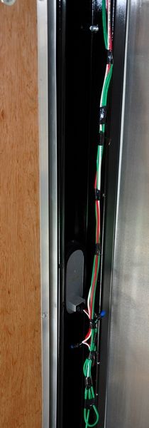

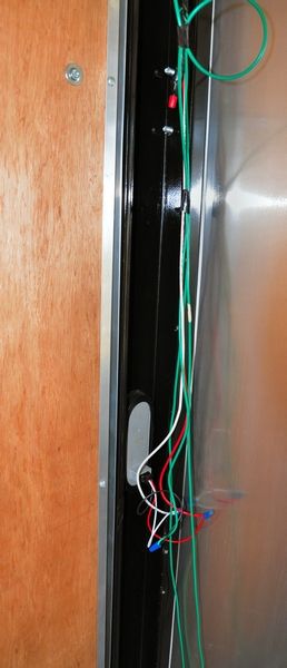

My dilemma of running wires through all the wall studs have been solved. I noticed today that the roof supports taper down and away from the roof as they junction at the side walls. I surmise that with this trailer being flat roofed, they use the same roof supports for the rounded edge roofs which would explain the gap there which is perfect for the wiring. The photo looks a bit deceiving as the gap is enough that I can put my index finger in it. I also used the Dremel to ensure there were no sharp edges on any of the supports. Tomorrow, the wires will get a few wraps of thick insulating tape which will ensure that there will be no way for the wires to be rubbed through, especially this wire that is already encased as it is.

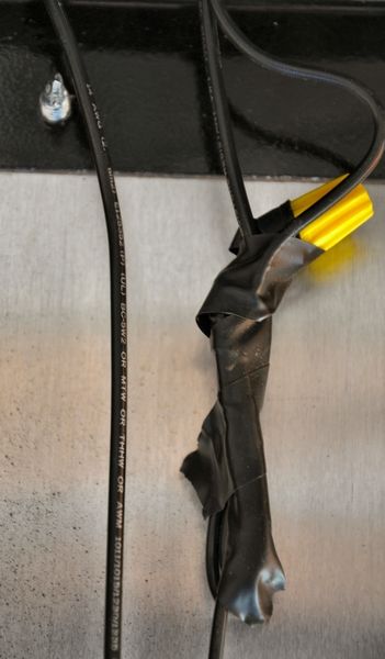

Another issue. That protruding screw is very close to the wire and I don't like not knowing the condition of the wire under that poor tape job...
I also removed, inspected then re-wrapped the wiring here as I did on all other wires today. At this point, I am much more confident knowing that the factory interior wiring is now all inspected and fixed where needed.

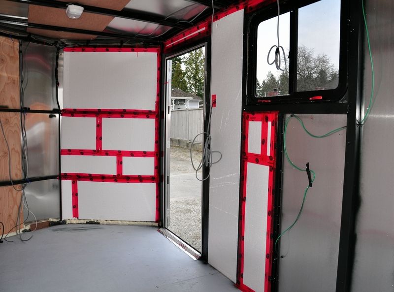

More progress today.

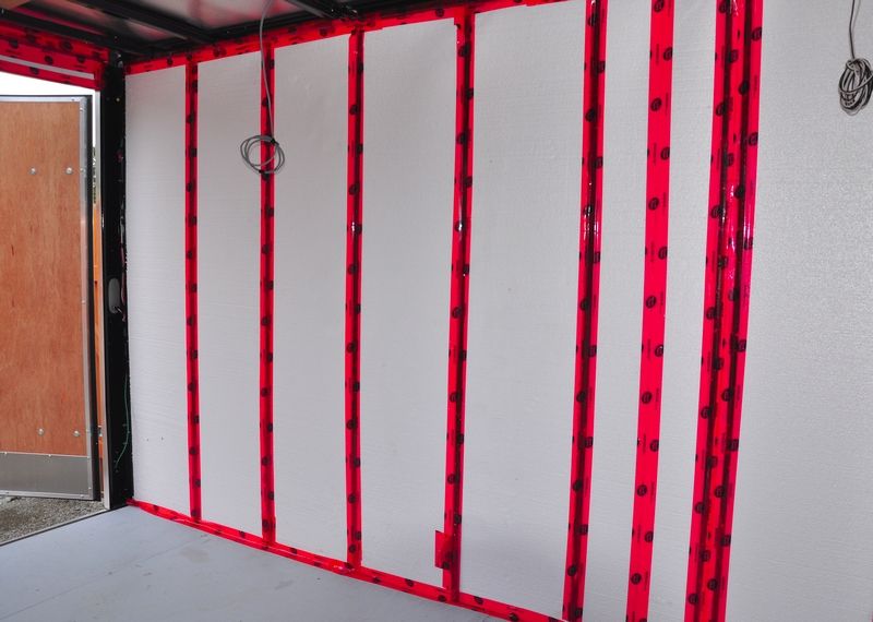

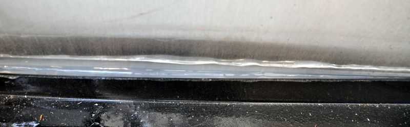

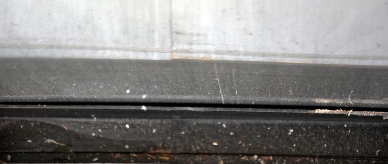

Started off by checking the side wall panels between the wall suds and where they meet the floor. As you can see in this photo, there is bit of gap that will allow cold air and and also, possibly allow moisture in.
Even though it is not a big deal, sometimes my attention to detail can work against me. I ended up sealing every single panel with silicone whether they really needed it or not. This will now make the bottom of the trailer, air and water tight.

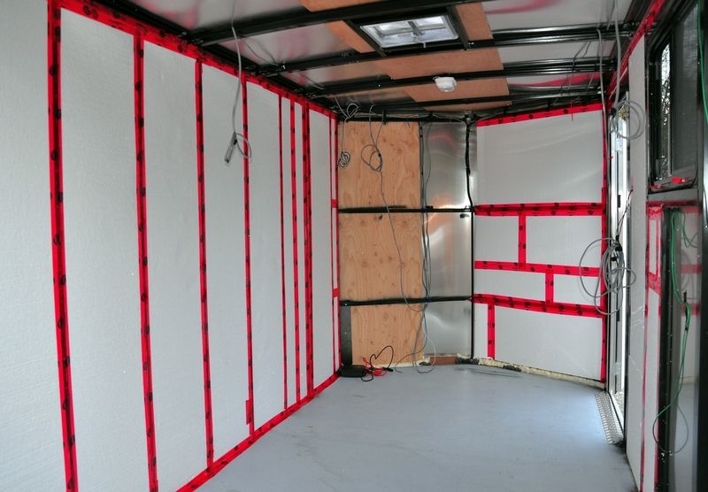

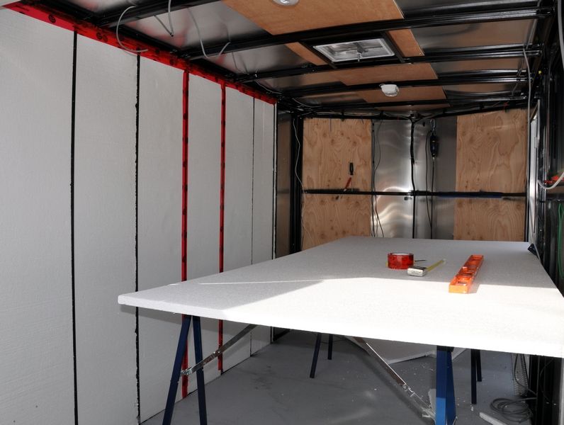

The next step was to work on the insulation. I ended up going with the white PlastisSpan type of insulation as the other rigid foam insulation that most others are using in their CT's, cost a fortune up here. 4'x8'x1" sheets of this insulation is $9.79 per sheet, whereas the other rigid foam of the same size works out to almost $40.00 per sheet. The R value between the 2 types is only 1.25 which is not a lot. With taking the time to seal the wall/floor joints as I mentioned above along with careful application of insulation to all areas, the R value difference will be negligible
Finished for the day. I now have a much better idea of what the white interior I am planning is going to look like.
I didn't insulate the front left side of the V-Nose as still need to work on the wiring.
The panel to the immediate right of the side door was not completely sealed off yet as I realized I will need to access it to put some switches in later. The right front and also the area below the side of the trailer is a hodge podge of scrap ends of insulation pieces, but as you will see below what little scrap was left. I also still need to tidy up that spray foam on at the floor in the front right of the trailer. I am not all that worried about as it will be covered but still...
Looking in through the side door toward the back. I also insulated and sealed the bulkhead above the rear doors and did the same above the side door which can be seen in the above photo. Notice the spacing of some of the wall studs? A couple of the studs have a double L lip on the outside edge so I had to cut the insulation down the middle to get it fit in. I still need to work on insulating the back corners of the trailer where the trailer running/brake lights and wire runs are.

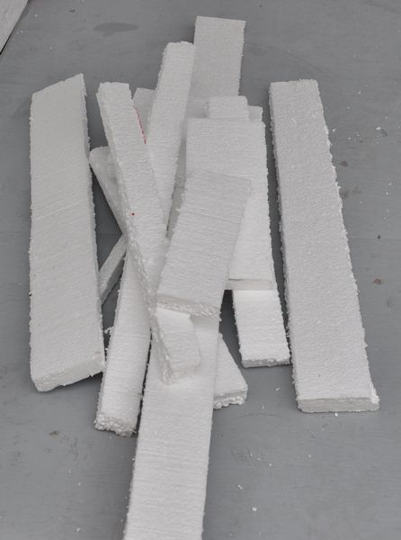

Out of 3 sheets (96 sq feet in total) of insulation, this is what scrap ends are left. With the left front of the V-Nose, the roof, the back curbside of the trailer and the rear trailer corners still to be insulated, I figure with careful planning, 2 more sheets of insulation will be all that is needed.

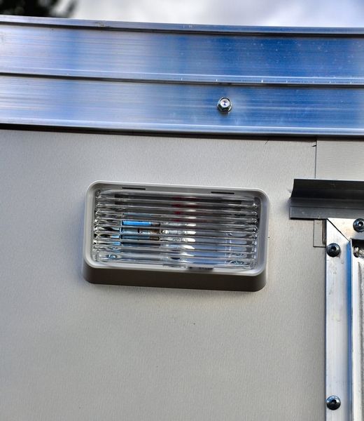

The only real work I got done on the CT conversion yesterday and today was to install the porch light then also completed the wiring for a couple of LED lights that will be installed over the bed. Other then tidying up some other wiring, that is it for this weekend.
Although the porch light is installed, I will be taking it off and putting some silicone around where the white plastic trim and the metal backing plate inside the light housing meets. With the amount of rain we get here, I can see that housing, getting a lot of moisture inside. I will also be replacing the incandescent bulb with a LED type at some point.

It probably wouldn't hurt, But I've got 6 of those exact lights on my trailer and its been through some pretty major rains.. Including my trailer sitting with in a few miles of 5 different tornados since last year :? I have not noticed any water getting into the lights and I did check for leaks pretty well after the first couple of major rains. You see all that water sheeting over the windows and you just know something is going to leak somewhere lol. So far so good..
