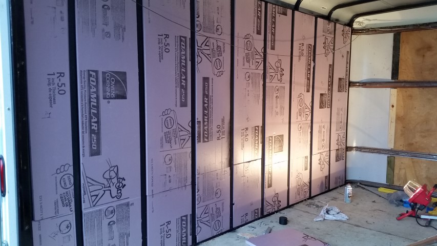

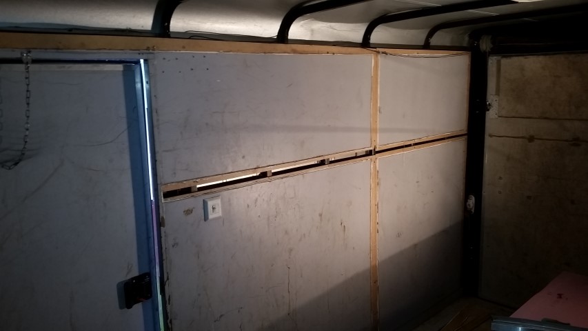

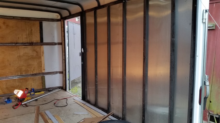

Got some insulation installed this weekend, Started removing the floor.
What it started as -
Inside wall before (Small).jpg (73.6 KiB) Viewed 2356 times
The 3/8th stuff removed -
Inside wall stripped 2 (Small).jpg (107.63 KiB) Viewed 2356 times

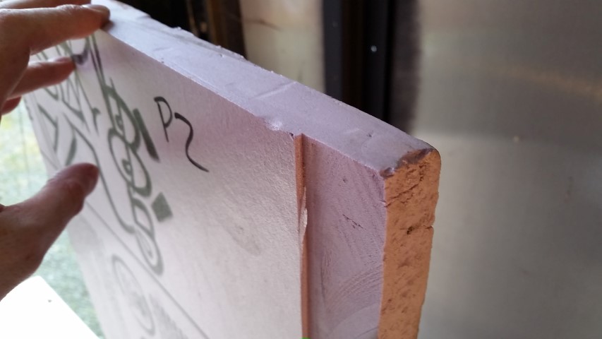

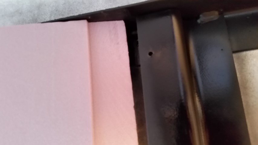

Trimmed the edge to slide behind the Z Strip -
Insullation edge (Small).jpg (69 KiB) Viewed 2356 times
Once electrical is routed, i will foil tape and foam all the seams.

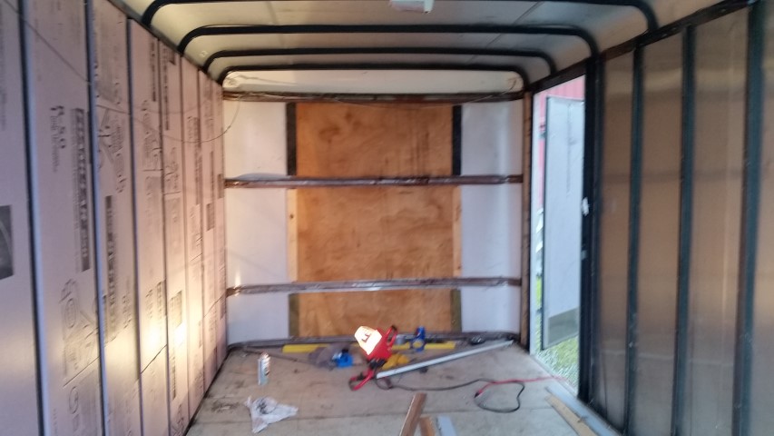

Postby RetchedOne » Tue Feb 10, 2015 7:02 pm
Another view of the edge -
Insullation edge 2 (Small).jpg (40.35 KiB) Viewed 2356 times
Inside wall insulated (Small).jpg (128.11 KiB) Viewed 2356 times
Inside view before (Small).jpg (99.55 KiB) Viewed 2356 times

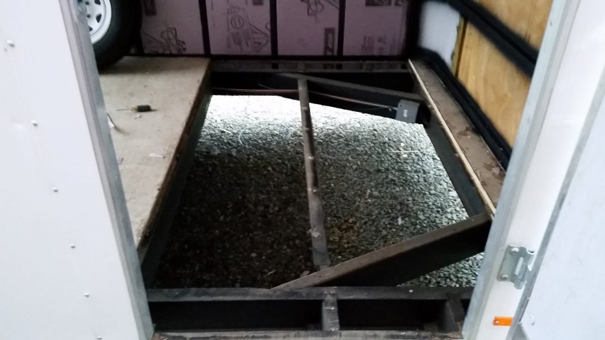

Postby RetchedOne » Tue Feb 10, 2015 7:03 pm
Just couldn't wait, so I removed one floor board -
Inside view Floor (Small).jpg (100.42 KiB) Viewed 2356 times
Probably wont get back to the trailer till teh 22nd, as Valentines day does not equal trailer time...

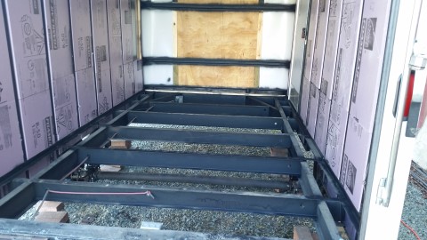

Postby RetchedOne » Mon Mar 30, 2015 3:02 pm
Sorry for teh long delay, got sick, then life got busy... Were moving in a few weeks so I have to get the trailer somewhat ready to use to haul our crap to the new place. I'm in teh process of re-wirign the actual trailer lights with new LED lights and break away controller.
I did get the new 3/4 inch plywood flooring in and secured... Painted the underside with a exterior paint to seal it up a bit.
open floor.jpg (73.7 KiB) Viewed 1955 times

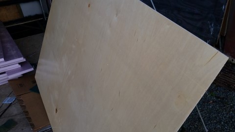

Here's the Pr-Finished 5/16ths material that will be used for the walls.

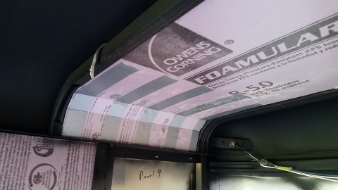

A few more interior pics
ceiling insullation.jpg (49.35 KiB) Viewed 1955 times
