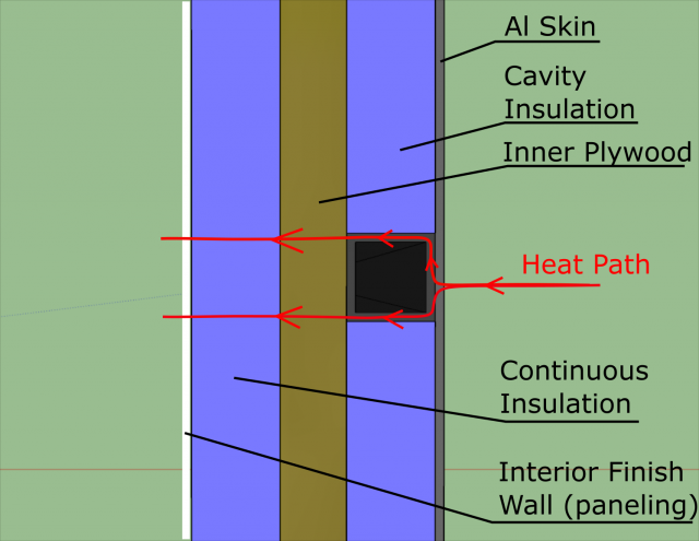

Here's a diagram of how I plan on doing my wall for my CTC:
In English: I will install rigid foam insulation in the cavities in between the 1" frame tubing.
Then the original 1/2" plywood will go back on.
And then I will fasten another 1" of *continuous* rigid foam insulation over that plywood. Continuous is a term used in the building industry to imply that the insulation is not thermally broken by studs or anything else.
To my mind, continuous insulation is the only effective way of combating the significant thermal bridging that you have with aluminum framing.
Also, a note about foam insulation on the inside of the tubing: it is my respectful belief, based not on experience but on, well, math, that adding foam insulation to the inside of metal tubing would have almost zero mitigating effect on thermal bridging.
The red lines in my image show the path that heat is most going to want to take. It is going to "want" to go from the Al skin, to the tubing, to the plywood, and then on to the inside. The heat will not want to go through the dead air space in the middle of the tubing, it is going to want to flow from metal surface to metal surface. Air, when it isn't moving, is actually a pretty good insulator. And inside a 1" tube, it doesn't have enough room to move and set up convective currents, so a 1" Al tube is effectively already insulated inside. (Sort of like a really skinny double-pane window...)

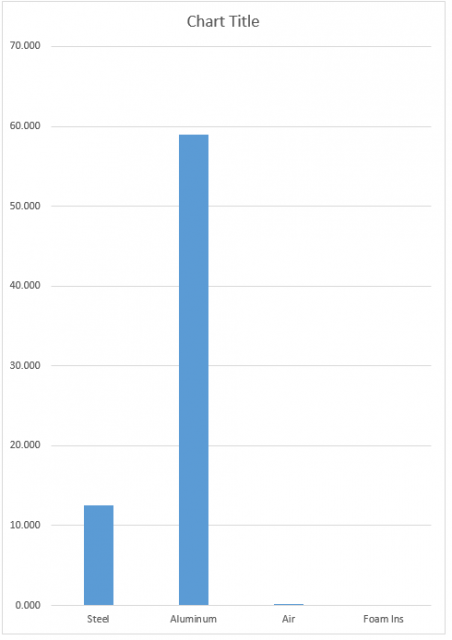

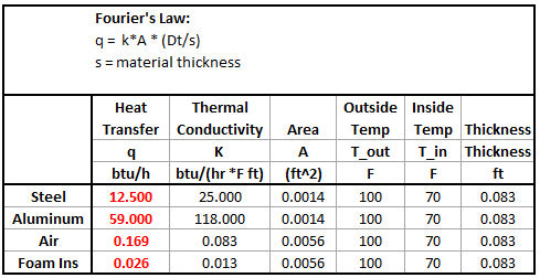

I certainly agree, you are correct, but if you run the numbers, the overall benefit you get from filling that tube with foam is almost nothing. Not worth the effort, I would argue.
No one actually cares what the "R-Value" of any material is, that's just a made-up number some engineers came up with that makes it easy to compare materials. The units of R-value are Btu/(hr F ft)... I studied engineering for 5 years and I've no real notion of what that means, intuitively.
What people actually care about is *how much heat is getting in to (or leaking out of) my space?"
And if we run the numbers on that (otherwise known as heat transfer), we see that insulating the inside of your tube isn't doing much:
(I wasn't sure if the tubes are steel or Al, so I did both)
If you put those numbers on a graph, the heat transfer through air vs. foam is barely even visible:
So by making the path through the center of the tube about 6x as insulated as just air, you are improving the *overall thermal performance of your wall* by some unimaginably tiny fraction of a percent!
This is why - to my mind - the only way to meaningfully mitigate thermal bridging (and I assume condensation issues) is through the use of a continuous insulation layer. Now, that means you lose a few inches of interior space, which might not be worth it. If you only camp in reasonable weather, continuous insulation might not make sense.
