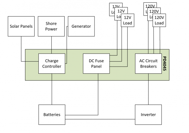

ok... just to make sure I understand this... something like the PD4045 ( helpful video here:https://www.progressivedyn.com/rv/power-centers/inteli-power-4000-series/) would be the main panel/center point of my electrical system and it provides three main things:
  • Breakers for 120VAC power (these end up in line between the batteries and the wall outlet). Helps centralize the wiring as well as provide protection.
  • Fuses for 12V Power (these end up in line in between the battery and any directly connected or thru a 12v adapter). Helps centralize/distribute the 12V power as well as provide protection.
  • Is a charge controller for the batteries to help best charge and protect the batteries.
Questions:
  • Would using this panel, and specifically feature #3, then remove the need for the charge controller that would come with the Solar Kit I was looking at? (https://www.renogy.com/renogy-200-watt-12-volt-solar-starter-kit/)
  • I'd still need to purchase and install an inverter between the batteries and the 110VAC circuits in the PD4045, Right?
  • When i'm ready to add solar panels, they would feed into the controller portion of the PD4045. Right? And would shore power/generator hook into the controller too? Basically all sources of power into the controller which manages the charging of the batteries. The DC hangs off the batteries directly (perhaps thru this device to facilitate consolidation and protecting with fuses and the AC outlets would be wired to the breakers which have an inverter upstream (not included in PD4045) which is connected to the batteries too.
Here is a drawging I just made to try and capture what I think I understand and what my questions were getting at:
My 7x7x14 Tandem Axel build thread: viewtopic.php?f=42&t=69731

Postby McDave » Sun Dec 31, 2017 2:04 pm
Solar will require its own charge controller, preferably MPPT as that will make the most of available sunlight and generally are smarter as far as battery conditioning. You may need a transfer switch but again most MPPT's handle this automatically.
If you want to produce 120vac from 12vdc you will need a separate inverter. The power centers have a converter which produces 12vdc from 120vac. A separate function is the charger. Both the PD4045 and the WFCO8955 have quite sophisticated battery charging and conditioning programs.
I believe solar charger may bypass power center and go direct to battery bank, which is tied to DC side of power center.
AC shore power and generator use the same 30 amp main. A transfer switch here can be a good idea, I just plug into one or the other. Your drawing is a pretty darn accurate picture of what goes on. I only have 2 AC outlets wired to inverter, 1 inside, 1 outside. I have never used them as I have only a single deep cycle 125ah battery currently and I have generator on board for charging and Air Conditioner. My refer is 12v/120v, TV 12v, stereo 12v, all lights led 12v, pump and fan 12v. If I need to use a drill or saw I just fire genny and charge and cool at same time.
It sounds like you have a pretty good understanding of electrical systems, The reason I like power centers is the "all (most) in one" ability as opposed to separate components to do the same job. They are really quite reasonable at about $150-200

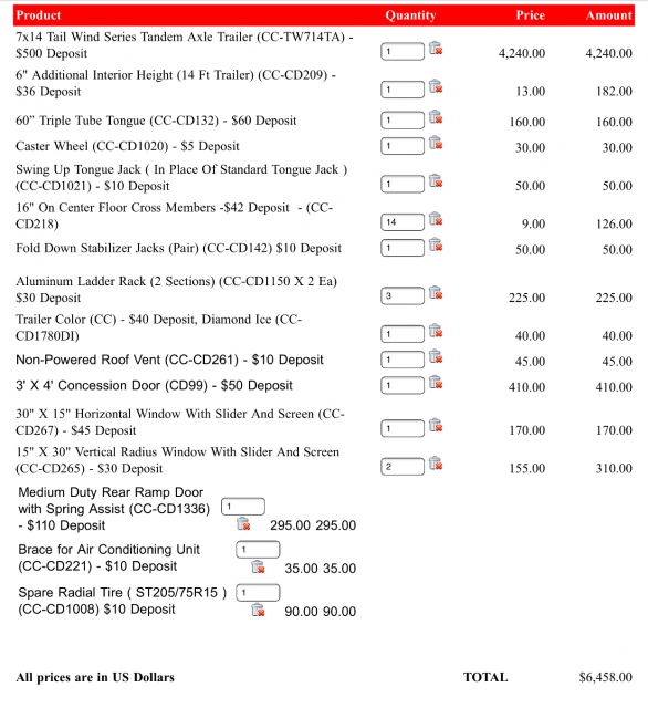

Just ordered my trailer from Chris @ http://trailershowroom.com!!!! Chris was very helpful, responsive, and very patient with my oodles of questions.
I think the leadtime is about 10 weeks. Cant wait!
Here is my quote for reference - it's all on their website!

Transfer switch between the inverter and shore/gen and then to the AC circuits is needed unless you will be running separate AC circuits. The Gen and Shore input should be one in the same to the panel ( mutually exclusive between shore and gen).
Also, then, converter needs to be isolated from inverter power when running from batteries else you will have a degenerative loop situation.
Following are my schematics for reference only. I may have tweaked some DC breakers sizes since this drawing; however, the system functions great. Very happy with results.
I did not use an all in one panel for various reasons; however, functionally, it works the same way, just modular components to fit my specifics and customization.
All in one power centers simply combine the converter/ battery charger, DC fuses and Distribution, and AC breakers in a nice clean box and makes the appropriate internal connections to get AC power to the converter. Will save some time wiring, especially if you are unsure of your wiring skills. You will need a separate transfer switch, inverter, and solar controller as a minimum to go with this and a few shunts/meters if you want to monitor what goes on.
Depending on your needs, you may even need a separate main from the power center if you want to ensure some things do not try run off the inverter depending on the size of inverter and other choices. This is also the best way to ensure the converter is not running off the inverter also. (It appears the PD4000 Series does have a separate AC in to power the converter so that can be accommodated). Just food for thought .

flboy wrote:Transfer switch between the inverter and shore/gen and then to the AC circuits is needed unless you will be running separate AC circuits.
<snip>
<snip>
Wow! Great info and I'll deff use your image as a reference and build my own modeled after that! :applause:
