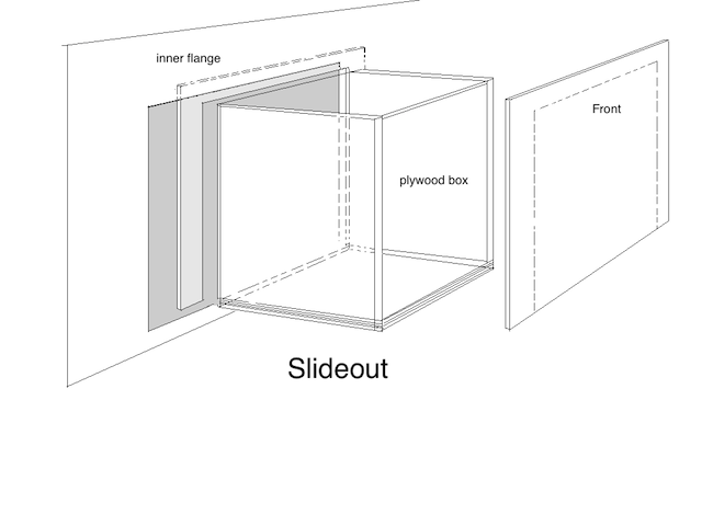

The part I can't get my head around is how to design the seals. I keep going with an inner flange design, almost like a drawer face, that would seal around the inside wall of the trailer. The problem is that I can't resolve how to have lower part of the flange and have it clear the supporting structure of the drawer.

Postby GPW » Sun Nov 20, 2011 7:40 am
Anybody got an idea how to make a slide out ... just a big Box eh ??? Would plywood work ... ? This was all I could think of ... seems simple enough ??? :thinking:

Postby GPW » Sun Nov 20, 2011 2:50 pm
SUG, something like this ? Image
Postby StandUpGuy » Sun Nov 20, 2011 8:20 pm
exactly like thatGPW! Only you do end up with the box extender being atleast the thickness of the plywood higher than the inner bed. Also I could see building cabinets over the bed too and placing a heavy duty shelf slider into the underside of those cabinets. Lets face it you will not need gobs of headroom over the bed and you will not have much else for storage elswhere so it might be something to consider. Looks like you have it figured out.

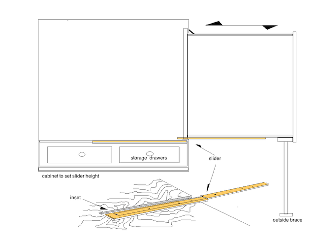

Postby StandUpGuy » Sun Nov 20, 2011 8:29 pm
Remember Roly Nelson's little 3x3 trailer? He had a pivoting extension instead of a slider. That was very simple. You just need feet room like maybe 2.5'.
Have a look at the thread:
http://tnttt.com/viewto ... box#860156
Sorry for the bad paint quick sketch but maybe you can get the idea of it:
By justoneman at 2011-11-20
