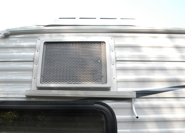

Here is another view of what I want a/c to look like
hidden away under my side wall solar panels.
above you can see the refrigerator roof vent that draws in the air into the cabinet

I think I would try and vent the A/C out the floor if you're going totally stealth. I can't find any pictures but you could build a plenum so fresh air is drawn in from a side wall across the condenser coils and out the floor? Mine isn't total stealth but it works well.

Skip back 3-4 posts, 1 page back and you will see the AC will vent behind the side solar panels
This should keep them mostly hidden , I will suck in fresh air from below the floor , hot air vents up.

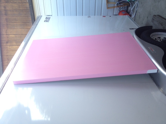

The a/c will look something like this & sit hidden behind the side wall solar panels pictured in pink below

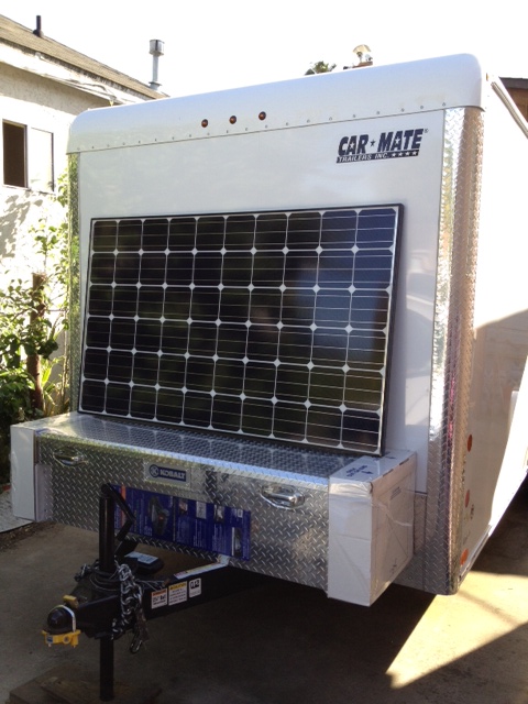

Postby OverTheTopCargoTrailer » Wed May 01, 2013 4:42 pm
Here is my latest idea

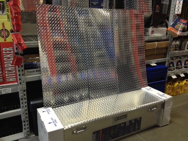

I will install a extra wide tool box on the trailer tongue
Above that will be the front solar panel 255 watts
and to hide the front panel - a diamond plate cover in one piece,
this cover will fold down and lay flat on the cargo box,
a friend said that I could be used as a table & needs some bar stools....
when the sun is gone, the cover would just be folded back up & secured with screws. :D :D
5 large panels will also be installed on top of the roof.
2 panels on each side , over 2,200 watts
photo 2-2.JPG (138.77 KiB) Viewed 3148 times
Below is the Lowe's test mock up to get the flavor
photo 1-2.JPG (186.82 KiB) Viewed 3148 times

Postby dustboy » Wed May 01, 2013 6:51 pm
I thought about putting a tool box in the same spot, but won't it take a big bite out of your jack knife angle? Someday you're going to need to back into a tight spot and that thing is going to be a big bummer.
dustboy
Posts: 279
Images: 10
Joined: Fri Jan 11, 2013 5:27 pm
Re: OverTheTopCargoTrailer 7 x 16
Postby OverTheTopCargoTrailer » Wed May 01, 2013 7:05 pm
HI Dustboy
Holly crap - I never thought about that :cry: :cry: :cry:
:x :x :x :x :x :x :x :x :x
not only that ....but its higher then the jack :frightened: :frightened:
its a good thing I still have you guys supervising me !!!
so I better figure out how to make the box easy on & easy off ......
before I go further with the plan
BACK to the drawing board :cigar: :cigar: :cigar:
:rainy: :rainy: :rainy:
Jerry
Posts: 1628
Postby Mark519 » Wed May 01, 2013 9:09 pm
Jerry, It is hard to tell from the picture how tight it really is. I would hitch up and see first. If you need a smaller box there are plenty of them. You might also find a welder who could clip the corners to give you a little more clearance.

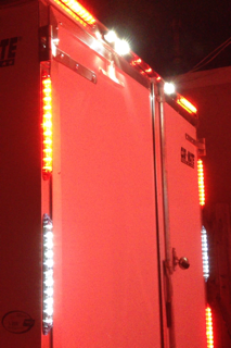

Postby OverTheTopCargoTrailer » Sat May 11, 2013 7:54 pm

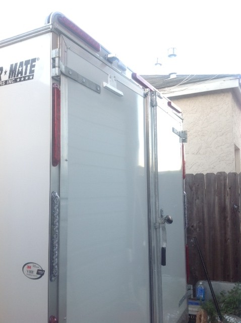

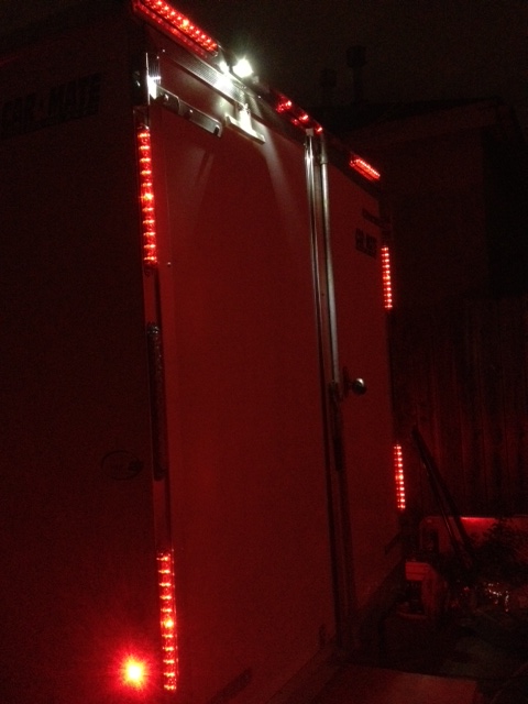

You can't really tell how bright they are as these photo's were shot from almost 90 deg angle.
But I can almost promise tail gaiters will get a LED sunburn 8) :lol: :twisted: 8) :lol: :twisted:
rear lights on.PNG (138.74 KiB) Viewed 2954 times
This with the lights on - parking lights only.
CLICK- ON PICTURE
photo 3-2.JPG (61.33 KiB) Viewed 2944 times
The red light from the side marker "bottom right" is just one LED,
the rear are 66 LED's in Red and 30 LED's in white light.
I have another 36 Red - Orange LED marker lights to be installed.
There is always some good stuff coming on OverTheTopCargoTrailer Version 2.0

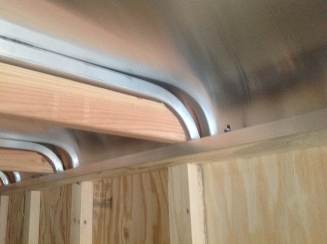

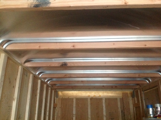

Postby OverTheTopCargoTrailer » Sat May 11, 2013 8:30 pm
Per the manufactures recommendation I reinforced the ceiling with 1" x3" lumber
its notched so it fits directly under the alum roof beam - to provide extra support
photo 2-3.JPG (116.27 KiB) Viewed 2945 times
photo 1-3.JPG (95.35 KiB) Viewed 2945 times
the 1250 watt roof panels weight about 200 LBS and this will help greatly.
This gives me a full 3.5" to add insulation :D :D

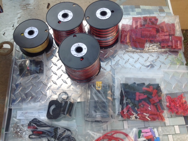

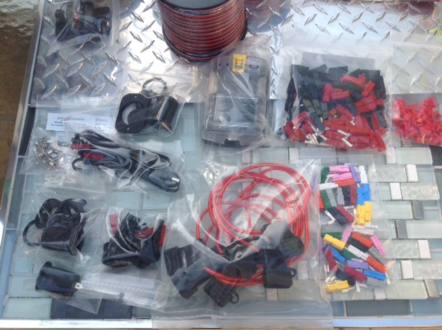

I also ordered some extra wires - just to be prepared
a wire 2.JPG (144.17 KiB) Viewed 2943 times
a wire.JPG (143.94 KiB) Viewed 2943 times
Anderson powerploes
http://www.powerwerx.com/
