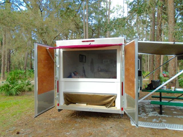

I will have to leave one barn door party open for air circulation as shown below.
The AC sits nicely in a previously prepared shelf area. The aluminum pan is a temporary condensation catch basin until I can figure out a drain system. The next three challenges will be to figure out if I need to add circulation fans in the opening for better cooling air flow, how to secure the door for security reasons and how to keep rain from coming in. I have ideas for all issues.[/quote]
It looks like you have a rain drip edge above your door. So do I. I purchased some aluminum channel from Home Depot and made an awning. It has a woodend dowl in the free end with square stock on the ends. It fits into pins mounted ont he trailer wall. It installs in minutes and works well. i hold it on with spring clips

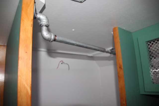

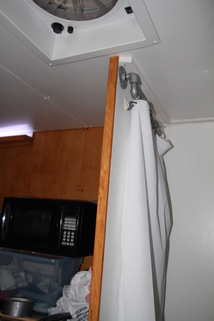

Built a swinging shower rod holder out of 1/2 in plumbing pipe.
Bob

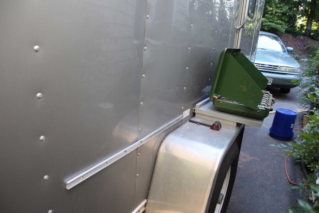

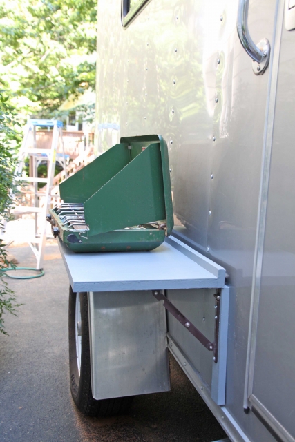

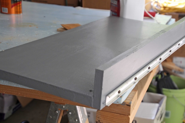

Bob, here are photos of the side table I built.
This shows the rail system I used and got the idea for the side brace from MtnDon.
For the high back board I added, I had to cut it down significantly. It interfered with the insertion of the table rail to the trailer rail.
This shows it resting on the fender for the other side. For the other rail, I am adding another 35" table which is under construction now.
The stove is shown sitting on it now. But I am not sure I will use it that close to the side of the CT.
