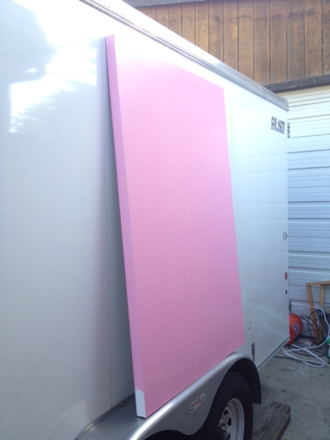

Thats an excellent idea and drawing, I would however be scared to do 2 panels as they are each 50lbs
I was just thinking should I have the panel solar sides facing out - screwed in place (( then remove the metal cover ? ))
This is the metal solar panel cover - with pink plastic to protect metal
a solar panel cover.JPG (88.44 KiB) Viewed 2545 times
2 separate panels actually will sit side by side
vs.
Having the solar side face the trailer & then having the whole cover with panel fold down
this is where your idea with a single hinge would come into play....
I was thinking of a 2" wide 30" long piano hinge on the bottom folding panel for now.
*****the reason I need one panel to fold out 6-12" is because the hidden a/c will be under the cover.******
Thanks for the great idea & drawing
Jerry

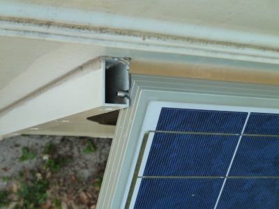

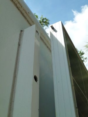

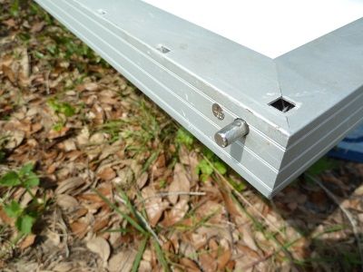

Check out how this guy did it:
Tom_M wrote:Here's some pictures of my install:
I used some aluminum rectangular tubing that I had laying around to fashion the side brackets. There's a slot at the top that a pin hooks into.
Panel lifted off top of bracket.
The pin is a stainless steel bolt with the head cut off.
Each bracket is fastened with 5 stainless steel sheet metal screws into the fiberglass siding. I also used silicone adhesive.
The lower pins are an aviation style safety pin that I happened to find a a flea market.
Lower pin.
RV.net linky

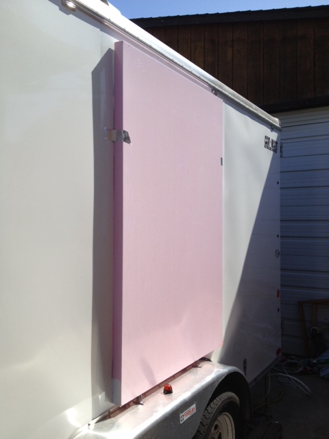

Postby OverTheTopCargoTrailer » Sun Jun 02, 2013 8:31 pm

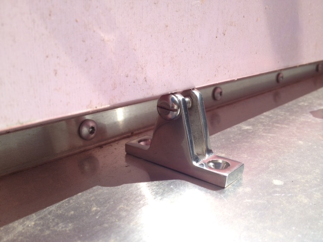

Ok so here is what I found, some 2 hinges I can install on the fender that will allow the panel to tilt outward on the top
I just need to make a metal bracket - which I can screw to the panel :? :?
photo 1-2.JPG (86.81 KiB) Viewed 2493 times
This is the white solar panel cover - "WITH" the plastic film still present.
2 panels will sit side by side-
only one need to tilt out for the A/C behind the panel.
photo 3-1.JPG (90.09 KiB) Viewed 2493 times

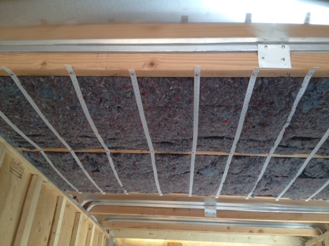

Postby OverTheTopCargoTrailer » Tue Jun 04, 2013 5:08 pm
Because its supposed to be soooooooo FRIGGIN HOT in the coming days...
I have decided to jump ahead to the ceiling insulation....
to give it the real ACID test... I will leave the exterior roof silver.

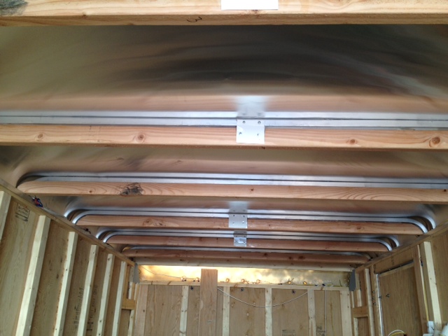

I'm installing a full R19 Denim Ultra Touch Insulation
photo 1-3.JPG (105.3 KiB) Viewed 2416 times
Above you can see the 1" alum rib , under which I installed at 2" x 3" wood to help support the rib
and allow 3.5" insulation space.
photo 2-3.JPG (142.31 KiB) Viewed 2416 times
Here you can see in between the bays
photo 3-2.JPG (128.83 KiB) Viewed 2416 times
Here is a bay filled with insulation, as for the ceiling I will install 1" foam board
for a total R-25 ceiling.

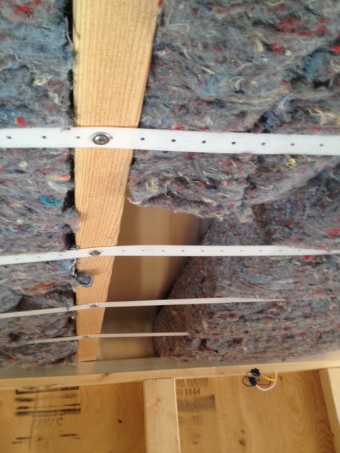

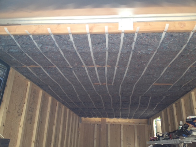

Here is the material I used, its R-19 Denim Ultra Touch BUT it only fluffs to 3.5" :x :x vs should fluff to 5.5"
many online forms complain about this situation......
My guess the material is more for walls vs ceilings & fluffs more when hanging.
But in my case it works - ok :D :D
THE STUFF is a PIA to cut & is somewhat dusty
photo 3-3.JPG (118.34 KiB) Viewed 2371 times

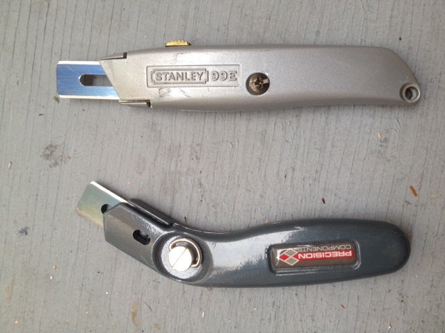

Wouldn't you believe it I misplaced my stupid knife, :x :x but I was able to make this straight knife & carpet blade work.....
after I was done then by magic ....the old one was back. :NC
almost done.JPG (113.87 KiB) Viewed 2371 times
Im keeping it open for a while to test & see how well it works.....
the final layer will also include another 1" foam and 1/4" plywood maybe ?

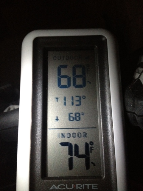

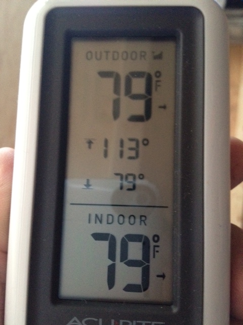

Postby OverTheTopCargoTrailer » Sun Jun 09, 2013 8:58 am

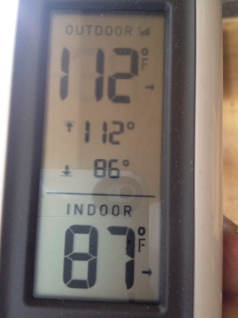

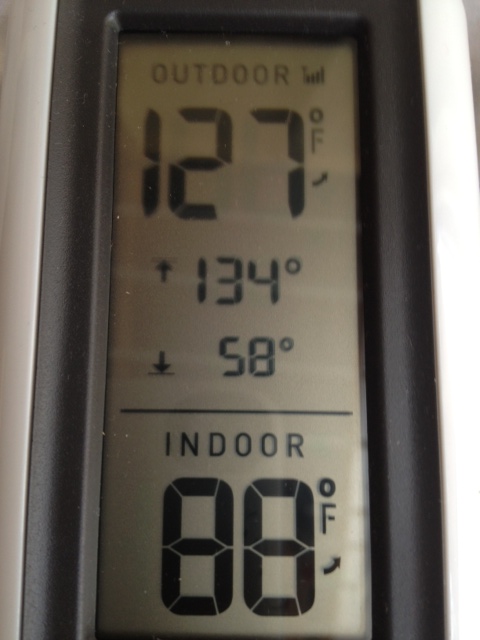

Late today I purchased a wireless thermometer and as is normal for Over The Top ...
I installed the wireless unit between the insulation and the silver metal roof. This was at 5:30 PM late today.
Tomorrow it will be much colder so I will have to wait until it gets hot again for additional test results.
inside the temperature was 87 - but under the roof insulation it was still 122 deg F at 5:30 pm
My bet is, the silver roof will hit 130 deg F easy. Here again is where I tell you
at this temperature your solar panels will loose 50% of their output.
I will also experiment with spraying cold water on the roof to see how it brings the temperature down.
I bet none of you have ever thought about cooling your RV or panels down by spraying water on the exterior,
it is very effective because water absorbs heat very fast.
It's now 8 PM evening and both temps have equalized. Once fully insulated the opposite readings
should happen at night. Maybe 60 under the skim outside & 75 inside. Time will tell, I plan to install more wired units.
Late at night, now the exterior skin temp has fallen bellow the interior temp.
The alum temperature is 68 deg F & inside its 74 deg F

Postby OverTheTopCargoTrailer » Mon Jun 10, 2013 9:43 am
Hi Earnest
I think your right :D :D Today in reached 134°F. Most of the day it was above 125°F.
