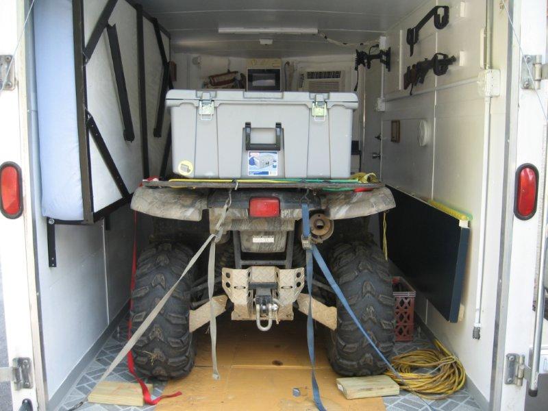

grizzly 660 after a trip
Well that’s about it for now. My next project is “water”. Thanks to everyone who inspired me with great ideas.

I particularly like the unique battery compartment you built. It's not obvious what it is.

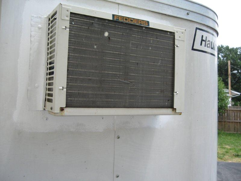

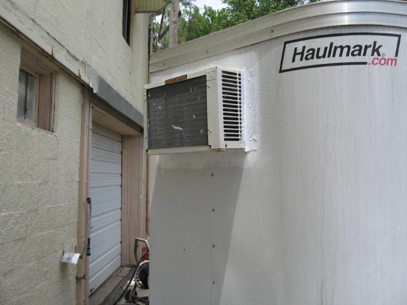

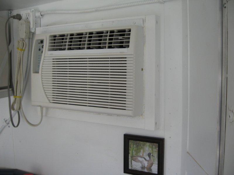

Can you post a picture of the exterior of your a/c install? What size unit did you use?

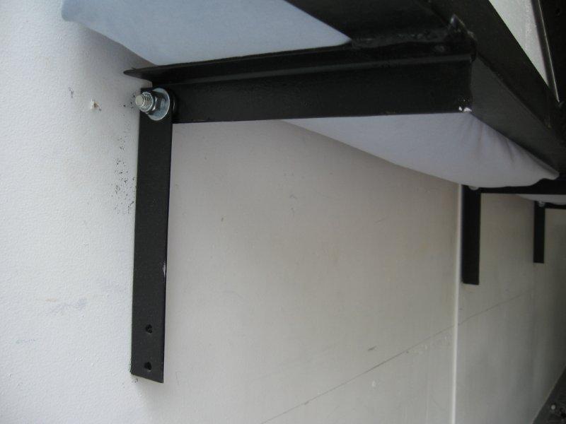

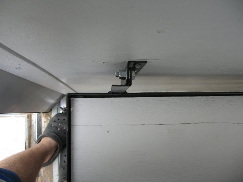

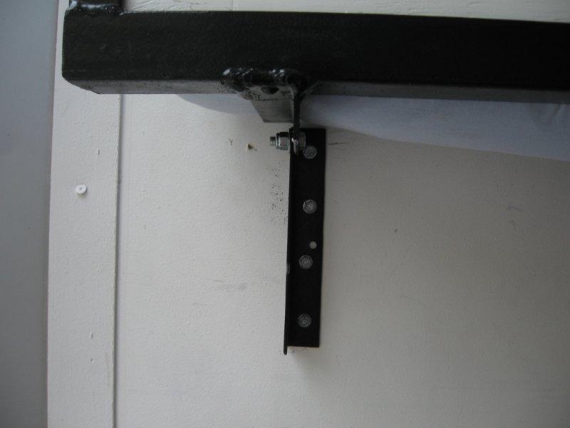

could you add a couple more pictures of the hindge you welded where the bed attaches to the trailer,

The hinge is two 8 inch long pieces of 1 ½ inch angle iron. One is attached vertically to the wall stud. The second is welded vertically to the bed frame. The secret is the pivot point for the bed is the same height as the mattress above the bed frame (pivot is at the top of the mattress). This allows the bed to fold against the wall with the mattress in place. I used three 8 inch pieces on the wall, and three equal pieces on the frame. Three large grade 3 bolts are the “pin” the angle pivots on, with a washer in-between the two angle pieces. Nylock nuts insure the tension on the pins are constant. If this is too confusing ( hell I’m confused reading this) I can make some drawings for anyone who wants more detail. If anyone is in the St Louis MO area you are welcome to stop by and check it out, e mail me.

I used a 5K unit I had sitting around. This is plenty. I have been in direct sun in 105F weather and the trailed was a cool 68 degrees. The digital temp settings is worth the extra money!!! The AC is set in a frame of 2x4’s. the frame is screwed in from the outside wall in to the frame. The frame is sealed to the wall using “greatstuff” (window and door) spray foam. The AC then slides in from the inside and attaches using the standard lip on the unit with screws. The AC is sealed in with more “greatstuff” to keep water out. After the spray foam dried it was trimmed and painted. The outside has three pieces of flashing (top, and sides) to keep water from running down the trailer and getting between the walls. All seams were caulked and painted with outdoor hi-gloss. The whole trailer could use a good outside painting, but I’m so busy camping I don’t have time to be vein and worry about that. Again if this is too confusing ( hell I’m confused reading this) I can make some drawings for anyone who wants more detail. If anyone is in the St Louis MO area you are welcome to stop by and check it out, e mail me.

As far as rain coming in the rear of AC I have had no problem. I used expanding foam to seal the AC to the wall, and the flashing keeps the rain from getting to the seal at all. I even trailer with no cover sometimes with no problem. Make sure you tilt the AC downhill when the trailer is flat (keeps the condensation from running in the trailer).

I wonder about the back of the AC unit getting bug strikes going down the road smashing the fins on the AC.

Most of the time I travel with a cover on the AC, but the few times I forgot to install before leaving I have had no issues with bugs or rain. Remember your tow vehicle has a big radiator, most the time two or three (AC condenser, trans cooler), with soft aluminum fins and no cover. Food for thought. Leafs, dirt, and debris have proven to be more harmful (in my situation) with the clogging of the drain holes in the unit keeping water from draining. I enlarged the size of the drain holes in the AC pan to allow “crud” to exit the pan. “Great success.”
