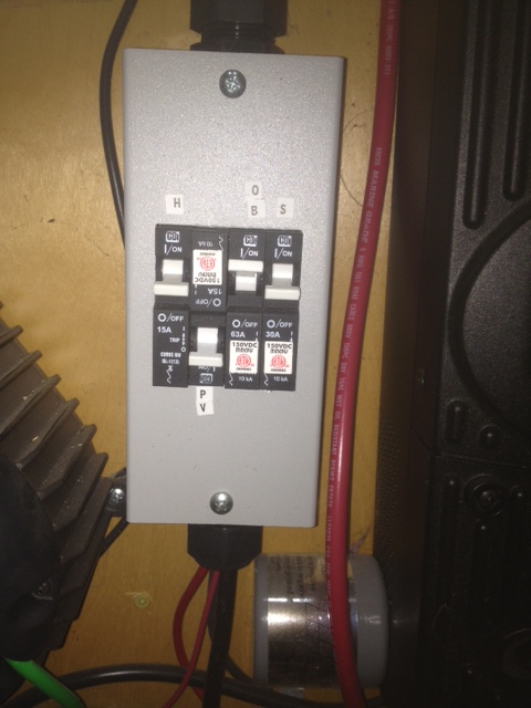

so here is the link to my breaker / breakers..
http://www.ecodirect.com/ProductDetails.asp?ProductCode=MNEPV63&gclid=CPPHqYzOw7kCFQ9dQgodeXYA2Q
e panel 8.JPG (111.59 KiB) Viewed 1967 times
1. left side 15 is AC breaker for my incoming shore power,
2. is a 15 amp DC breaker for the incoming 4 x 255 LG solar panels.
3. is the 63 amp DC - from the Outback to battery bank
4. is a 30 amp DC breaker to my trailer sub panel.
when I made this box 2 years ago I could not find a 80 amp DC :x ... only 63 amp DC
more to follow next posts coming

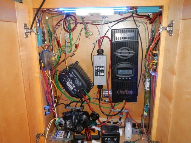

Here are a few pictures of my panel, don't laugh I built this when I did not know diddle squat about solar
& when my system was only 840 watts 4 x 210 koycera panels
e panel 1.jpg (51.77 KiB) Viewed 1962 times

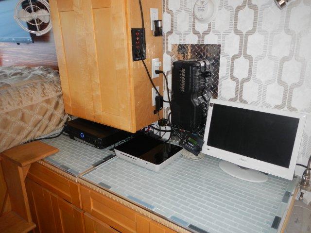

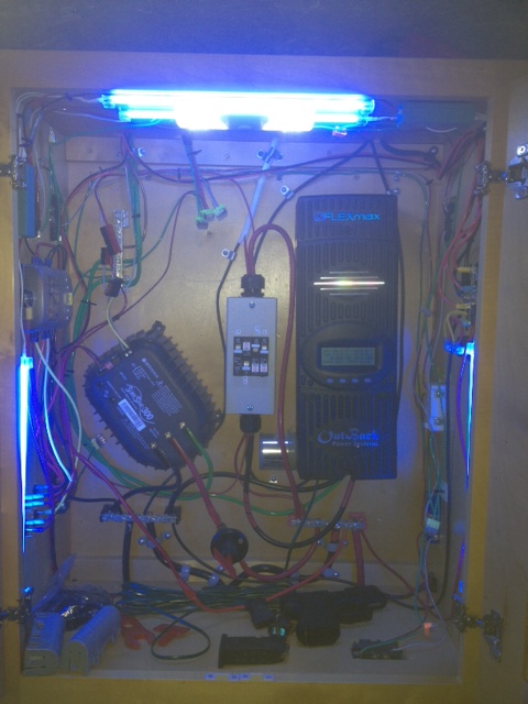

Day time view of the cabinet , combines everything a/c and all d/c in one cabinet.
e panel 3.JPG (120.7 KiB) Viewed 1962 times
Night time view of the cabinet
on the very bottom left you can see my "black" negative bus bar >>>>>> right side is the "red" positive bus bar
on the top left side there is the Ground bas bar "Green"

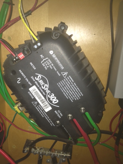

Postby OverTheTopCargoTrailer » Wed Sep 11, 2013 10:37 am
Here is my 300 watt PSW it also has its own disconnect
also its on a switch to shut it completely off.
e panel 4.JPG (128.74 KiB) Viewed 1960 times
the bottom red & black wire allow the inverter to be switched on / off
the yellow & white wire supply the 300 watts a/c power - connected by a 5 amp fuse.
e panel 5.JPG (98.93 KiB) Viewed 1960 times

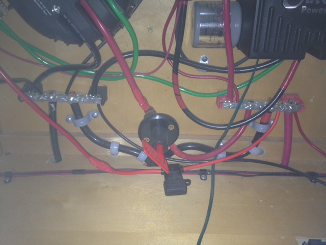

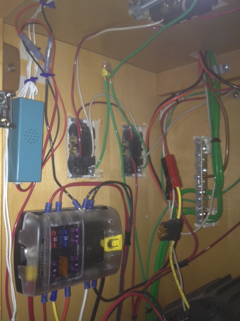

Closer view of my DC bus bars & the Inverter disconnect
e panel 7.JPG (117.16 KiB) Viewed 1960 times
Closer view of my ac outlets & the green ground bus bar
and some dc breaker panel,
the blue box is for the florescent dc blue tube lights
Romantic night time lighting :wine: :wine:

Postby MtnDon » Wed Sep 11, 2013 1:31 pm
Quick note, then after I get some odds n ends done I'll be back
The specs on that Midnight Solar breaker state that it operates independent of temperature. So I believe that means it is not an overheating situation that is causing it to trip. That leaves two choices; it is actually being overcurrented (probably not a real word but can be a real cause). Or there is a chance the breaker is defective or wearing out. Breakers are designed to fail by tripping early rather than not tripping at all.
My bet is overcurrent. If the system operates close to the maximum current output it would only take a small nudge to cause a trip. The trick may be finding a larger (80 amp) breaker that will fit the same space. Midnight still does not have an 80 in that series breaker.
Back later...
EDIT: there is also a small chance that the breaker can trip if the terminals are not torqued to specs. That can cause extra resistance in the circuit and lead to issues.
MtnDon
Posts: 2200
Images: 24
Location: New Mexico
Re: OverTheTopCargoTrailer 7 x 16
Postby bdosborn » Wed Sep 11, 2013 1:38 pm
Silly question but, are your sure its an 80 and not a 60? Also, the Outback has a fan for cooling, did you run it with the cabinet door closed? Maybe it got too hot in there.
