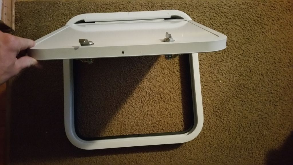

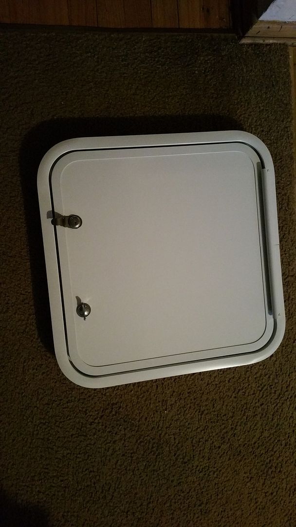

Okay. Is that what I'm going to want to install my cargo door with? I keep seeing people talk about butyl tape too.
I was thinking just a thick bead of sealant around the flange, then press it in to place.
