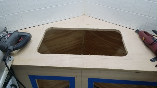

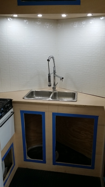

I cut in the skink and drilled the hole for the faucet. I'll be removing them again to finish the counter top... but I figure no reason to finish the area I'll just be cutting out.
Not sure I like the faucet. I got it for 84% off... and it looked cool online... Since I have it, I'll give it a go. I can always replace it later. I wanted something a little taller due to the more shallow sinks... It is heavy duty.. for $40.00 I took a chance.

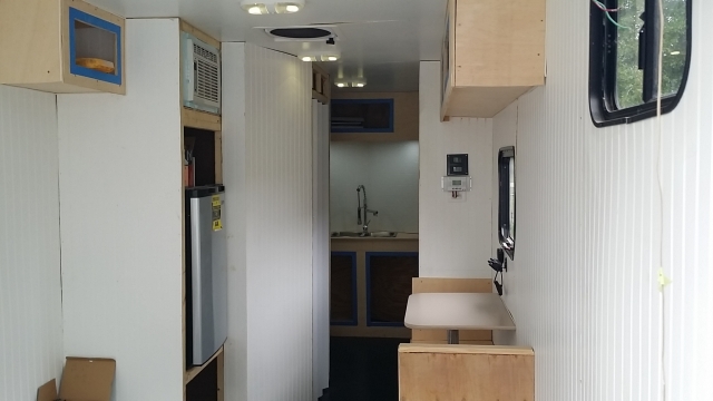

Back to front view (missing my mess in the very back of the trailer!) .. I got a lot done these last few days off. Getting close to spending some time building the faces for the AC Rack and the electrical closet up front, then I'll get to the cabinet doors and lastly trim and painting (everything needs to be painted inside given it is all just bare wood or primed). I can see the light at the end of the tunnel! :)

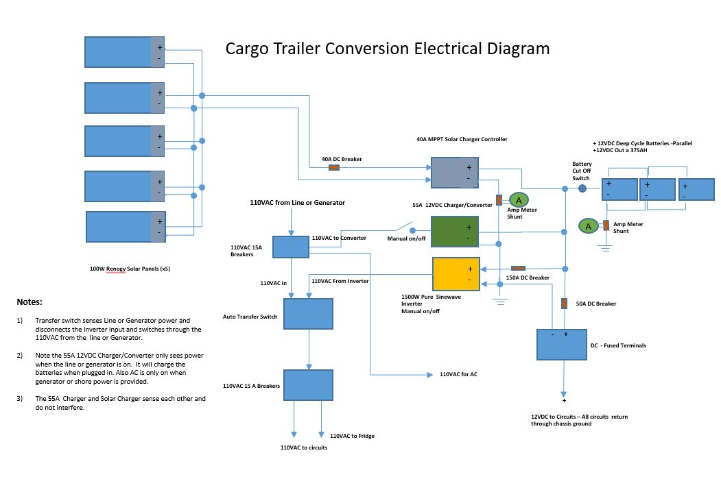

Postby flboy » Mon Sep 05, 2016 4:58 pm
Hader... hope this works. The attachment should be a higher resolution.
CTC Electrical Diagram.
Electrical Schematic.JPG (75.55 KiB) Viewed 4677 times

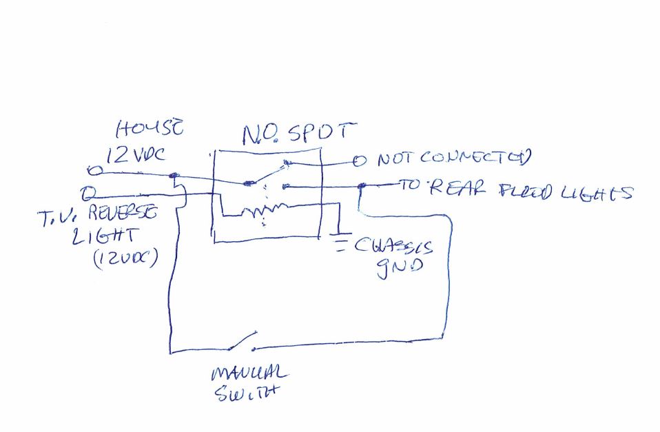

Postby McDave » Tue Sep 06, 2016 5:47 am
Hey Don,
You wouldn't happen to have an example of the relay for the back-up lights? Just tap into TV reverse light wiring and use that to trigger relay in trailer and house battery, correct?

Postby flboy » Tue Sep 06, 2016 5:57 am
McDave wrote:Hey Don,
Thanks,
McDave
Dave, that is correct. Just use the reverse light to control the relay for the house battery to the lights. You can also connect the output of the relay to the CTC switch output so you can control the light with or without the TV hooked up . It will not harm either if they are both active since they are both on the house battery.

Postby McDave » Tue Sep 06, 2016 7:02 am
What is your parts source? I'm using the same LED ramp lights as you and Martin. If I remember correctly 18 wt each, so it only need to be 5-10 amp ? Should be able to find one at Napa etc.? Relay in parallel with house switch, OK?
Are you wired for TV to house battery charging? If so, tap into keyed circuit, then 30a fuse on hot to 7 pin, Then 7 pin to 30a to house battery? Or use relay here as well? So keyed circuit to trigger, hot from TV battery to relay, to 30afuse to 7 pin, 7 pin to house battery?

Postby flboy » Tue Sep 06, 2016 7:57 pm
McDave:

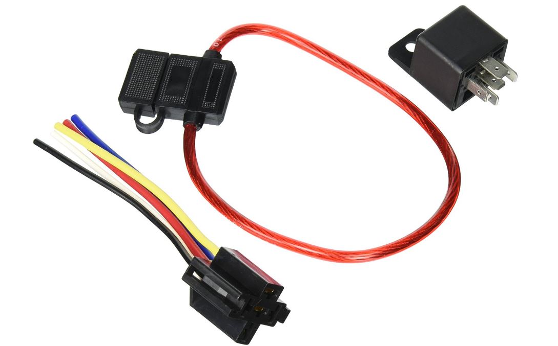

Following is the link to Amazon for what I bought. I like this because it came with a pre-wired socket ( I didn't need the fuse). Very easy to connect up. I hand drew a diagram for you as it was quicker since I do not have Visio or etc. at home. Note that on many 7 Pin RV Connectors.. sometimes the center pin is the reverse lights.. sometimes it is auxiliary.. you will have ot check that. In any case, this is how I have implemented the switch. The power is about 18W each if you have the same lights I have.... should be around 3 to 3.5Amps. You do not need a heavy gage wire at all.

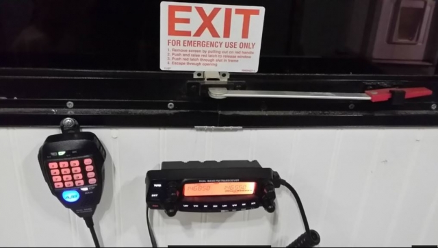

Postby flboy » Tue Sep 06, 2016 8:08 pm
Got a few little things done tonight after work.

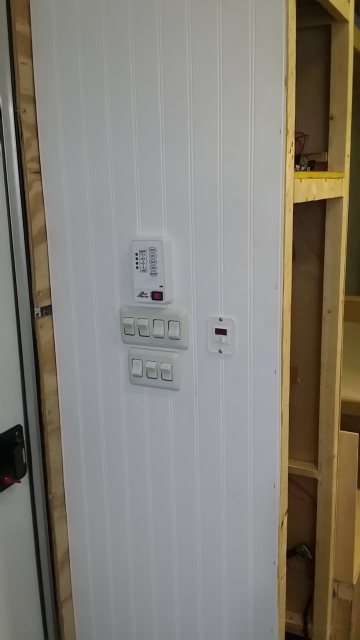

I installed the Water Pump Switch and the Monitor Panel. This seemed like the best spot for it as the other side of this cabinet is all the solar charging system monitors. The single lighted switch off to the right is for the Hot Water. Did I ever mention how much I like my rotozip for these type of jobs! So easy to make a small cutout!
I am going to install the sensors on the Fresh water tanks which will be monitored here (may as well since I have the sensors already and pre-wired he walls). I am still not sure what I am going to do about the gray water and black water sensors. I mentioned the issues there a while back. But this panel has a Fresh Water and Galley monitor in addition to the Black and Gray. I am going to use the Freshwater for my main tank and the Galley for the Auxiliary 30 gal tank. They should always read the same if the water finds level through the plumbing connection as I am counting on.
I also installed the remote head for my radio. I need t conceal that black wire somehow (maybe I'll just paint it white with some white vinyl paint I have).. I do not like it..

Postby Philip » Tue Sep 06, 2016 10:30 pm
m.colley to make it a little easyer. In the relay pic it shows a 5 pin relay. Pin 85 and 86 are for the pull in coil. Ground one wire, use the other from the switch.
Pin #30 is for power to the item
Pin#87A is hot when power is at pin 30 with the relay in the off position.
Pin #87 is on when the relay coil is turned on
