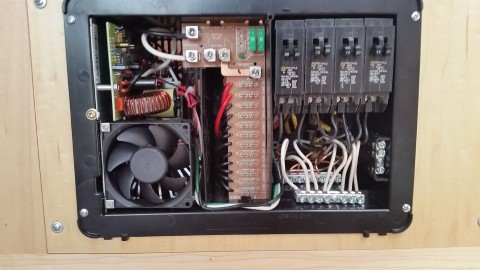

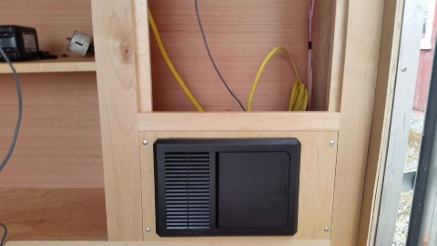

Postby RetchedOne » Mon Jun 29, 2015 10:28 am
Got the PD4045 mounted in and wired up.
Need to connect in the 12v Feed, cut off switch and circuit breaker.
Should be mounting the batteries ( 2 6v costco batteries) this week. Need to finish some brackets for them

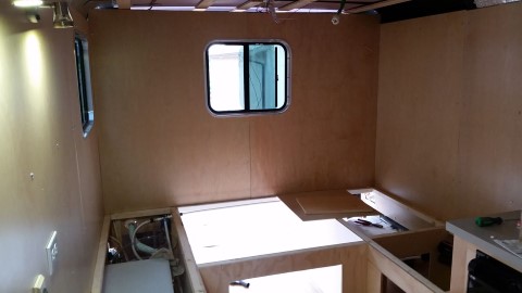

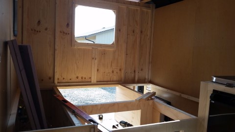

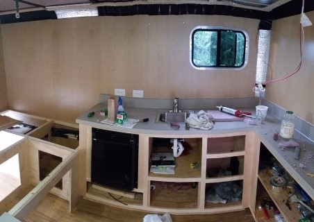

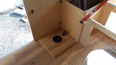

Postby RetchedOne » Tue Jul 07, 2015 8:42 am
Making good progress...
The bed/storage/rear wall are shaping up.
Electrical is in and working. Just need to trim out the lights after the ceiling panels are finished.
A/C is in and working!!!
Poop tank is permanently mounted and the "load" sensors installed.
Hoping to be done in 10 days for camping in 12 :)

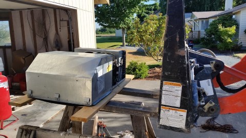

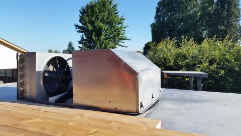

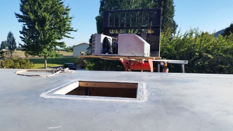

Postby RetchedOne » Tue Jul 07, 2015 8:45 am
AC is IN and cools down the trailer nicely, even without the ceiling/rear wall finished yet.
AC is a used Coleman Mach 3 13,500 BTU.
Runs on my Champion 3100 Inverter generator just fine, still quiet too, honda.. pft...
