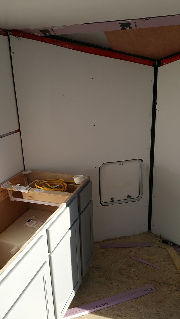

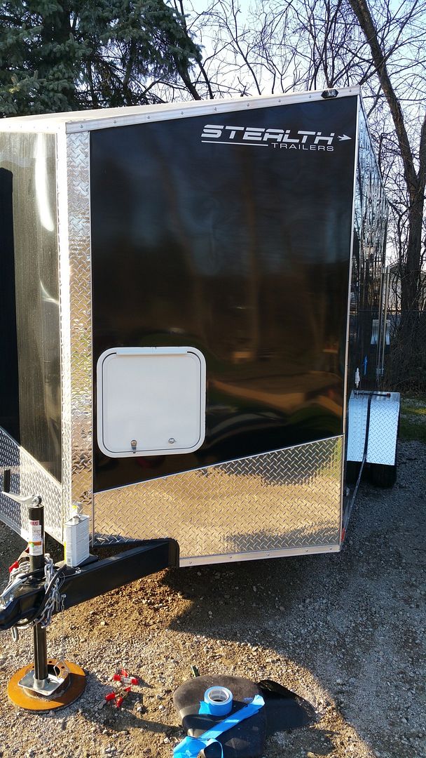

Well I did the thing I was scared of! Cut the hole for the AC Cargo hatch and installed it! Eventually I may spray it black to be more stealthy (I'd tape off the surrounding area). But that can wait.
On a side note...I seem to have misplaced the key for the lock on the hatch lol...luckily it's in the open position.

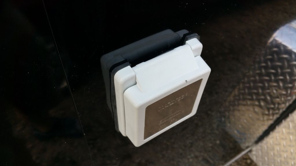

Postby Rocky5000100 » Fri Apr 17, 2015 8:40 pm

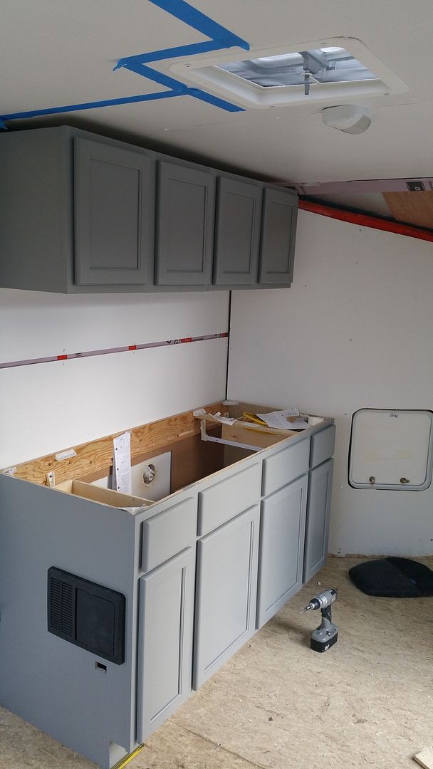

Got a lot done today!

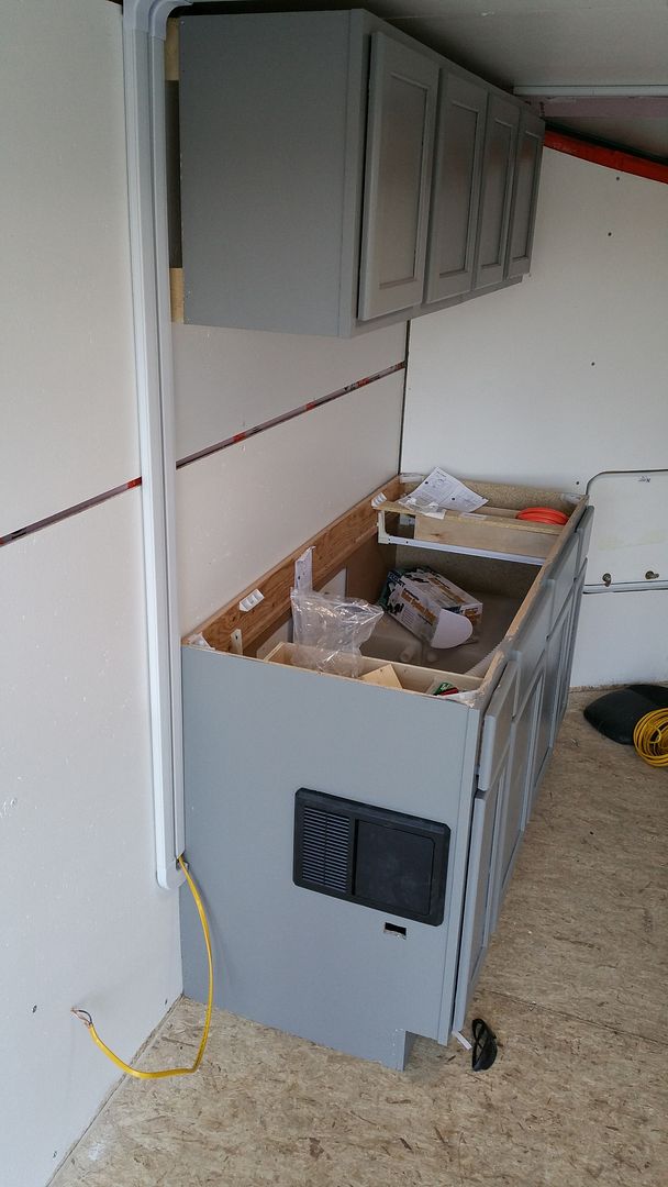

Installed upper cabinets. They're on there solid.

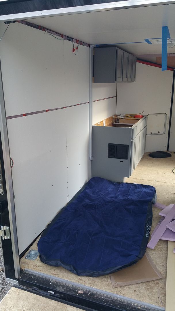

Also tested to see if my mattress will fit along the left side. It does .

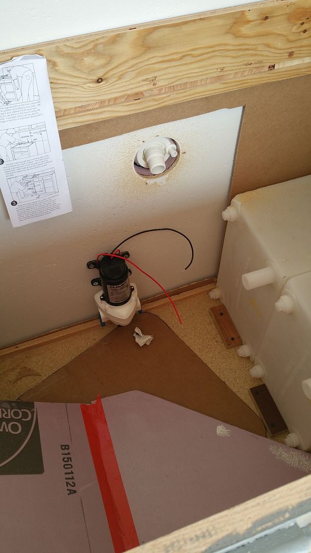

Mounted water pump, centered over a wall stud so it won't vibrate.

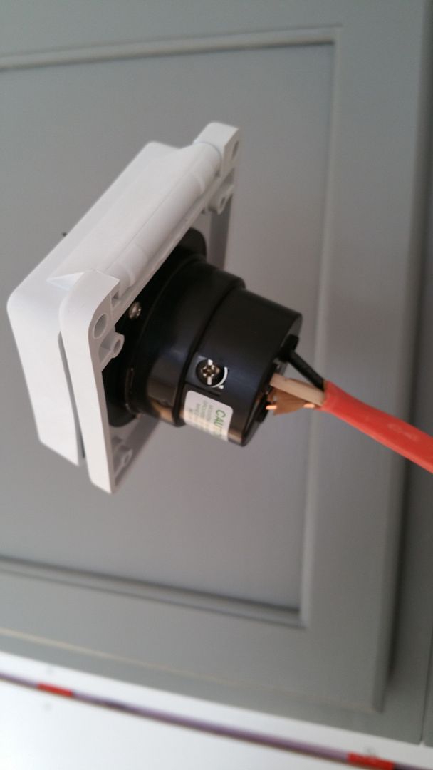

And lastly, got the 30 amp shore plug wired up with 10-2 and installed. Question though, is that seal they provided good enough, or should I used some of that sealant I got to make it more waterproof? There is a stress relief cover over the wires not shown in this pic.
Rocky5000100

Postby nunrleft » Fri Apr 17, 2015 10:49 pm
Rocky5000100 wrote:And lastly, got the 30 amp shore plug wired up with 10-2 and installed. Question though, is that seal they provided good enough, or should I used some of that sealant I got to make it more waterproof? There is a stress relief cover over the wires not shown in this pic.
I used the same shore power connector on my rig. I used a very thin coat of sealant on both sides of the gasket they supplied just to be safe.

Postby Rocky5000100 » Sat Apr 18, 2015 10:23 am
Cool. I'll do that once I verify I have power :D

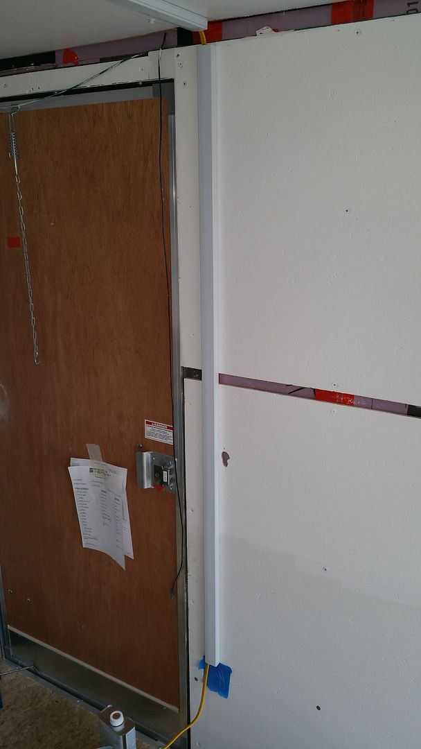

I got the conduit up today. Originally I was going to put in circular dome lights, but as I was putting the conduit up I decided it wouldn't look good. So I decided to order some LED Strip lighting, and will run a 3-4 ft strip and the front and back of the trailer. It was pretty cheap and will actually provide more lumens. I also don't have to cut into the ceiling now. I also ran the 12-2 wire for the outlet on the right side.

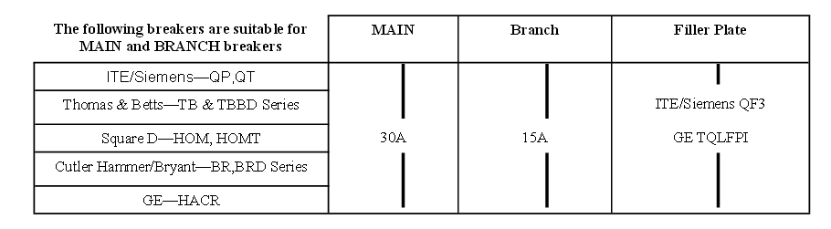

Also, what 30amp breaker do I want for my PD4045? I was at Menards and it looked like there was a bunch of different sizes. The manual lists some, but I didn't have it with me when I went to the store. Will this Siemens QP 30amp single pole work?
http://www.homedepot.com/p/Siemens-30-A ... /100025423
And from what I understand, I'll need 3 15amp breakers. 1 for charging the battery, 1 for my two left-side outlets, and 1 for my right-side outlet. These should work for that, right?
http://www.homedepot.com/p/Siemens-15-A ... mens+qp+15

According to what you've listed there, they should work fine. I would suggest a 20 amp breaker with 12 gauge wiring to the air conditioner outlet. It may not be needed, depending on the draw of the air conditioner, but I like to over-build things.

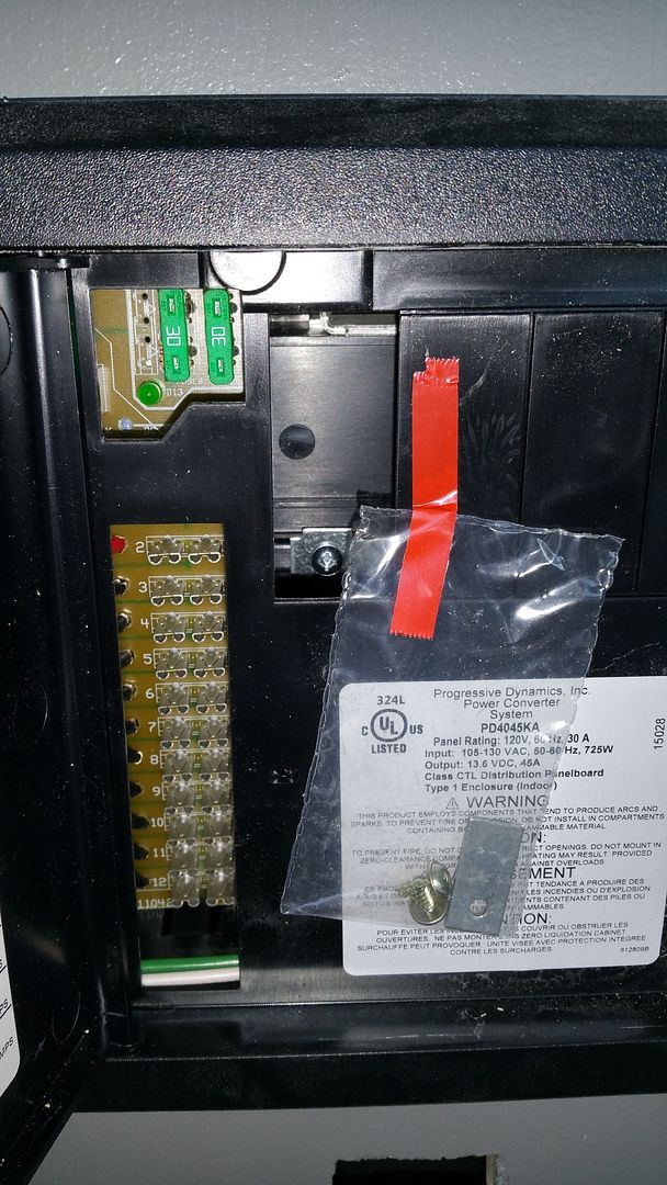

Re: Rocky5000100's 7x12 Toy Hauler Build
Postby Rocky5000100 » Sat Apr 25, 2015 6:54 pm

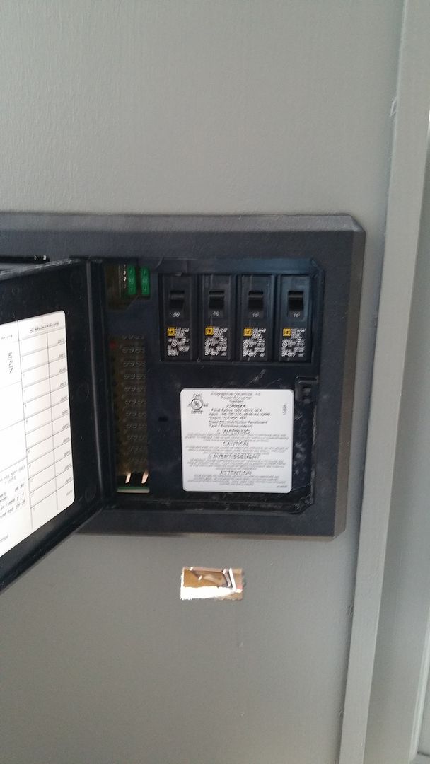

Thanks for the info. I got the breakers today and they fit up nicely. I went with 15 on the branch because my ac is only 5000btu. I think it only draws 4 amps.

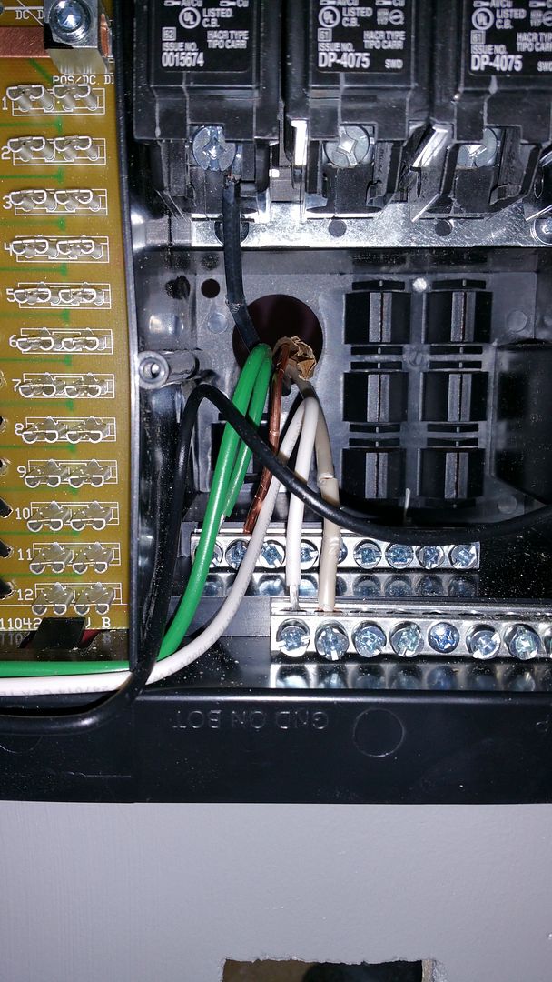

I then wired up the 30 amp inlet.
I then tried installing this surface mount box I got on the wall but it was too shallow to fit everything. So I am going to install a deeper one tomorrow.

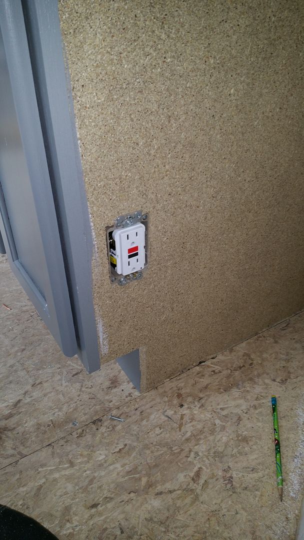

I did get the two boxes installed on each side of the lower cabinet, but not wired up yet.

Postby nunrleft » Sat Apr 25, 2015 11:34 pm
For your safety, please correct these issues before you power up the panel.
Arrows are pointing to damaged insulation. Circle is missing stress clamp. These issues are going to get real bad when the wiring gets jostled around going down the road.
