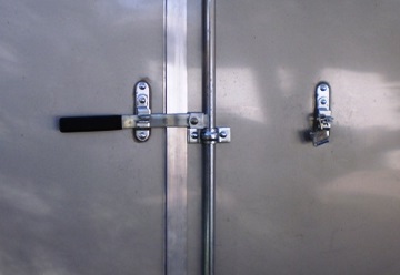

It looks like many of us had the same idea ... :lol: :lol:
Just added a second cam-lock and use the same lock to lock door latch open ... It keeps the jokers from locking the back door; I also added the RV side door... Doing great, keep up the good work :thumbsup:
