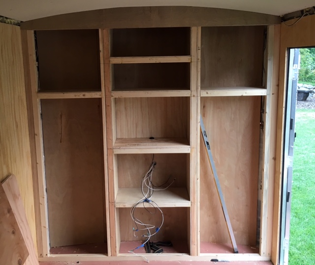

Complete interior of nose and begin cabinet layout.

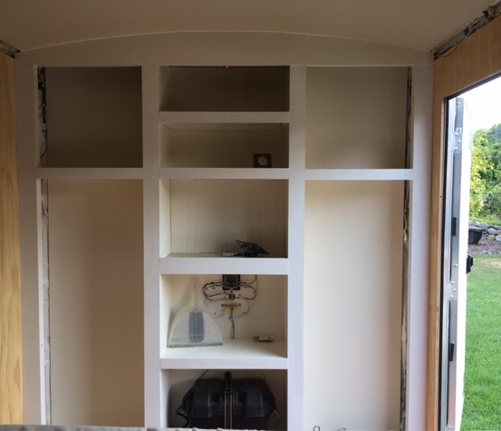

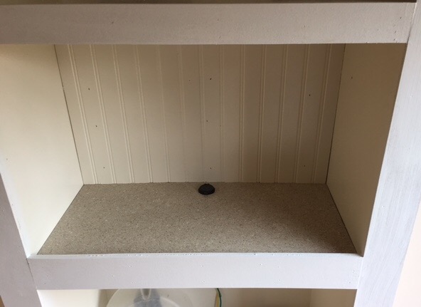

Nose cabinet built, only 11" deep. After the fact I was going to raise the left/right shelf up 6" but the glue already dried. Oh well. Prime, paint it then skin face frame. Center bead board portion has fuse box under it, usb on top, will get formica. Basically a place to throw keys, phone, bluetooth speaker, spare gun.

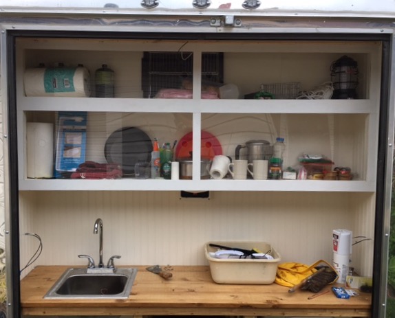

Kitchen ready to prime/paint, skin face frames. Going to install clear sliding doors on the upper cabinets. Need the track to establish skin height.

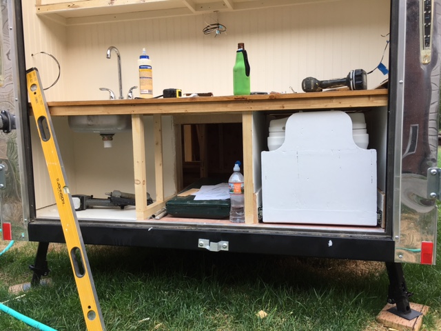

Windows came in mid week finally, install tomorrow morning when rested. Water tank, pump should be in end of week, which then allows me to install kitchen drawer frames.
Oh, and the ice chest drawe had epoxy fillet installed woth 6" wide, 6 oz fiberglass securing sides/bottom. That will get sealed this weekend. Hoping to take it out next weekend for citthroat fishing in the mountains.

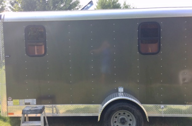

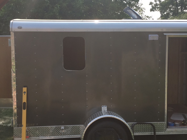

Windows installed today after waking up early taking the dog jogging.
Small windows are more of a pain to set than larger.

Postby flboy » Sat Aug 05, 2017 8:37 pm
The windows look great! Nice job.

Re: 6x12 build
Postby fourbtgait » Sat Aug 05, 2017 10:21 pm
flboy wrote:The windows look great! Nice job.
Thank you. Pity they dont make that width taller. But will provide enough cross ventilation especially with the fan on. The fan does cool the trailer off quickly in the evening. Thinking of adding a smaller openable one on the door as long as I can set it up so a person cannot reach in, unlock the trailer.

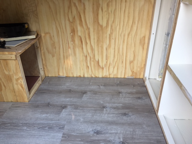

Flooring going in, an experiment. I was going to do glue down vinyl but happened to find snaplock vinyll planks at HD. If it works in trailer, might do house. The bamboo floors we have dont like dogs.

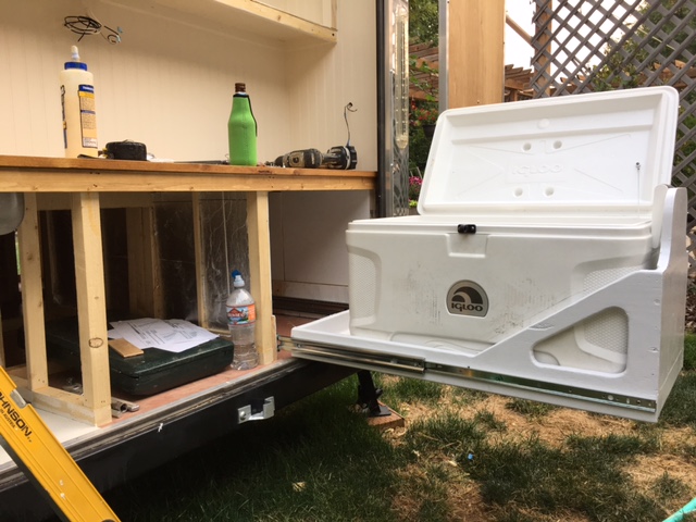

Postby fourbtgait » Tue Aug 08, 2017 9:29 pm
Major accomplishment.

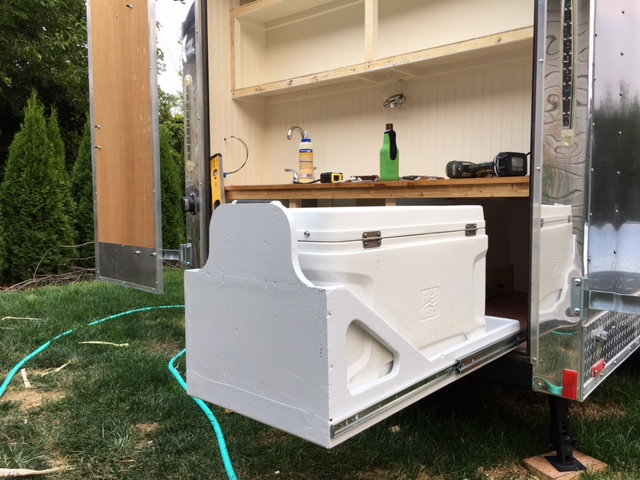

Ice chest drawer is in, fits and works.
One of the best items I put in the teardrop, carried over and improved here.
Set up with a 72 quart ice chest for food. Drinks will go in a separate one that sits outside. Drawer might fit a 100 quart, but thats to big.
Orr&Orr drawer slides, 37" extension, 250 pound capacity.
Ice chest completely full and the drawer are 115 pounds.
Cavity it slides into is also insulated.
Painted bead board drawer front will go on.

Kitchen upper cabinets faced, primed, sliding plexiglass doors in.

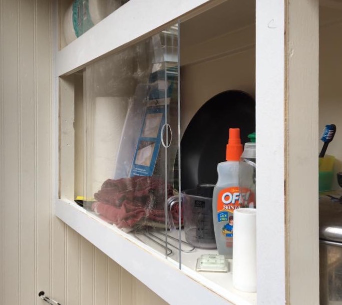

Thank you. It finally decided to rain today, first time in over 30 days, smoke from fires cleared out. I hope to final paint both today, put laminate on the dinette top. Install 2 switches in the kitchen. Paper towel holder on left wall by the sink, fire extinguisher on right wall. Then reinstall the flooring up front, put baseboard down. Clothes hooks and such.
We like the plexiglass sliding doors, allows quick viewing where things are.
fourbtgait

Postby featherliteCT1 » Sun Aug 13, 2017 12:58 pm
I really like the plexiglass idea!
How thick is it?
featherliteCT1
Posts: 1167
Location: Southern Indiana
Re: 6x12 build
Postby fourbtgait » Sun Aug 13, 2017 1:19 pm
Just under 1/8".
I used a 60 tooth carbide saw to cut it.
The track is Knape and Vogt found online. Its a plastic track, cuts easy with chop saw. Tite Bond glue and a brad nailer holds it in place though had to carefully use a nail set on the brads because of the depth of track.
I waited to face the cabinets to hide the track.
Between rain showers this morning I did get a finish coat of paint on upper kitchen and nose cabinets.

Postby featherliteCT1 » Sun Aug 13, 2017 1:50 pm
Thank you for the excellent explanation. Now I know what to buy and how to install it.
