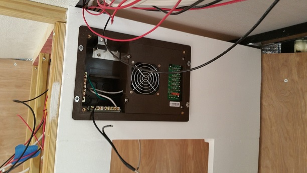

chiefairwrench wrote:I purchased WFCO ULTRA III Power Center Model WF-8735Pa for my trailer since I am using more shore power than battery after getting my lights and started my wiring I realize that the negative is not available. Does my light negative runs back to the battery or to the frame? I am pretty sure I am missing something here. Install booklet was no help :frightened:
Hey Chief,
I just realized that I may have the answer to the ground/neg. (DC) issue. I have a WFCO 8955, when you have the faceplate off on the left hand side at the 9 0'clock is the ground terminal bar, AC ground (bare copper or green), DC neg, (black) and chassis ground go here. At the 12 'ish is the neutral bar (AC white wires). DC hots (red) to the fuses, AC hots (black) to breakers. Right hand side at the top is neg. (black) from battery, and RH side bottom is positive (red) from battery.
I believe your model should be similar. You can use chassis as ground for DC, but as you know most common failures in DC are ground issues, so cant hurt to have redundant grounds, black wire from DC light or pump to chassis and then to ground bar in the power center.
I believe your model should be similar. Hope I got this info to you in time to help.
Good Luck!

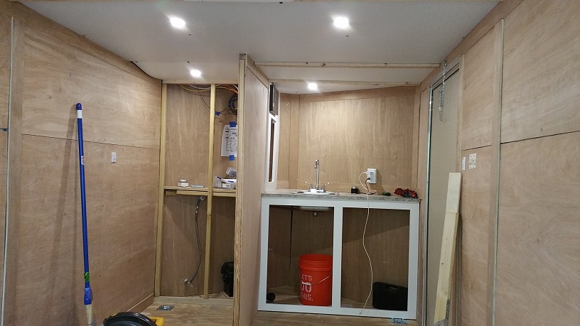

Postby chiefairwrench » Sun Apr 17, 2016 4:26 pm
Great I wired my lights today except for 2 not much to show for 2 days of work but I get to start painting my walls since I dont have to open them again. :) Picture is on the way

I was able to find some info on your WFCO 8735, not much, but enough to see it is a completely different animal from the WF 8955. I see that it comes with an attached pigtail for DC circuits ? Are they labled or is there a diagram inside the door or faceplate? The installation instructions that I was able to find are very vague, no wiring diagram or schematic. I apologize for misleading you on this, so as to the original issue they must intend for you to use chassis ground or a separate terminal block for DC neg. Seems odd that you would have to splice wires to circuits outside the converter box or maybe I am missing something. :?
Anyways, I hope I didn't lead you astray on this.

Postby chiefairwrench » Mon Apr 18, 2016 11:24 am
Yes they are label and instructions on the door and back was better than the booklet

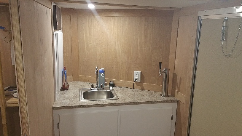

Postby chiefairwrench » Thu May 05, 2016 1:46 pm
Installed the rest of the plumbing, cabinet doors and tap :beer:
