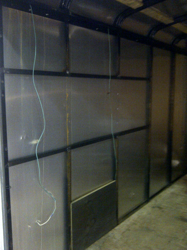

Postby GLSmitty » Sun Mar 11, 2012 4:01 pm
BC_Explorer wrote: Can you post some pics of the framing and welding you did around the windows.
I only took a few, 2 already posted and a couple more here. Hope that will help.....8892288921

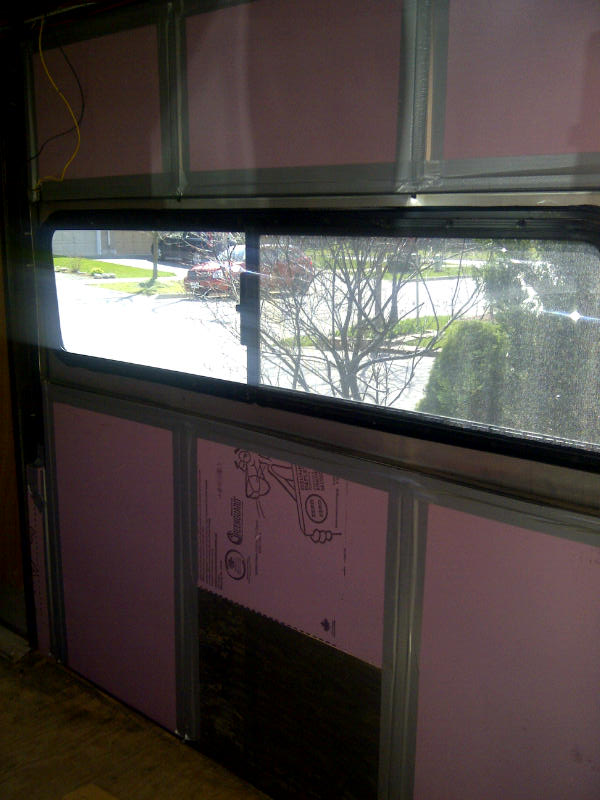

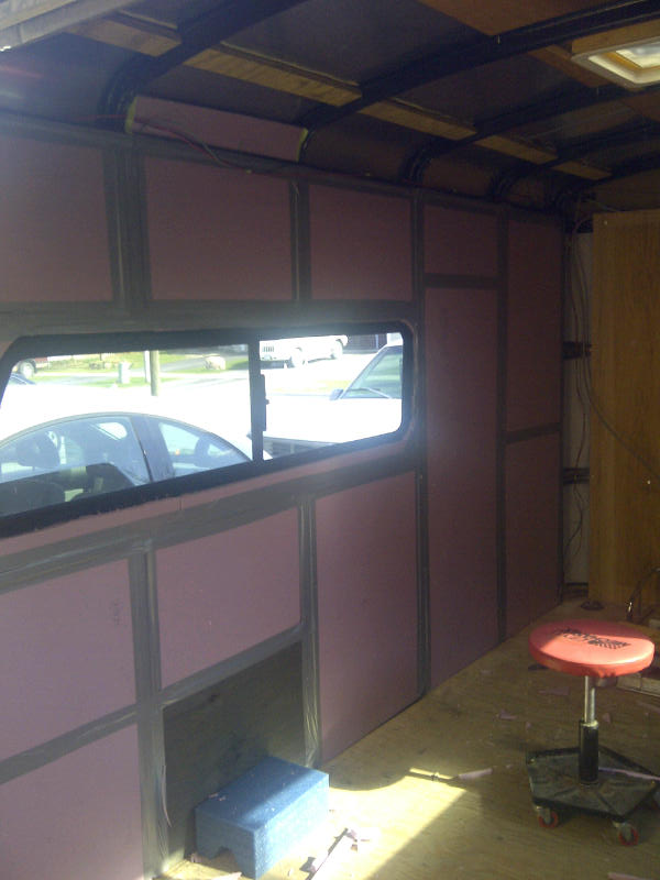

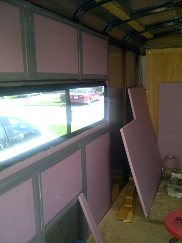

Postby GLSmitty » Sun Apr 01, 2012 6:34 pm
Well, the windows are in and now I have started the insulation and some wiring. Hoping to finish the insulation over the Easter weekend and get the wiring all done. Here are a few pic of the progress I am making, slow as it is.

Postby Treeview » Mon Apr 02, 2012 12:40 pm
Are you spray foaming the ribs/framing to reduce thermal bridging? If so...any pointers?
Maybe you're not even worrying about the issue though.

Postby GLSmitty » Mon Apr 02, 2012 6:55 pm
Treeview wrote:Are you spray foaming the ribs/framing to reduce thermal bridging? If so...any pointers?
No, not planning to, most of my camping will be done in the warmer weather, maybe spring and fall also but doubtful of any winter camping...
