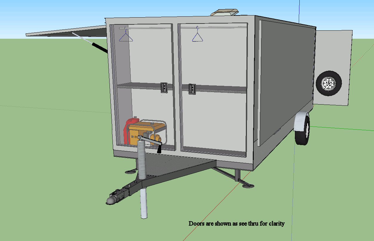

The Trailer
Flat top and flat front. Wind deflection will be on the tow vehicle.

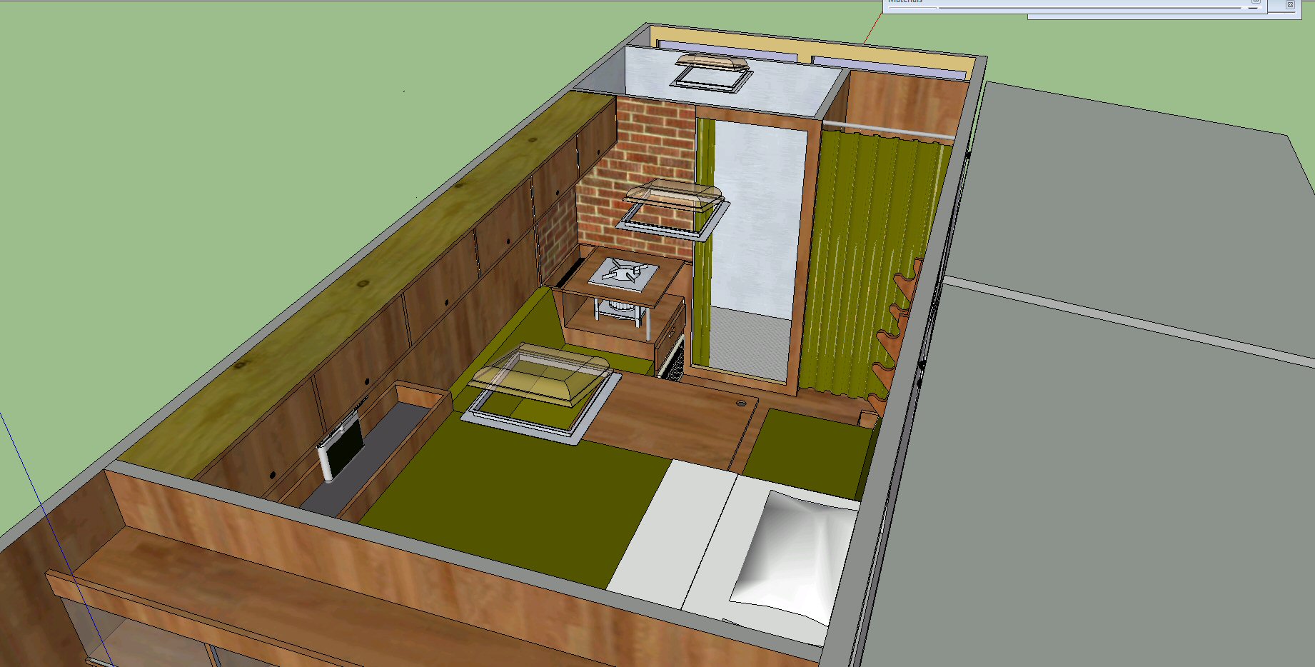

Custom built with one vertical slide window on the right rear and a door positioned 5’1” from the front corner to allow the interior space forward of that to enclose a front storage locker with 2 doors on the front and to the rear of the locker a 3’ x 5’ wet head and a curtained off closet.
The rest of the interior is laid out similar to a Gypsy Vardo with an athwart space queen sized bed and a lounge/dinette with slide out table. In the corner near the shower door is the interior stove above the window type air conditioner.
Under the bed there are several drawers for clothing and miscellaneous items and to the rear of the drawers under the bed is a storage locker accessed from the outside for storing hunting and fishing gear.

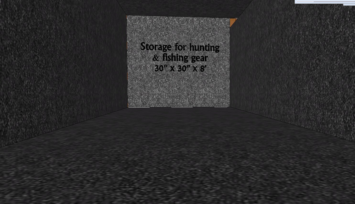

scene 3.jpg (224.82 KiB) Viewed 4377 times
Also under the bed is a 3’ x 5’ slide-out table. Best of both worlds…a lounge with two settee’s or a dinette/desk when needed.

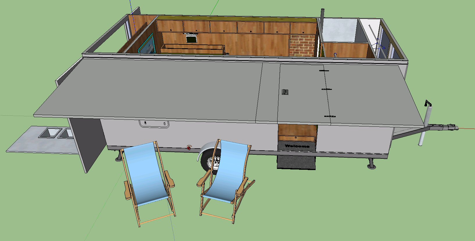

Awnings
Both sides of the trailer have sheet metal awnings that lift with support from pneumatic lift supports similar to what is found on larger SUV’s. Underneath each awning is foam insulation which gives them rigidity and cooler shade below. They also serve as extra security to keep out intruders while you’re away from the trailer. The left awning serves as a carport for the tow vehicle in case of a hail storm.
I can have both awnings built locally for the price of a single canvas RV awning.
Forward Lockers
The tongue of the trailer will have diamond plate standing place for accessing the locker doors. The upper section is for dry storage of hanging clothes etc. The lower section is for general storage and two deep cycle batteries in the center (mentioned above). The floor and shelf are both covered with charcoal indoor/outdoor carpet.

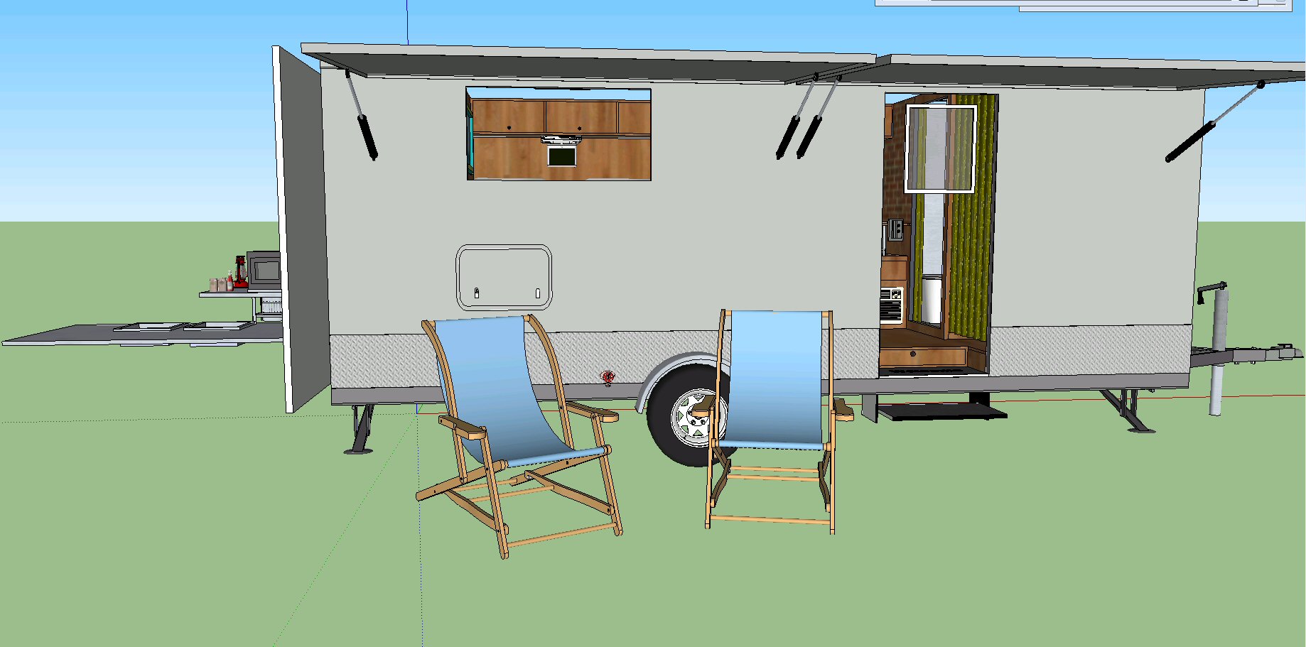

Here is another photo to clarify the end of my post.

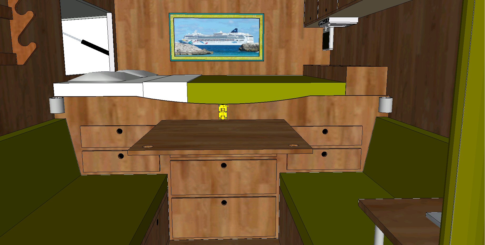

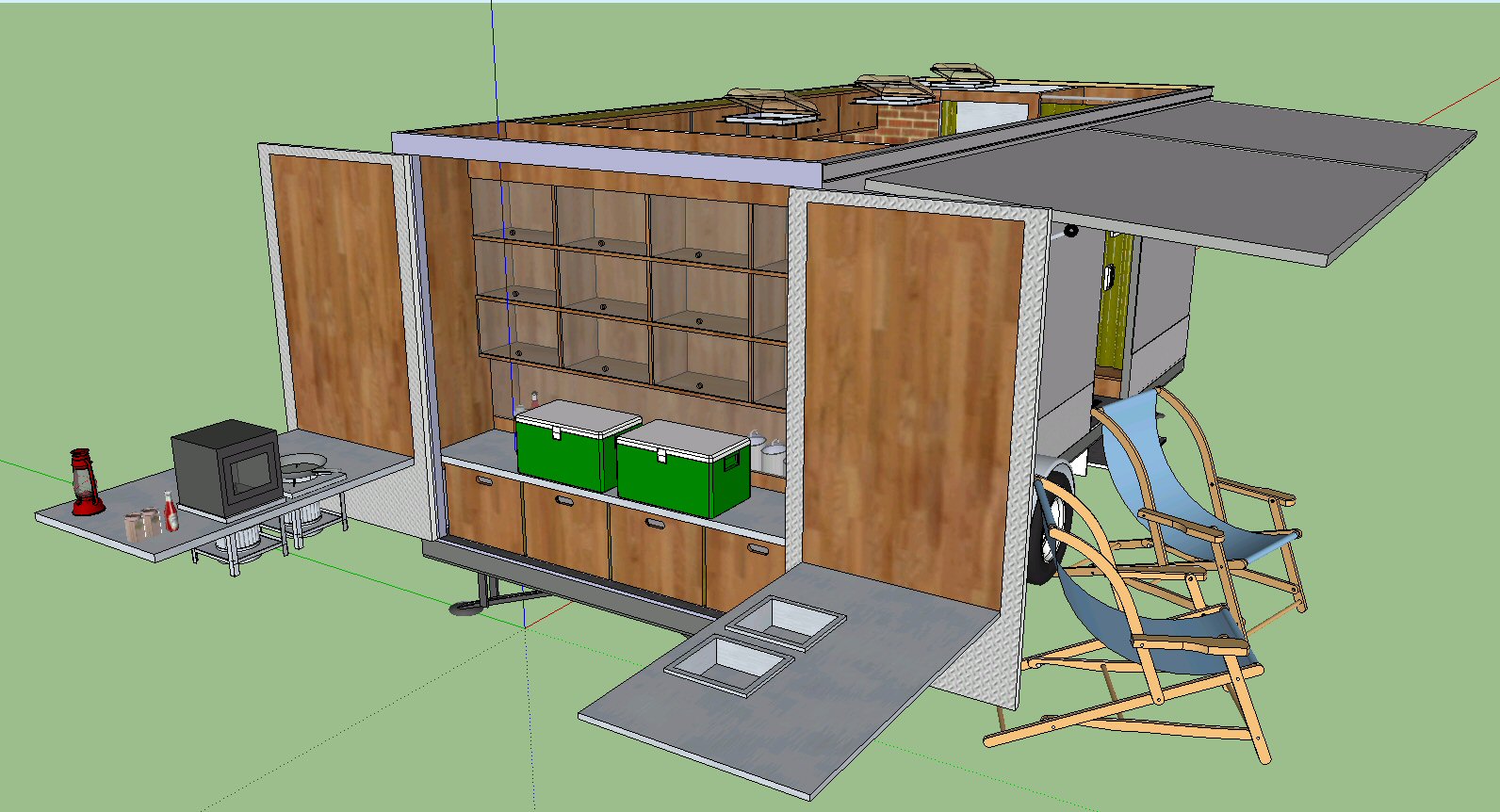

The Galley
My galley consists of only two fold down work tops with cut outs for two stoves on one side and two dish pans on the other.
In the middle is the pantry and prep area and beneath that are four very deep drawers for storage of camp gear. They're 5' long x 17" deep x four across.
Each cubby in the pantry has a lexan or plexi-glas door with spring hinges. At counter height is a wide bread box compartment 8" deep x full width for storing such things as silverware, dry goods, salt-n-pepper, ketchup and steak sauces etc. Basically just things that are used most frequently. In the bins below can be stored large items such as an extra wide pop-up canopy for erecting over the galley area in rainy weather. The general layout can be seen in the next photo.

Ironman, welcome aboard. Thanks for posting your design work.
You have some very interesting ideas. I'm in progress on a large trailer at the moment....haven't been posting much lately though. Hope you'll take my comments as constructive.
The cargo door cooking facility looks great. Most cargo trailers use wood framed rear doors and they might not handle the stress of cantilevered counters without twisting the framing, and that will eventually go downhill. There are fortunately some trailer manufacturers that frame the cargo doors with steel and use some serious hinges. You may have plans to support the counters from below and that might work too.
Plan for interior wheel boxes, all 8.5' wides will have them....didn't see anything in your design that would get in the way of their slight incursion into the interior....tandem axles with 20' long trailer.
One of your details that intrigues me is the hard-shell awnings, very nice. I really like the idea and haven't seen it before. It seems like you have them divided into two sections for ease of handling. I do have a concern with the forward section on the curb side. It will block your entry/egress from the trailer if it is in down position due to weather (high winds) or malicious mischief. How ya gonna get out if someone lets the awning down while you're snoozing? You could work with an entry door that opens inward, but that would be a custom set-up as all standard doors that I've seen open outward. A door opening inward might let you muscle the awning out of the way in an emergency. Maybe leave a gap for the door between the awnings, or move the entry door forward a bit and go with a single, longer awing on the curb side?
Consider a larger walk-in closet in the nose, interior access...might have to slightly rearrange the bath layout....so that you actually have dry storage of your hanging items and miscellaneous stuff. Batteries and genny could live on the tongue in a box. The seals on the nose doors would have to be pretty good to keep things dry and a standard trailer manufacturer might charge you a fair sum to put doors in the nose....that would probably be out of their normal range of options. I did see an Ebay ad a couple of years ago for a used landscaping trailer with nose doors though, so it's not impossible.
Food for thought. I'll try to keep up with your project. :beer:

Hi Blackstriper,
You're right...I plan on supporting the worktops from below. I haven't learned enough about "Sketchup" yet to use the "follow me" feature to show a squared up, u-shaped bent pipe.
I have the pipe bender in the real world though.
You have a point regarding the possibility of awning difficulty from bad weather or from mischief...I'll have to give that more thought.
As for waterproofing the front doors, I have drawn nautical style doors that cover over the openings since my past experience is with boats instead of trailers. Clothng stored up front would most probably be for seasonal items or clothing that is used only once in a while.
I started out thinking of this as a bug-out trailer rather than an RV. That's why the kerosene and bare electrical system.
I grew up down south sleeping in the summer by a window and with an attic fan going like jessie. It was very adequate and I can do it again if needs be.
With three fantastic fans I can open the one window from the bottom up and regulate the breeze coming from outdoors to my own comfort level.

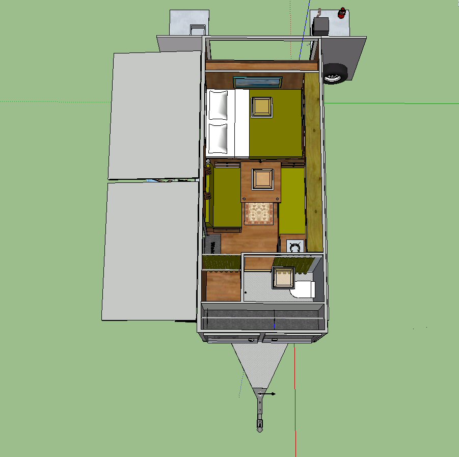

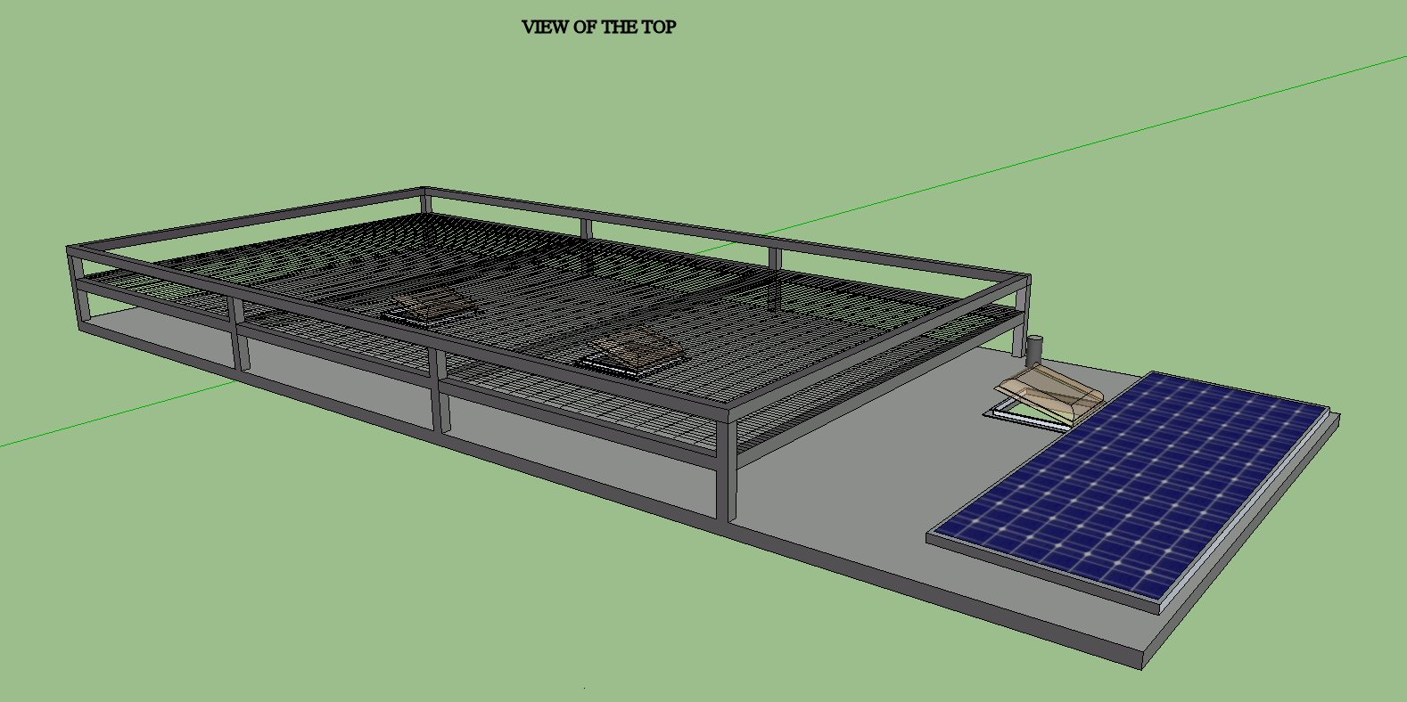

In order to maximize my options for using this trailer, I have added a large luggage platform to the top.
Someone talk me out of it...

Cool design. You might consider a tilt-able or movable solar unit. The sun is only straight up for a few hours. In winter, it never is straight up. It would also allow parking in the shade. If any part of the unit is not getting sun, it dramatically reduces power. We made a solar extension cable for a couple 2'x6' 65 watt amorphous units for which angle and shading are not as critical.
Led lighting is simple and doesn't wear down the battery. We use surplus 12v rv fixtures($3) and replaced the bulbs with leds. Makes finding the flashlights much easier :D Before we got the CT, we strung clear led xmas lights around the tents. An automotive jump box and a cheap converter powered them for a week.

You might also consider installing Maxxair vent covers on your roof vents that are not covered by the luggage rack. It will allow you to have roof ventilation when it is raining. They also allow you to keep the vent open when the CT is in storage. As you are probably aware of, a trailer with ventilation last longer than one without.

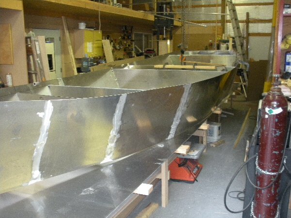

I am a Machinery Dealer and have all my own metalworking and woodworking equipment. My home shop is 30' x 50' and 2 stories tall.
I'll have to farm out the pressbrake work for the awnings because of the edge work needed but I recently had a lot of brake work done on a 25 ft aluminum sailboat I'm building and all in all it came to $140.00.
I have to finish the boat before I can start on the trailer.

FOR TRACKSTRIPER (SORRY ABOUT THE PREVIOUS SPELLING)
IN PONDERING YOUR THOUGHTS ABOUT ACCESS/EGRESS TO THE CABIN WITH THE AWING DOWN ETC, I DECIDED TO PLACE A DOOR THROUGH THE AWNING.
KINDA LIKE THE MAN DOORS IN AN AIRCRAFT HANGER'S LARGE DOOR.
