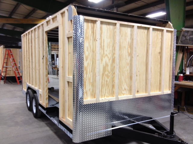

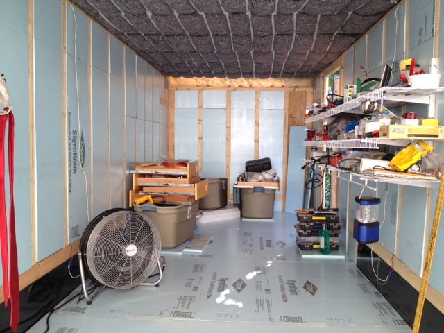

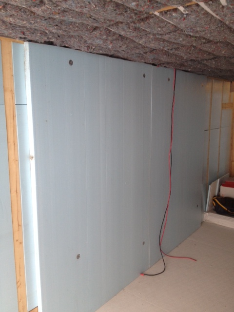

Postby OverTheTopCargoTrailer » Fri Sep 06, 2013 9:41 am
Here is how you build a foamie trailer :D :D :D
a wood wall pic.JPG (135.07 KiB) Viewed 5026 times
photo 1-2.JPG (141.46 KiB) Viewed 5026 times
double foam wall.JPG (99.53 KiB) Viewed 5026 times
JUST DONT ask what it costs :cry: :cry:
