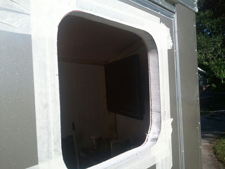

My door is foam with aluminum skin on either side. A sabre saw with a medium blade cut it like butter. Here's a pic of the hole before window installation.

Postby willfish4fud » Thu Jul 24, 2014 10:44 pm
AZKayaker wrote:My door is foam with aluminum skin on either side. A sabre saw with a medium blade cut it like butter. Here's a pic of the hole before window installation.
Thanks for that. Exactly what I was wondering about. Mine is skinned with wood on inside but am thinking it could be same inside. Unless its hollow/partially hollow???

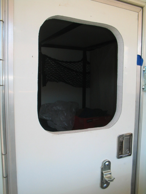

Postby willfish4fud » Wed Jul 30, 2014 6:18 pm
made the cut out in my door today and it is styrofoam filled like azkayaker photos. Cut smooth will jigsaw n metal blade

Postby willfish4fud » Wed Jul 30, 2014 9:00 pm
Foam cored door
pace 6x10 window in door.png (232.3 KiB) Viewed 3396 times

Postby AZKayaker » Wed Jul 30, 2014 10:45 pm
Sweet!

Postby willfish4fud » Thu Jul 31, 2014 7:55 am
Just FYI the service guy at the dealer told me that Styrofoam core is pretty much the standard these days and the only thing to watch out for regarding structural members is near the door lock
