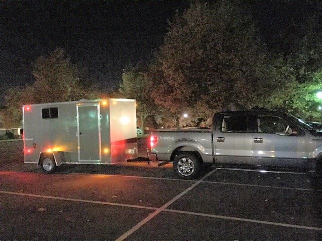

Postby abqlloyd » Wed Dec 10, 2014 10:38 pm
Forgot the mandatory picture.
I've been assembling an array of stuff for over a year. Some is from the old camper, some is new.
Think "really cool tent in wheels".
I'll post more pics tomorrow. It's 8:30 and just leaving work.

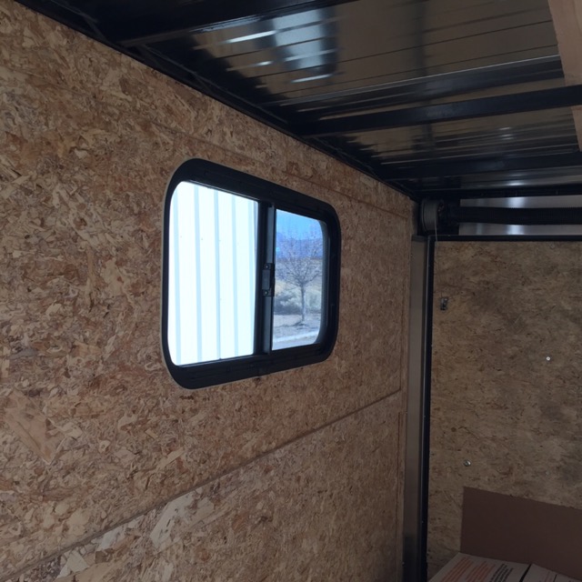

Postby lrrowe » Thu Dec 11, 2014 12:10 pm
Nice!
I especially like the TV.
I appreciate your posting as I am trying to decide on the window to buy for the door side. Yours is on the smaller size and high. I am wrestling with considering both of those options.
And the night picture looks sharp. I will have to do that also.
Bob

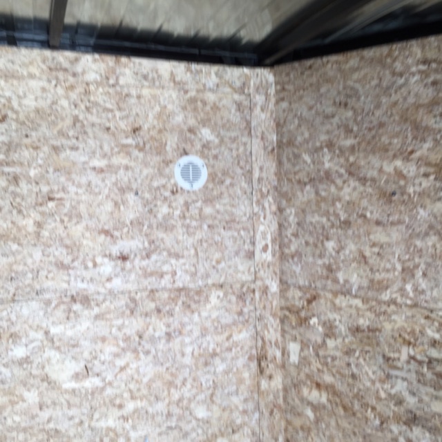

Postby abqlloyd » Thu Dec 11, 2014 6:21 pm
Some interior pics.
This is the new Drimax OSB. They ignored my request for plywood - special orders just upset them.
The panels are attached with screws and the trim is glued and stapled. When I went to pull the trim pieces I realize it's going to crack because the glue holds fast.
At this point I'm considering replacing the trim with 1/2" poplar and then filling the inset with 1/4" oak plywood. I don't have a source locally for the water-resistant OSB.

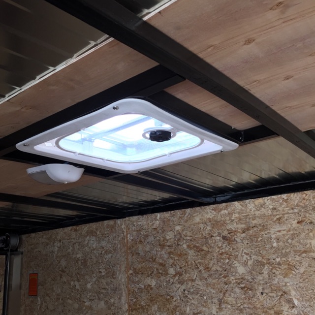

Postby abqlloyd » Thu Dec 11, 2014 6:26 pm
Some random questions:
They run the luan across the roof down the middle only. I'm thinking of adding two more strips down each side for additional roof rigidity. Any pros or cons?
I have XPS sheets of insulation. Lots of threads and tips and opinions on the best method. I wanted to spray but the supplier doesn't recommend unless I can get the temp up to 50F for 24 hours.
I talked with a guy who said NOT to glue the insulation - just set in place as tight as possible. Fill the gaps with non-expanding foam. Any thoughts? He felt the glue would just cause issues. In fact, he recommended thin furring strips to put a small air space between the skin and the XPS sheets.

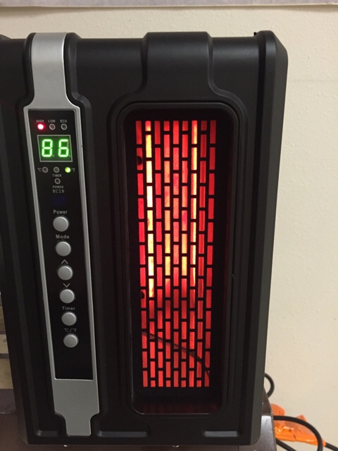

Postby abqlloyd » Thu Dec 11, 2014 10:34 pm
Infrared quartz heater. I like the compact size and the zero clearance on the sides. Only three inches clearance on back. I can set in a shelf not take up too much space.
abqlloyd
Posts: 273
Joined: Mon Aug 08, 2005 11:47 pm
