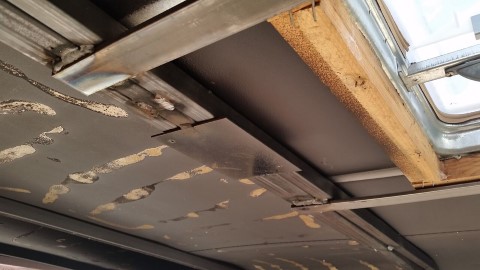

How are you guys bracing your roof for A/C install? Would I be ok with just adding 1" X 1" square tubing to box in the roof vent area? My a/c is a Coleman Mach 8 low profile and weighs around 90 lbs. This is how my roof beams are now.

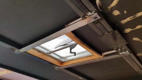

Postby wtcreaux » Wed May 06, 2015 9:52 am
Ordered mine beefed up from the factory........they doubled the transverse supports at the location (parallel to the originals, touching, welded together) then place the 2 short pieces perpendicular to make the vent space.

Postby nunrleft » Wed May 06, 2015 2:08 pm
wtcreaux wrote:Ordered mine beefed up from the factory........they doubled the transverse supports at the location (parallel to the originals, touching, welded together) then place the 2 short pieces perpendicular to make the vent space.
Ordered mine from the factory with the a/c support. It was done this same way.

Postby gisclair615 » Wed May 06, 2015 2:43 pm
Do you have any pics of the way it's done? I think I'm understanding how it's set up.

Postby nunrleft » Wed May 06, 2015 10:35 pm

Postby gisclair615 » Thu May 07, 2015 1:16 am
Thanks for the photo. I'll just copy this with 1" x 1" square tubing. Thanks!

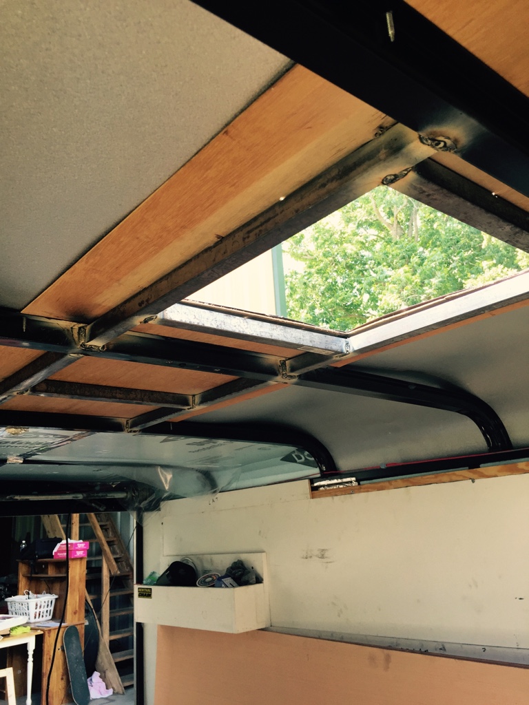

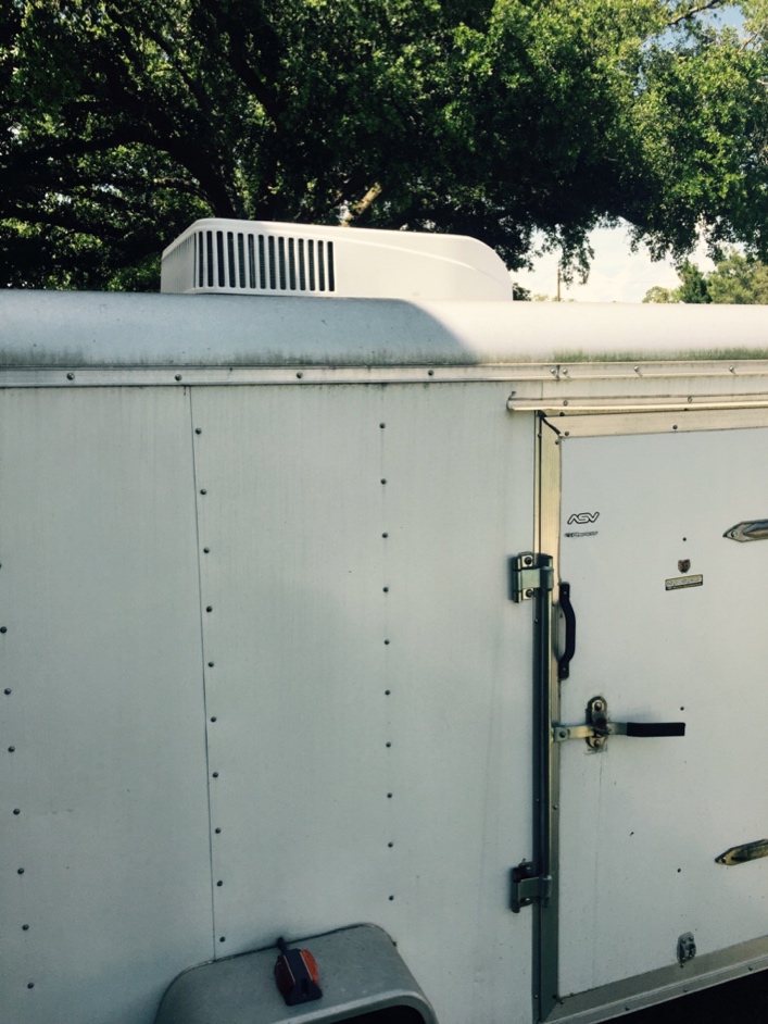

Postby gisclair615 » Wed May 20, 2015 8:03 pm
Got it braced and installed. Welded some 1" x 1" square tubing. It's very sturdy and strong

Postby gisclair615 » Wed May 20, 2015 8:04 pm
Trailer is due for a wash. It been sitting for a while.

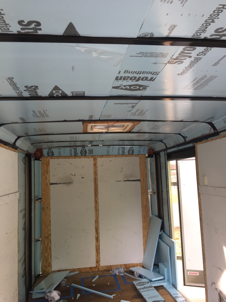

I'm really pleased with it. I didn't think it would cool as good as it does being mine is only. 9200BTU. I only insulated with 3/4 foam board and it's been high 80's and upper 90's with high humidity and it freezes my trailer out during the day. At night it's on low with thermostat halfway. I don't have an amp meter to measure amp draw but I have a off brand 3k generator inverter and it doesn't struggle at all to run the a/c and fridge. Install was very easy and straight forward.

Postby RetchedOne » Fri Jun 05, 2015 8:39 am
Welded in the 4 roof bows i bought online.
Pictures are deceiving, but I added two roof bows front and two behind the AC hole.
Used 1/4 inch flat bar to tie them together.
I can now do pullups on the bars and the roof doesn't move.
