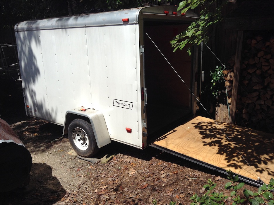

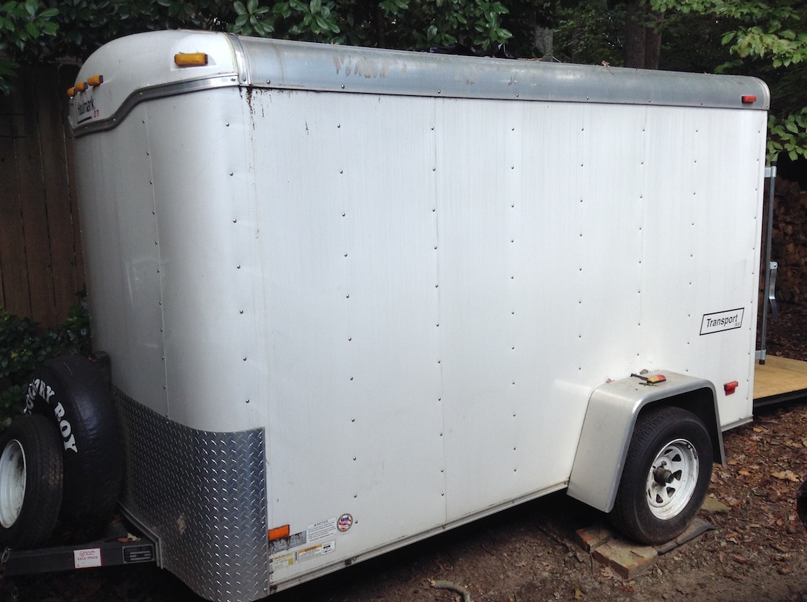

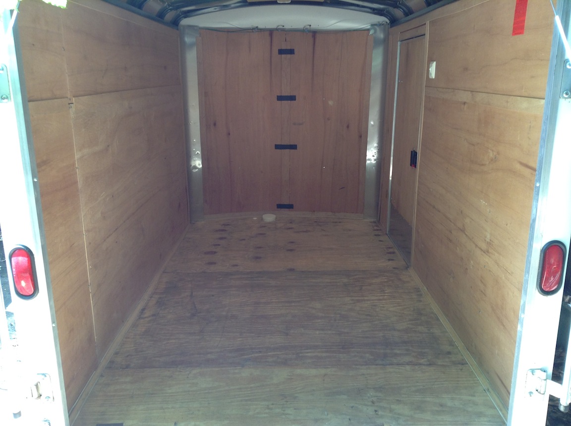

I am repurposing a 10x6 trailer for a conversion to a camper trailer. I have been using it for camping in for a couple of years now. After looking at all the wonderful ideas and projects on this forum I am ready to take this to the next level.
I know there is much info posted on here about this decision, but my first consideration is to stealth or not to stealth. Being stealth makes it easy to keep it simple and tidy. However, if I decide not to go stealth, it seems to open many more options.

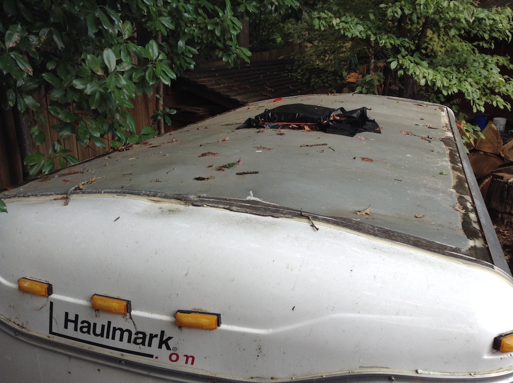

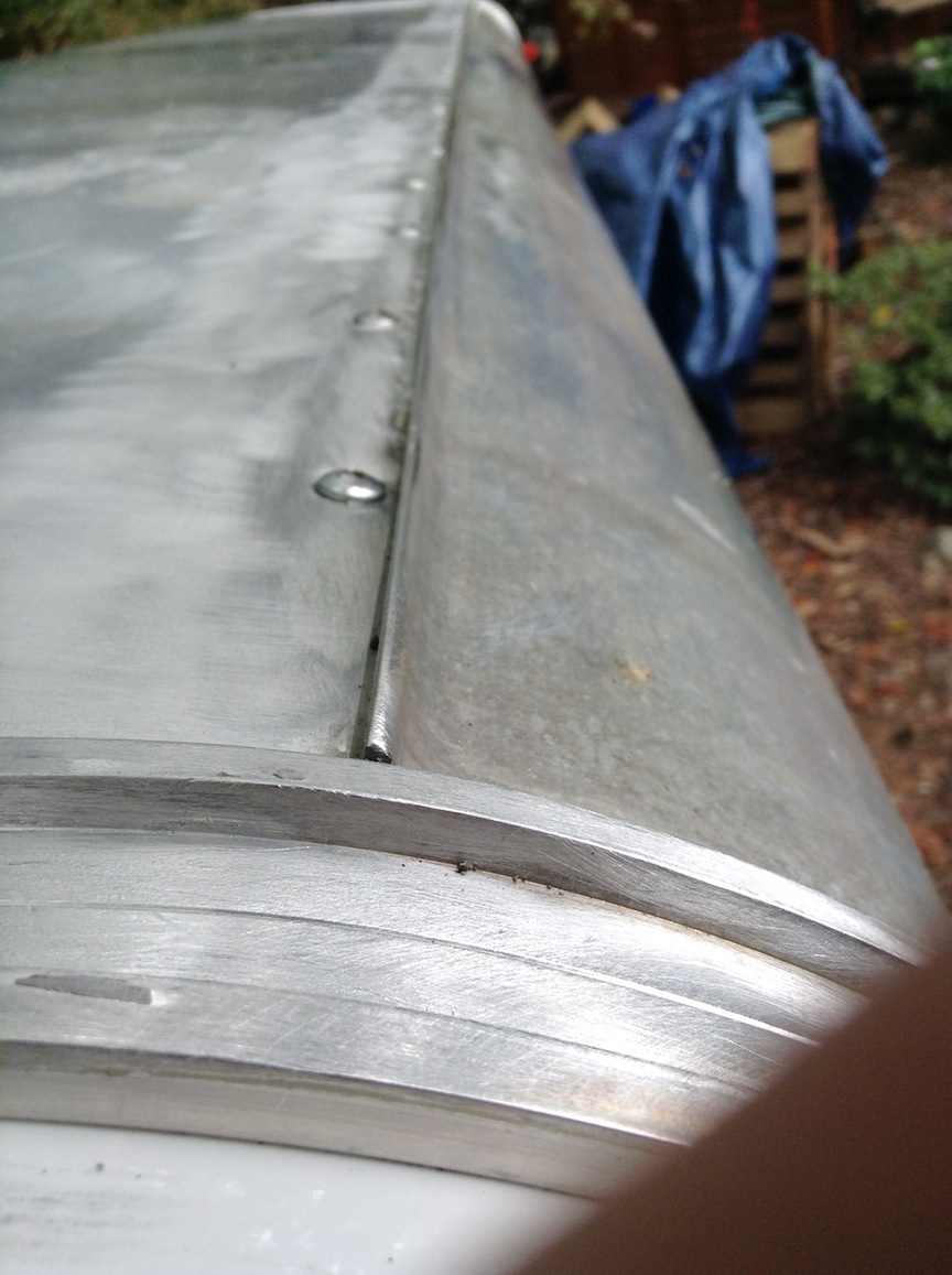

First things first…have a little maintenance to do. This thing has been sitting outside under trees fir years. Looking worn and sprung a few leaks. Spent the day getting the molded goo off the seams. Started with a scraper and chisel. Too labor intensive and not getting it all. Attached a wire brush wheel to my 1/2" drill and made short work of it. Nice clean surface to reseal to. Didn't have time to take pics, but will next week when back home.
Have seen a lot of opinions/info about what to reseal the seams with…just have to decide…
Also some surface rust on frame, etc.

Postby jegrosso » Mon Oct 12, 2015 4:02 pm
photo 2-3.JPG (199.18 KiB) Viewed 2616 times
photo 4-1.JPG (214.01 KiB) Viewed 2616 times
photo 1-3.JPG (229.06 KiB) Viewed 2616 times

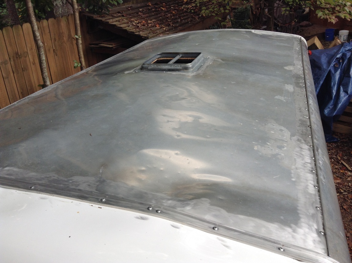

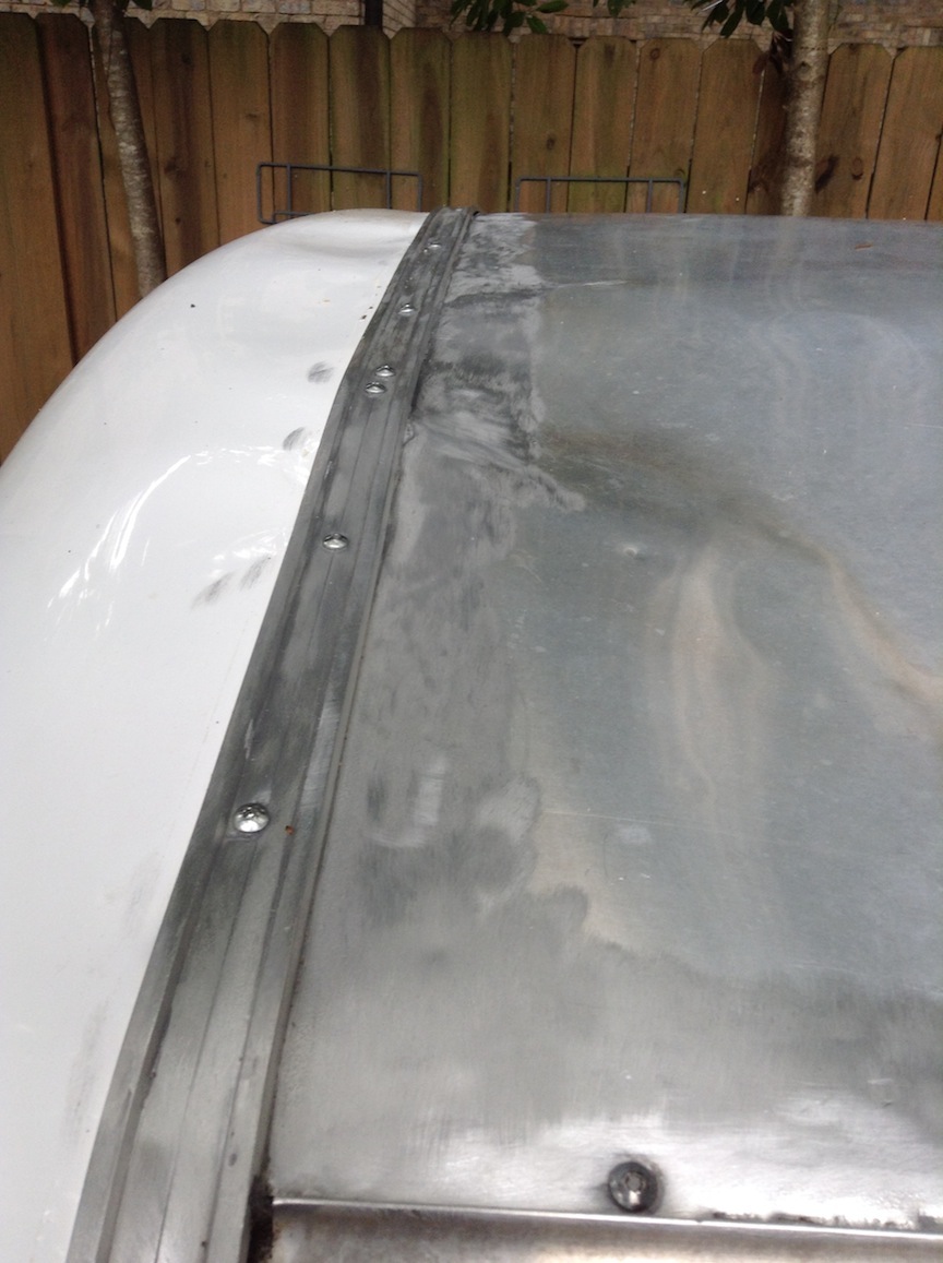

Was able to get all the seams clean with a drill and wire brush wheel. Have decided to go with 6 inch Permabond Alumibond. worried about it bridging the gaps and laying down over the ridges where the pieces of the roof meet. The guy at the roofing supply store seemed to think there would be no problem with it bridging the gaps as long as I applied good pressure to the tape while putting it down.
He seemed to think the tape was a way better solution than sealant…
JG

Postby jegrosso » Mon Oct 12, 2015 4:05 pm
Also, the aluminum roof is a little dented and bent up…no rust though. Planning on inserting 1/4" plywood on the interior between the aluminum roof and the bracing on the inside to straighten it out and support it a little.
JG
