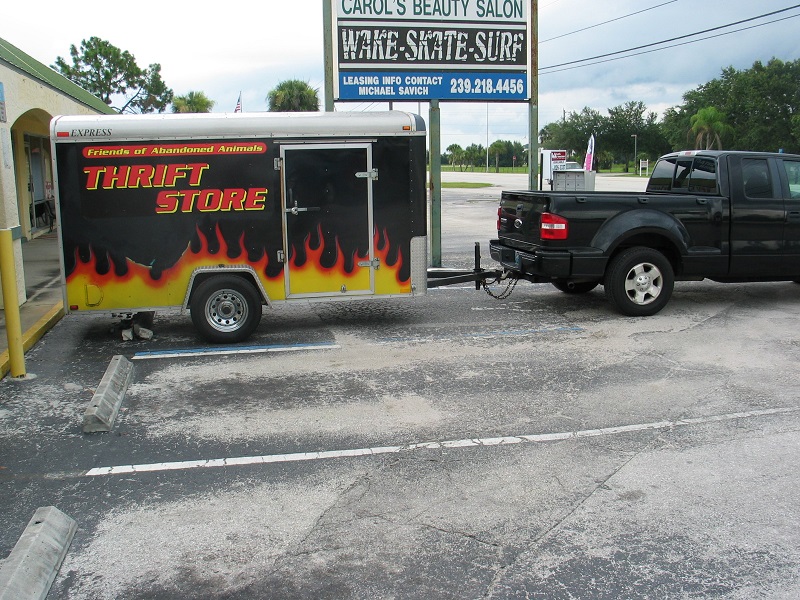

I've been lurking for a few weeks and decided today to take the plunge and do a conversion of my 6 x 12.
I already owned the trailer. We closed our thrift store and we kept it. It's been sitting around waiting for something to happen to it. It's a 2004 Express 6 x 12, with ramp rear door, single side door, a 3500 lb rated axle, and total (as manufactured) weight of 1380lbs. No brakes keeps the GVWR at 2990 lbs. Looks like I have 1600 lb to play with, but I'll try and keep it less than that.
Conversion Plans include shower and toilet in one room at the front, television, AC, twin width bunks for 2 in an L arrangement across the back and along "driver's side" side. A fridge, but no galley. Storage cabinets to fill in the empty space (Yeah, I know. What empty space?).
Usage is mostly urban, suburban. I'd use it on a 2 or 3 day road trips staying in parking lots or rest stops instead of motels, and maybe 3 or 4 day day trips to the FL Keys again staying in parking lots and such as to avoid motels. Probably not much boondocking or camping or KOAs.
