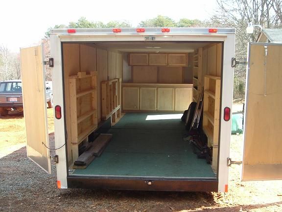

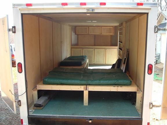

I am planning to put a Murphy bed in my CTC. I looked at some images of others and I really like this setup shown. Has anyone made a similar setup? Wondering about type of hinges, leg setup, mattress options, etc. I got this pic in a google search. It may be from someone in the group, if so NIce Job!!!

check out my build viewtopic.php?f=42&t=68016
if you need more info/pics, let me know

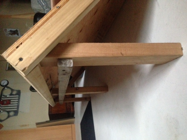

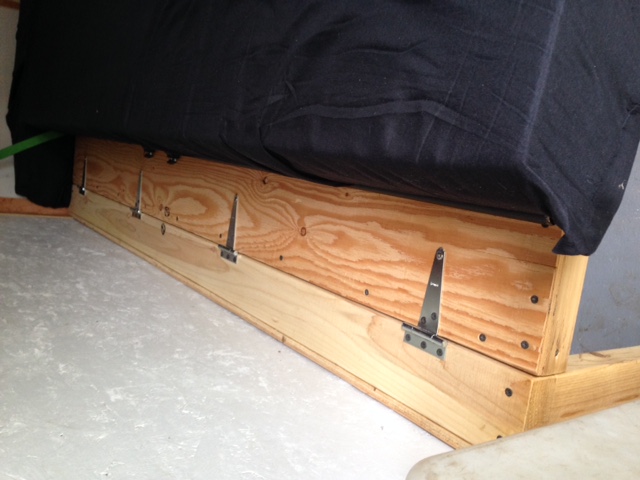

you can sort of see the type of hinges i used on the folding legs and i used 4 of the same hinges for each half of the bunk.
i used a 1x2 strap to keep the legs moving together so that they drop down evenly since they don't hang quite plumb because of the offset location of the hinges.
btw that was that exact same pic i used to design my bed, lol
hope this helps

Thanks. I am guessing you didn't use piano hinges from what I can see. My secondary concern is "locking" the legs so they don't fold up while the bed is being used. I also wouldn't mind if one side could be dropped and use for seating. Thanks again.

Postby onehoser » Wed Oct 04, 2017 9:08 am
a better shot of the hinges

Years ago I had a similar setup in a ford van. I spaced the first hinge further off the wall, so that the mattress pads could fit in the space when it was closed up. I used the same type of hinges seen in the photo. I never had a problem with the legs sliding out once the bed was down, but if that is a concern, a slide latch like this could be used to lock the legs in place.

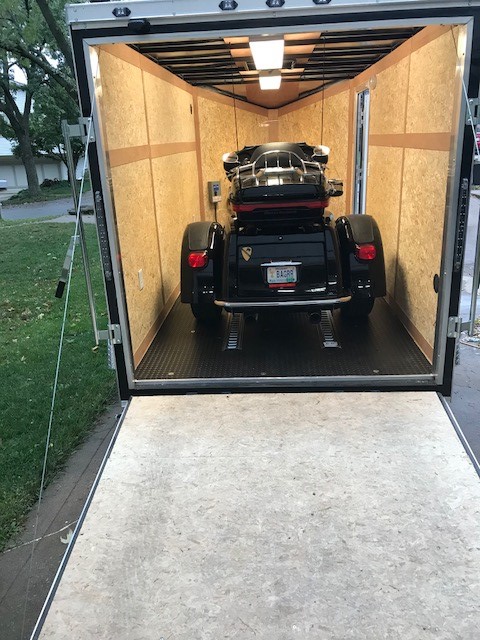

Very helpful replies, thanks. I only have about 4" of clearance with my Harley Tri-Glide loaded to work with. So, it can't be wider than a 2 x 4 when is up against the wall. Probably use a air mattress for the bed.

Tri-Glide fits pretty good with about 7" on each side. Looks like the Murphy Bed will work nicely. Also got E-Tracks installed. Getting there.
