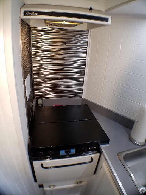

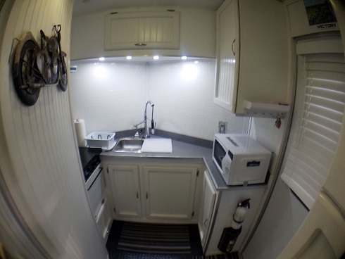

I think a good coat of countertop paint to seal and protect. The you can take either 3/4" or 1/2" aluminum channel (depending on plywood thickness) to trim and finish and protect the edges. Following are a few pics of mine in process and finished if it helps. Maybe hard to see, but the edges of the countertop are trimmed with aluminum channel. I used 3/4" plywood for this.

flboy wrote:I think a good coat of countertop paint to seal and protect. The you can take either 3/4" or 1/2" aluminum channel (depending on plywood thickness) to trim and finish and protect the edges. Following are a few pics of mine in process and finished if it helps. Maybe hard to see, but the edges of the countertop are trimmed with aluminum channel. I used 3/4" plywood for this.
I really like this. How did you attach the aluminum? Is there a paint called “countertop paint”?
Yes, there is countertop paint at HomeDepot or Lowes. It is an oil based acrylic paint. Water beads on it. You can see my sink and I get water all over it and no issues after 2 years. Seems very durable as well. It is called Rust-Oleum Countertop Coating and it is tintable to almost any color you want. I think it is meant to go over existing laminates, but I used directly on sanded furniture grade plywood. Use a Zinsser primer or Kilz primer first however and it will be fine.
I used liquid nails to glue the trim on, but it pressed on well to start with. You call also run a self taping screw in on the underside to hold. I did that while the Liquid Nail set up besides the fact I tend to overbuild. :-).
