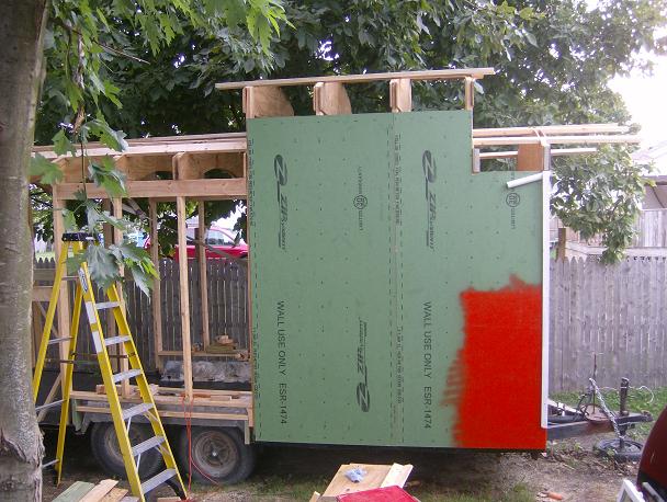

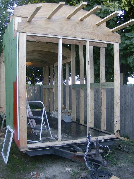

Well it's Monday again and despite the oppressive heat I was able to get a little bit done.
The couple hours between 7 am and 9:30 - 10:00 was able to get a dab done before the heat became unbearable.
Here are some new pics Image

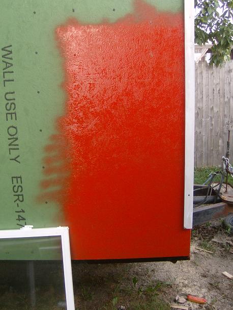

I like the Kabota orange It is a red orange that is kinda cheerful and looks great with the white trim!

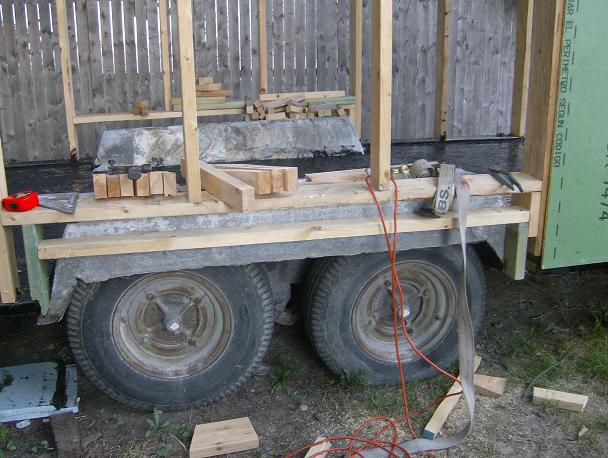

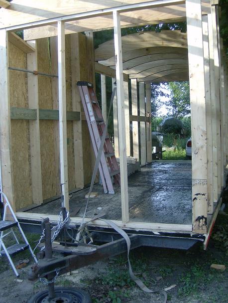

Talked about aligning the legs so the siding would fall correctly. Here is a cago strap pulling the header section into alignment so the second sheet would fall correctly. This shot gives a good feel about the barrelled ceiling :D

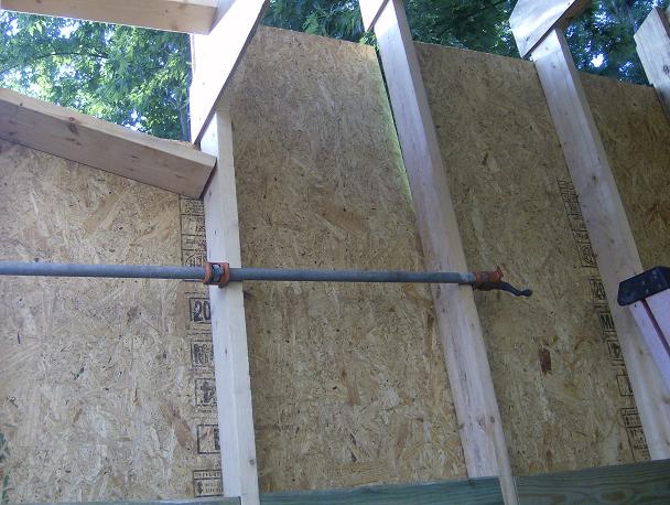

Had a bowed stud that wasn't falling at 2 foot on center so I used a bar clamp to pull it into alignment.
The wheel wells got some reinforcement and it also added a nailer for the siding. Need to black goop the whole mess yet.

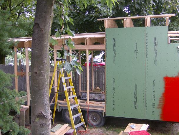

Here are the front and side shots. The cupalo and rear purlins are just laying in place and have not yet been installed.

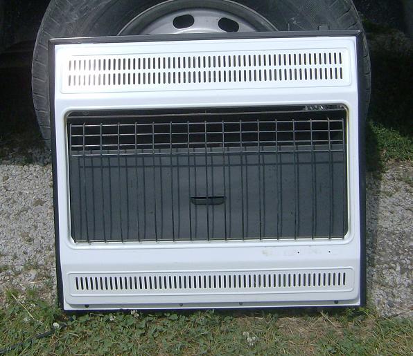

Yep an LP set up zero clearance fireplace at the neighbors about a block from the house for $75.00

That's almost Santa Fe Railroad Red. :D

Good deal on the heater too! Seems to be working quite well already :D

Yep went by the VFW in Crawfordsville (13 miles away) and their sign read 111 Degrees
Just imagine what it can do when I get it plumbed up to the gas.

What is that green board you are using for the exterior??
starleen2
5th Teardrop Club
Posts: 16272
Location: Pea Ridge ,AR
Re: Bob's caboose build
Postby bobhenry » Tue Jul 10, 2012 6:58 am
This is a fiber glass faced osb called zip panel. It is great stuff I have used it for the 4x7 and the chuckwagon. I have a few chunks of it that have been laying about in the yard for almost a year with NO degradation or swelling. It is guaranteed stable for up to 6 months uncovered on a construction site.
http://www.zipsystem.com/zip-system/wall.aspx

Postby mezmo » Wed Jul 11, 2012 1:39 am
Hi Bob,
Ah, Zip Panels. I was wondering what you were going to use for wall
shear,so that answers that. Will their surface be strong enough/OK as a long
term exterior finish? [Since it is sold as sheathing and not as an exterior finish,
will exterior paint be enough for that and UV protection or do you need an
exterior siding over it?]
'Fun to watch the progress on the 'Bagoose'.
[My nickname for it, which was what a cousin used to
call cabooses when she was a toddler.]
Cheers,
Norm/mezmo
mezmo
Posts: 1817
Images: 194
Location: Columbia, SC
Postby bobhenry » Wed Jul 11, 2012 6:54 am
The very old caboose (es) or is it caboose 'I either way they were board and batten I will install 1x2 battens at 12" on center and am praying that the equipment enamel will be enough protection for the long term.
