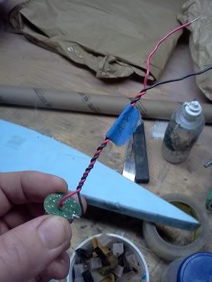

I Became the mad scientist this weekend and experimented . I took 3 of my 4.5 volt 99 cent led flashlights and hooked them in parallel to see if they would work with the 12 volt power circuit and yes they did ! :thumbsup:

bobhenry wrote:I took 3 of my 4.5 volt 99 cent led flashlights and hooked them in parallel to see if they would work with the 12 volt power circuit and yes they did !
That's good to know. I use the same type for work and get a few months out of them before they die. I hit the circuit board with a heat gun and that seems to fix the cold solders and then solder leads on in place of the battery terms. I want to use them for under-cabinet and maybe courtesy lighting but was going to solder in a 1/4W resistor when I figure out a housing (prob a piece of pvc conduit).
I'll have to check it out and see if mine will take 12V too. Thx Bob !

I wanted them for low light courtesy lighting as well. I want to install 12 of them in banks of 3 each. I added 28" of lead to each of the trios of lights as a hot feed and a 28" lead for the grounds, soldered direct to the housing. I have not tried yet but am sure a pvc tube can be fitted and hot glued into the remaining head of the flashlight and inserted into a snug hole drilled into my inside soffit. The banks of 3 will be installed exactly 24" on center between each truss bay. These trios will be over the sofa, the bath tub, in the potty area and near the side door ( probably in a slightly different configuration). They will be all but totally stealth. I was able to score 4 goose neck desk lamps at Goodwill last week for 3.75 each and will be mounting the chrome necks only as adjustable wall sconces for much brighter reading and task lighting. I am not sure at this time if they will remain 120V AC or if I will opt up for a ,currently rather expensive, 12 volt standard base LED bulb.

So you're wiring banks of three in series instead of a dropping resistor ?
Makes sense.

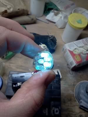

I've taken the arrays right out of the housing - that's the part I'll glue right into the PVC:
This one had 3 dead lamps in it that resoldering didn't fix, so I figured I'd hit it with 12V. I don't want to use it as it is and it's not really worth separating the LEDs given how cheap they are individually.
Needless to say, it wasn't too tolerant of 12V.
On 6V:
I lucked into some waterproof LED lights intended for decks and steps. All that seems to be missing out of the box are the 110-12V transformer and some connectors (none of which I need anyway), so for $10 in the clearance bin at the hardware store, I couldn't go wrong. I'll mount them on the trailer's rocker panels so they illuminate the ground around it. They install by drilling a 1" round hole - easy peasy.

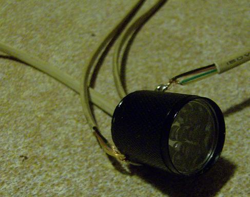

Up extra early before work so I went out into the snow and rescued my camera from the truck. It didn't like being left in the cold and was fogging up a bit when I took this picture of the lights lit up in this one. The pic was taken in total darkness without a flash!

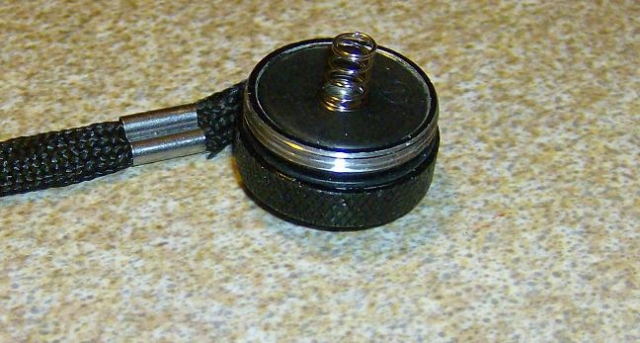

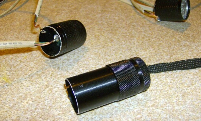

Here is the little LED flashlight sawn into pieces

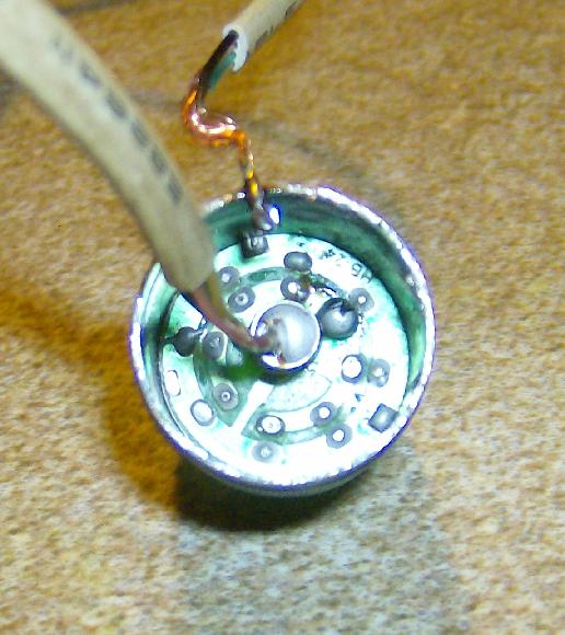

here is the hot wire souldered to the center terminal and the ground souldered to the case
Here is a one of the 3 lights wired with 2 hot feeds and 2 grounds one of each was input the other was pass thru to the next light
I have parts left over so I may used the push on push off switch to break the ground to shut off the lights.
So it sounds like they ARE wired in parallel, so each light sees 12V ?
Mine burned out instantly when I tried that.
I like the extension cord for wire: waste not, want not !

It's worse than that look again !
red. yellow. green .and black
it's phone cable.
I was looking for some light weight stranded so I stripped all 4 and twisted them together just for the experiment.

Hehe...I was wondering: in the second pic it looks like the hot is solid wire...
